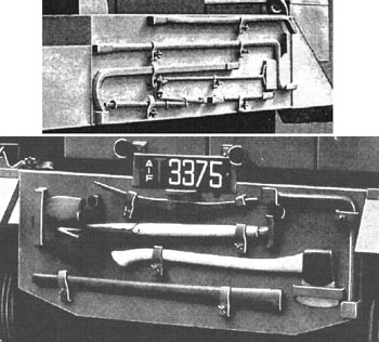

Hi Ron
As promised. These are images of the famous #3375 from the 1942 Manual. Best quality reproduction I have at this time.

Old 19-07-06, 12:18
ron ron is offline
Posts: 1,294
Default tool plate setup
Hi bob,
Many thanks for the post of the tool setup, it is just what I need and will be a great help.As discussed my carrier is a Vic rail number 595,
Thanks again for your help,
Regards, Ron
