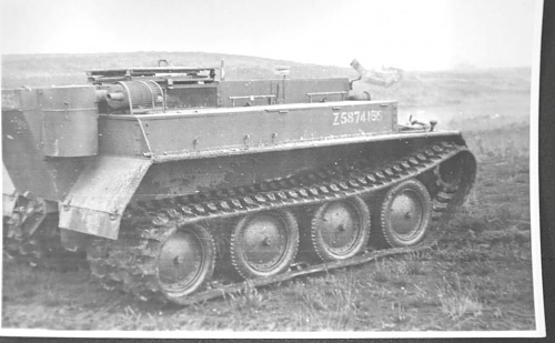

The Canadian Armoured Snowmobile Mk.1 a Tracked 15-cwt truck? Hmm, makes sense, in a way.
Attached goes a pic of runner-up Z5874162 on test at the WVEE in Britain (source: Fletcher, The Universal Tank)

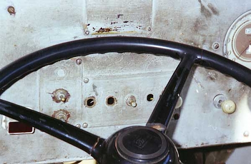

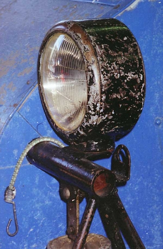

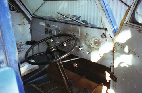

Lars Ulvestad Lars Ulvestad is offline
Location: Lillehammer, Norway
Posts: 88
Post
Left headlamp (as on CMP cab 11/12) with bracket for the side lamp:

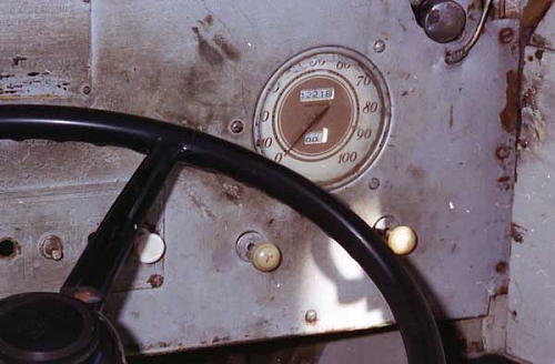

Part of the instrument panel:
Part of the instrument panel II:
Part of the instrument panel III:
Instrument panel IV:
Lars
Old 20-09-04, 03:13
Default Ford parts?
Are these Ford V8 powered? Aw heck, now I'm going to have to find one of these!
The steering wheel is from a 1938/39 Ford truck and the steering column is from 1937/38/39 column shift 1/2 ton truck. The speedo is from a 37/38 truck and of course the brass plates the switches are on are from a Ford CMP.
My guess is that Mr Bombardier cannabalised a 1938 or 39 truck to build these, but the engine number is very similar to the sequence for a 239in mercury engine, so perhaps he obtained his components from the Ford factory?

Tony, that's a Canadian Mercury 1942 engine number, and rhd version surely? Similar to a CMP? I wonder if M. Bombardier bought a job lot of components from Ford of Canada from 1937-8 and used them up over the years? Fords always did have the edge at least post-war on supplying components for companies, and still do. In England Fords sold from about 1948 refurbished V-8s that were rebuilt by Lincoln Cars Limited, for all manner of purposes. Then they offered the V-8 Pilot engine, and finally from 1953 the Consul/Zephyr 4 and 6 engines. Business expanded so much that Ford Industrial Engines moved from Dagenham to a 'hole in the wall' at Lincoln Cars.

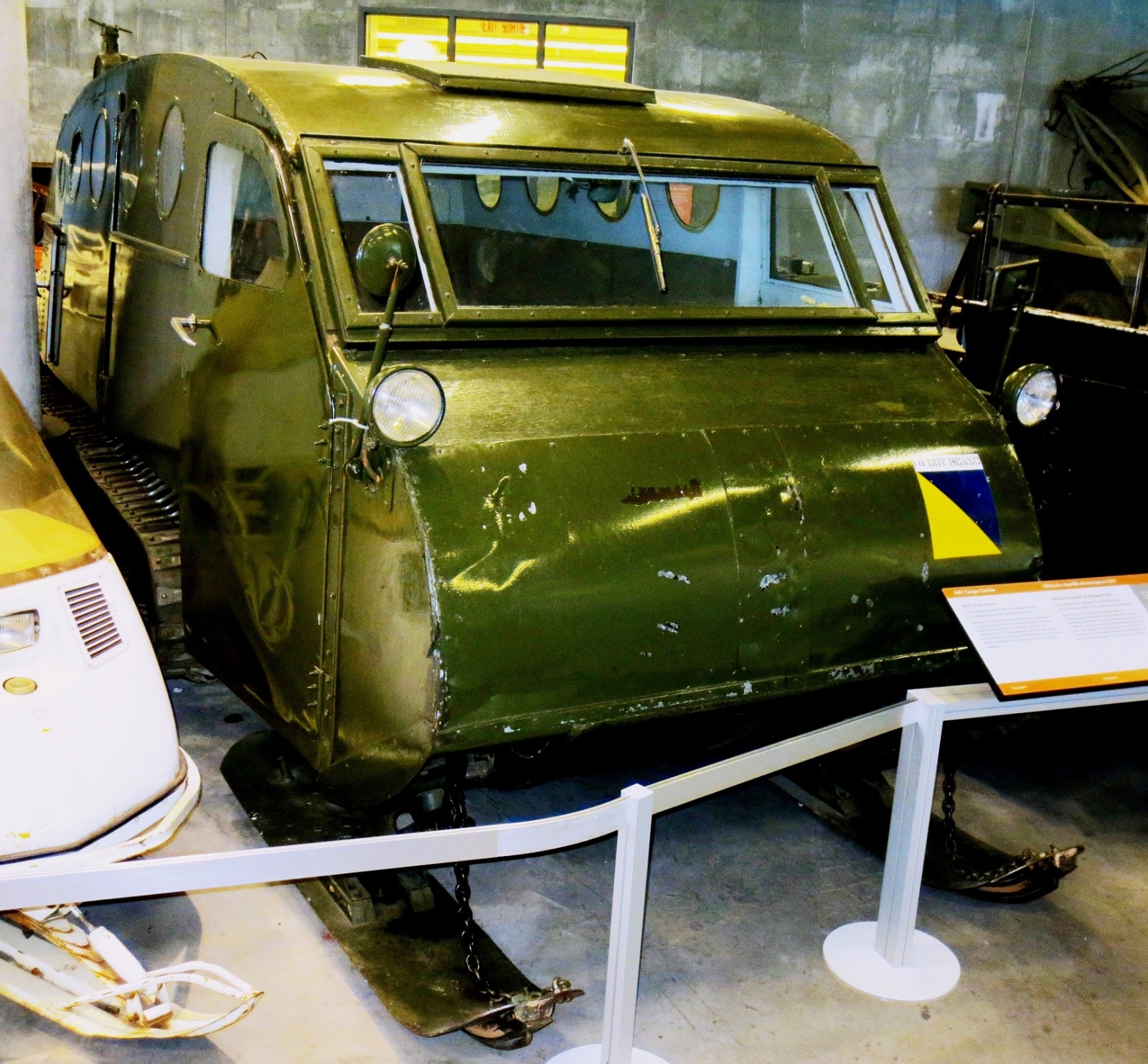

Old 03-01-21, 13:06
The CWM has a Bombardier Snowmobile on display, though it is not listed on their site https://www.warmuseum.ca/collections/
The attached picture comes from http://silverhawkauthor.com/tanks-an...rt-ii_989.html where it is incorrectly captioned as a "Bombardier Penguin Mk III Armoured Snowmobile, 1943."
Name:	Bombardier-Penguin-Mk-III-Armoured-Snowmobile--1943--Canadian-War-Museum-11-Aug---90-_resized.jpg
