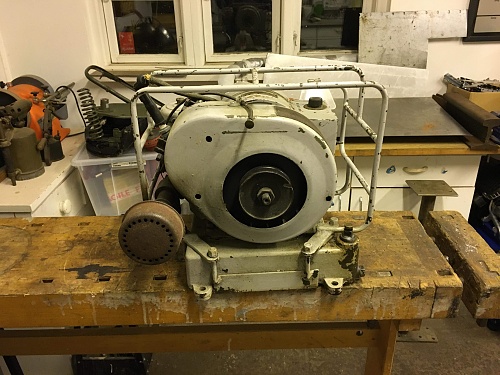

Hi
I have just acquired this generator set, but I need some help identifying the manufacturer and age ? The large data plate on the flywheel housing is too rusted to give any answers
If possible where do I find a manual and parts, maybe a carburettor and definitely condensators

It looks like the standard British "Charging Set 300 Watt, ED" that someone has painted white.
Could be either 15 volt or 30 volt output, depending on age. (WW2 up to 1970s).

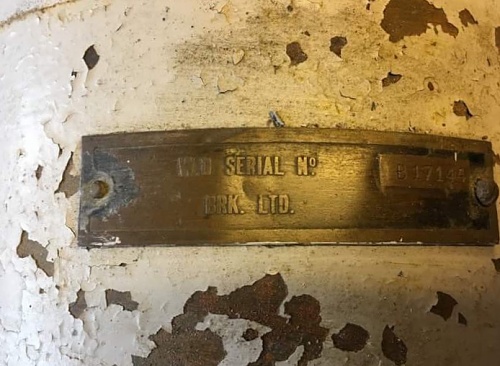

could be Chris, I took the cage of yesterday and the bolts where Whitworth, and the brass plate says WD serial no

I'm guessing Johnson chore horse?

I'm with luke on this one...but there are a few wee changes..
a thing of rare beauty, regardless

could be a British BSA version as well

I think it is a post war BSA unit, if you look at the picture of the chore horse then you can see that the box with the Amp meter is slightly smaller on the Canadian unit .There is a extra bit added on the lift side of the white one,
Old 25-02-18, 15:08
The clues to it being a BSA set are there in the picture, a Joe Lucas ammeter and the little plate on generator cover with 'WD Serial no' and generator makers initials on it.

So it seems to be a wartime BSA
I had a look the busted condenser's and they are date June 44.
