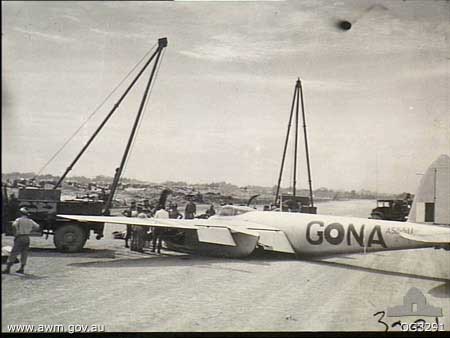

Old 29-08-06, 22:16
Posts: 14,976
Originally posted by cliff
photo 2
GONA looks like it's a goner
G NA maybe, the O is a roundel
Richard Green
