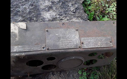

$ E.g. CHASSIS F-60448-M CAB 13
CHASSIS SERIAL 68048
ENGINE SERIAL 3G-20324-F
CONTRACT SM2104 BUILT MAR 17/42
In Australian Army service, this truck wore the ARN (Army Registered Number) of 53050.
