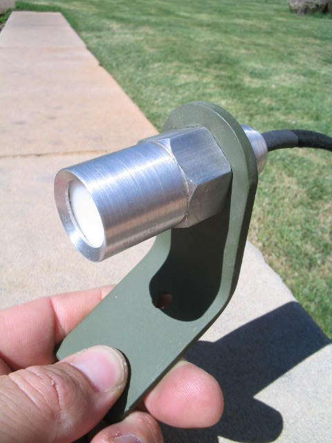

Cab 11 and 12 have a rubber bodied lamp, with a red lens for the rear and clear or opaque lens for the front. Blackout masking is by a steel disc with a small hole that fits under the rubber lip. These contain a single filament bulb, and there are two as Tail lights on either side and a 3rd one is fitted to the right side as a Brake light.

The Cab 13 has a steel tube style lamp, and again these are fitted with single filament bulbs with one either side as Tail lights, and a 3rd for Brake. These feature a red lens on the rear and a white lens on the front. The same lamp is used with an extension tube for convoy illumination of the rear differential.
