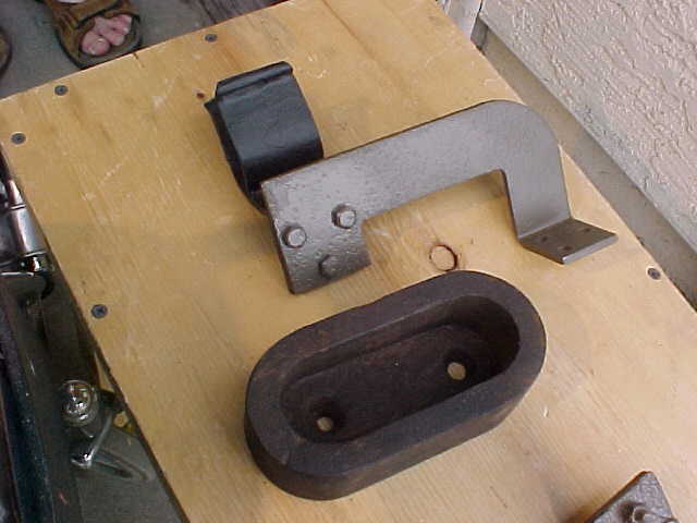

Default Rifle Holders
Chuck,
Thanks very much for the pictures of your curtains. Could you porvide me with some measurements and close up pictures of both sides of the windshield frame ones; I don't have anything on them at all.
Attached are pictures of the rifle holders I have for my F8. I haven't installed them as yet as I don't have the second "cup" that holds the rifle butt in place. One of those lesser "to do" things on the list!
Jim
