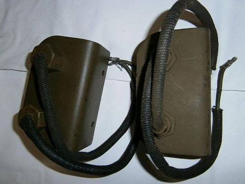

Remember those NOS Ford CMP Tail/Brake lights on ebay a number of days ago?
I bought a set for myself. I won't upset anyone by stating the purchase price, suffice to say that I am VERY pleased with the transaction.
These may prove to be my treasured 'Purchase of the Year'!
  #314

Default Ford CMP Tail & Brake lights.
If my calculations are correct, he still has another set to sell.
On the expected sale price, I thought they actually went quite cheap. First one = $128 & second= $120. Two people considered they were worth getting
If it makes you feel any better........the "Ford Canada in Wartime" I won, hasn't arrived yet.
That might equal things out

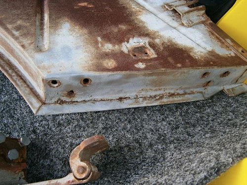

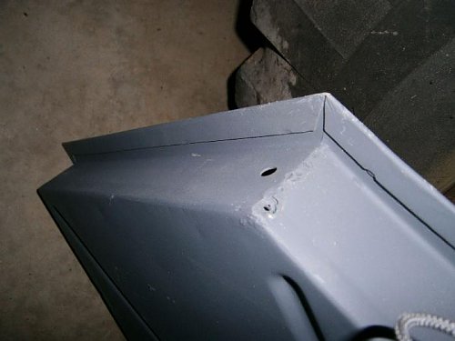

Drivers door is back from the blasters today.
Name:	Driver door 1.jpg
ID:	47851 Click image for larger version
Name:	Driver door 2.jpg
ID:	47852 Click image for larger version
Name:	Driver door 5.jpg
It is VERY straight. No dents or collision damage at all on outside, but....
Name:	Driver door 4.jpg
There is someone out there who welds worse than I do!
Name:	Driver door 3.jpg
And I'll be doing a bit of my own welding, in addition to 're-repairs'.

Hi
Maybe I should make some repro sets and flog em off for some profit
What is the dimension across the hex section ?
I can buy some hex mild steel and turn it down ....
MIKE

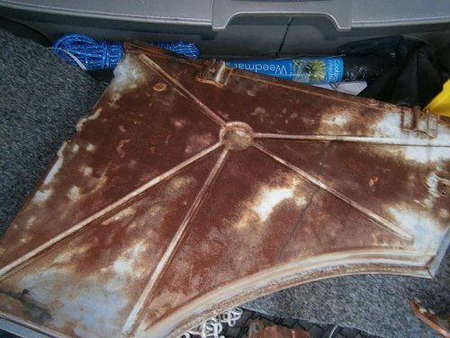

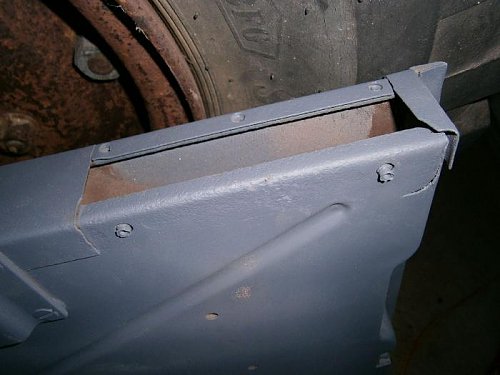

Default Passenger door gets blasted tomorrow
Name:	Passenger door pre 1.jpg
ID:	47858 Click image for larger version
Name:	Passenger door pre 2.jpg
ID:	47859 Click image for larger version
Name:	Passenger door pre 3.jpg

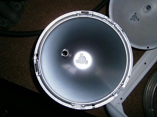

Passengers door loses weight tomorrow. I'm getting a bad feeeling about this one
Better buy a second roll of MIG wire.
Name:	painted headlight 1.jpg
With rain calling a halt to play Sunday, I got curious what a headlight reflector would look like, painted fake chrome silver. Short answer..........not good......not good. I'm using blackout lights, so I was tempted to do this instead of paying >$200 EACH for re-silver, but I am reading up on electroplating DIY. Shouldn't be that hard.

Your wish is my...well you get it!

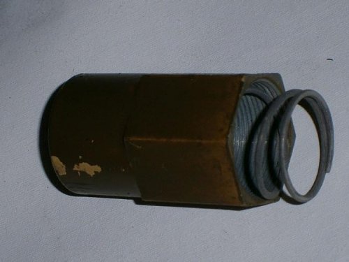

Measurement across flats of the hex is just a 'bees dick' over 1", aka 25.5mm.
I think they are aluminium. Well they are some light white metal, anyway.
Are you meant to rub off the paint over the lens, or is that meant to be retained?
I have seen some of these (in photos) where one side of vehicle has only one light, and a space where the other light should be. Is that normal?
T.
  #321

They're die cast, not aluminium. On the rear there was only one stop light on the right so that is normal.
Maybe thats why so few of them survived intact . Die cast parts are fragile . Are they made in two sections threaded together ? I recall having one years ago , it screwed apart to access the globe from memory ??

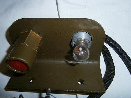

ID:	47884 Click image for larger version
Mike, thats exactly how they come apart.
Here are two photos I took several days ago, for reference purposesl.

OK
what is behind the bracket ? eg, What holds the globe holder into the steel bracket ?
  #326
Old 20-03-12, 12:15
Default Ford Tail & Brake lights. - Assembly / Disassembly
The same hexagonal profile is behind the threaded portion, and this is larger than bracket hole. This would allow spanners to tighten/loosen the assembly body. The same action secures light in the bracket hole. Quite ingenius, two things done with one action. If my set is anything to go by, there is NO rubber seals around the thread to keep water/dirt out. I'm sure I can provide that when time to install!
The seller these lights came from has one final lot on ebay. It is only two lamps with one bracket, but would be good enough for a pattern. $50.00 buy now. I thought about getting them myself, to use as front guard lights, but I am a long way from that stage yet.

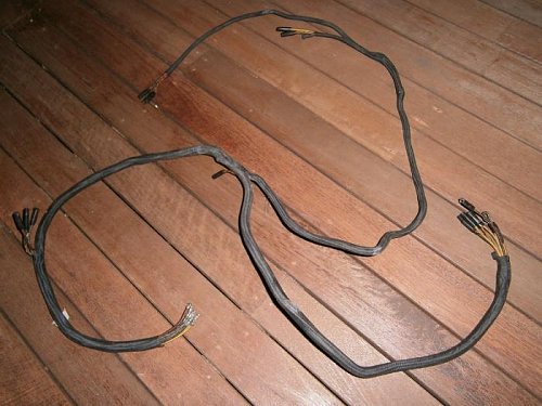

Default C11Q-14403 Wiring Harness

I bought this piece of wiring, which was identified as C11Q-14403. According to the parts manual, C11q-14403 should be a Ford harness for headlight & horn. It looks a little too complex for that!
Is it really that part?
At $5.00, I was happy to take the punt anyway.
  #328
Old 22-03-12, 21:21
Default That's it
Attachment 47973
Yes it is but for a cab 12.
There's also a cab 13 version, same number with C29Q prefix.

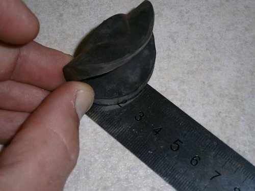

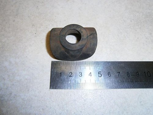

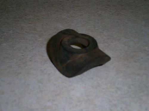

Andy,
These are the grease seals we were talking about.
Name:	rubber seal 1.jpg
Total length - 45mm
Name:	rubber seal 2.jpg
Diam of small hole - 15mm
Name:	rubber seal 3.jpg
Height - 21mm
Name:	rubber seal 4.jpg
Diam of large semi-circle is 26mm
Name:	rubber seal 5.jpg
The thickness of the rubber in large curve is 3.5mm (ish) for most of the length, but one end is slightly thicker. Possibly a subtle design included to create better seal on the lower end. Take that, gravity!!!!
Hope this helps.
