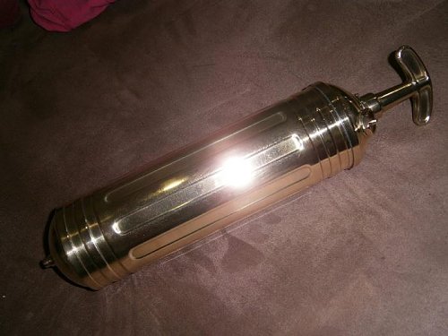

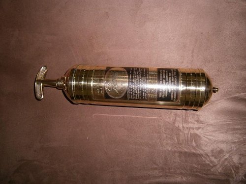

Default Polishing the brass
ID:	48371 Click image for larger version
ID:	48372 Click image for larger version

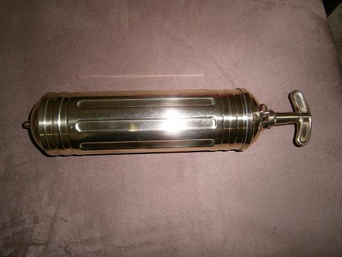

Never a 'dull' moment.

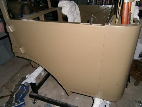

Name:	passenger door finished 1.jpg
Passenger door is now on. I made three shims yesterday, just in case I needed some. I actually used four in total. Same old story about top hinge hitting door edge, same old story of door front edge hitting windscreen support frame, and thats despite the frame pack being insitu. All these problems now overcome.

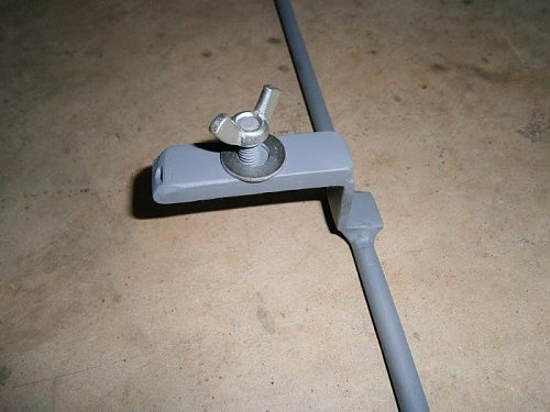

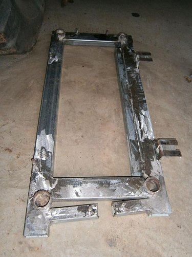

Name:	side curtain frame new 1.jpg
ID:	48410 Click image for larger version
Name:	side curtain frame new 2.jpg
Got the two side curtain frames made. One nearly completed, needing only a strip of metal along rear edge. The other one, just a bare frame. The attachment points will be made for that one next weekend (I ran out of metal bar). They are very easy to make really. I could have gotten away with making only one and using one original, but the original one was a bit tired and would have taken more time & effort to repair than to replace!

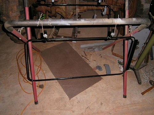

Name:	door curtain frame jig.jpg
That jig worked as I had hoped. Only one cut required once bending completed, and after that cut the ends are ready for welding, which occurs in the jig also.

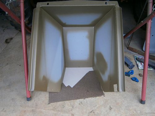

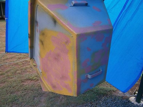

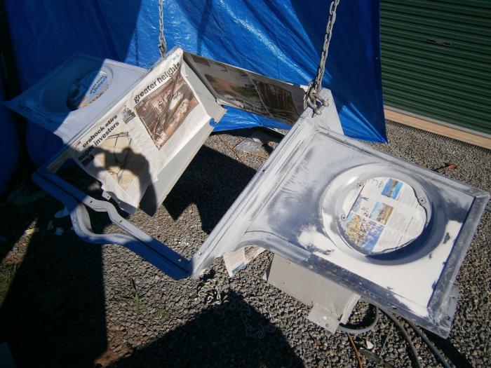

Name:	engine hatch 1.jpg

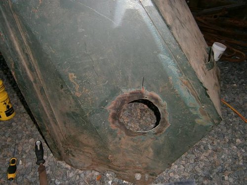

The engine hatch is to be sent for sandblasting tomorrow. It was lucky that the plate screwed over this hole was thick enough to be used as the repair patch, when I get it back from blasting. Hopefully that will be next weekend!
What would you need to access behind the hatch that was so important as to ruin it. Maybe it's for a speaker

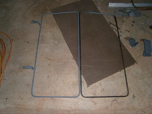

Default Door curtain frames finished

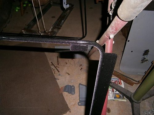

Name:	Door curtain frames 1.jpg
ID:	48558 Click image for larger version
Name:	Door curtain frames 2.jpg
ID:	48559 Click image for larger version
Name:	Door curtain frames 3.jpg
The frames for side curtains are finished, painted and ready for sending to the upholsterer next week. Better make that late next week, to allow for sufficient curing time of paint. Ignore the white specks on the black paint. It is filler dust, and paint was surface dry when it landed.
I have made a slight change to the way door latch access panel is held closed. Formerly it had a tiny metal catch to sit behind once lifted up and over. Maybe it worked better when new but now it's a bit tired and worn. When I make the new pieces of card for the flaps (which will be given to upholsterer for covering), I will be including a small 'rare earth' magnet that will mate up with a piece of metal welded to lower frame rail (can be seen in photo 2). My only concern is that the magnet will stick too well. It's a tiny magnet but VERY strong. Unbelievably strong! I can put one of those magnets on my hand and move it around with another under the hand. Apparently these were often used by magicians as part of their kit! evil swines
More to come.

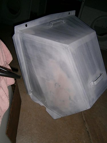

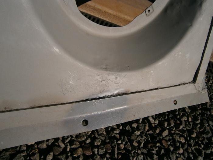

Default Engine Cover work progressing
I had really good success with making the side curtain frames, and was happy with the result.............but...........
Name:	Engine hatch etch primed 1.jpg
ID:	48561 Click image for larger version
Name:	Engine hatch etch primed 2.jpg
got no joy with the work on engine cover, in fact the phrase 'total bollocks up' comes to mind! A patch was shaped, welding started, and then the problems started. First, heat pulled the metal more than I had expected. I alternated weld sites and allowed each to cool sufficiently before continuing, but it still shrunk the metal like I had never seen before. In photo 2, you can just see the filler under the 'emergency' coat of etch. I only got as far as etch before I ran out of day.
Name:	busted panel hammer.jpg
I guess the work required to stretch the metal back to some semblence of normal was just too much for the poor old hammer!

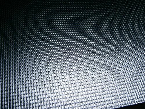

Name:	Engine heat & acoustic shielding.jpg
ID:	48564 Click image for larger version
Name:	Engine heat & acoustic shielding 2.jpg

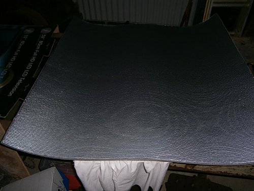

I found this acoustic/heat shield at the local rubber shop. It's adhesive backed and supposed to be easy to apply. I had intended to cut it to desired sizes today. That didn't happen because of the time I spent whacking the engine cover into shape. Not the right shape you understand, close, but definately not right. I am not pleased with losing definition of one of the metal creases on welded side. As Dirty Harry once said...." A Man's Got to Know His Limitations". God I HATE panelbeating

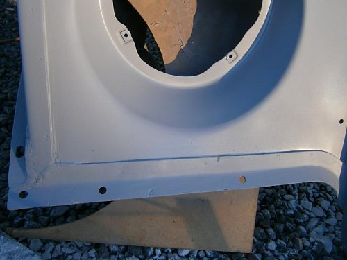

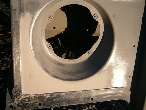

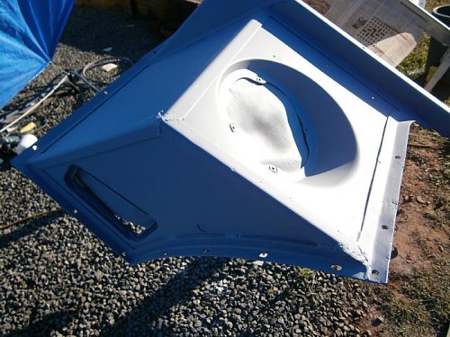

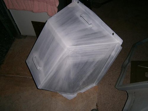

Default Good weather starts work again!
Name:	Pedal plate primed.jpg

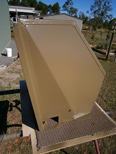

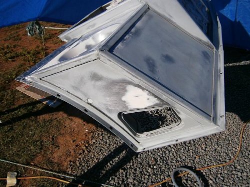

With the sun out again, pedal plate got welded & primed.

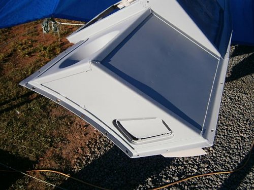

Name:	Engine hatch 2..jpg
As did engine cover.
Name:	Engine hatch 3.jpg
ID:	48757 Click image for larger version
Name:	Engine hatch 4.jpg
In fact, I also painted the inside edges, after two good coats of primer.
I wouldn't normally paint edges alone, but the rest will not be seen once I layer the inside with heat & acoustic insulation.

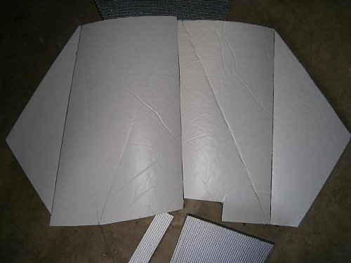

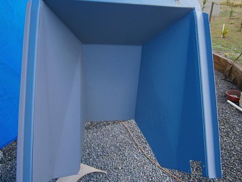

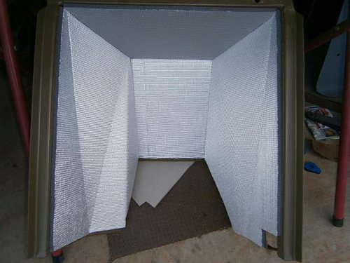

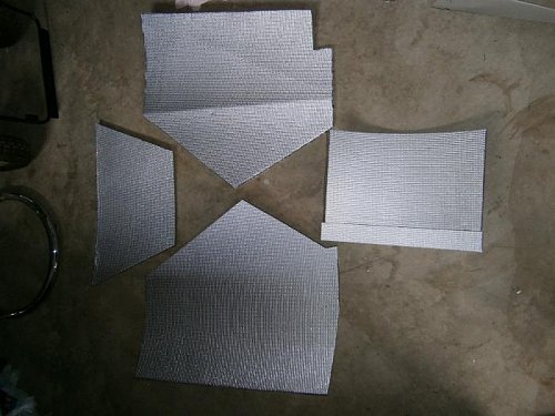

Name:	engine insulation.jpg
Spent an hour cutting templates for the insides of cover, then cut the pieces of insulation. I had bought a metre (~3ft ish) which looked big in the shop but not so big when the templates were laid over it.
More to come

Default Engine cover insulation
Name:	engine insulation 1.jpg
The insulation was easy enough to cut with a box knife. Also making sure to cut part way through where the cover metal has the bends. Negative folds required removal of a small 'v' of the foam from back side, so that insulation would bend correctly without bunching up.
Name:	engine insulation 2.jpg
It sit quite well, but make sure it's in the right place before touching it to the surface or there will be a huge effort getting it unstuck. I tried that on purpose on the workshop door before I started the 'real' installation. There would still be some there now if I hadn't used turpentine to remove it!
Name:	engine insulation 3.jpg
A metre of insulation can do the entire inside, if you cut it right. I marked mine right, then cut the last piece in the wrong place. Don't know why! The result is that the rectangular piece closest to cab rear is now 3 pieces side by side.
Instead of buying more, I have left it that way, to remind me to be more careful in future. It'll drive me mad every time I see it, believe me.
More to come....

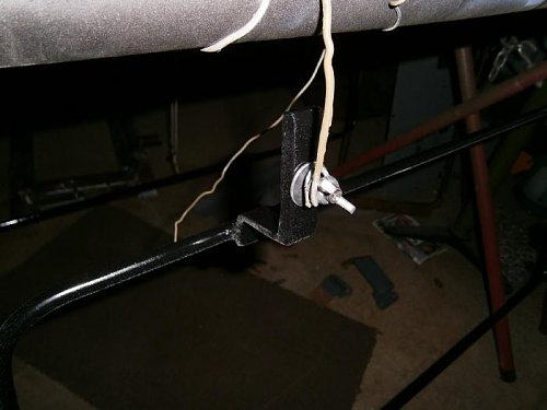

Default Side curtain access covers
Last thing for today.
Name:	side curtain access flaps 1.jpg

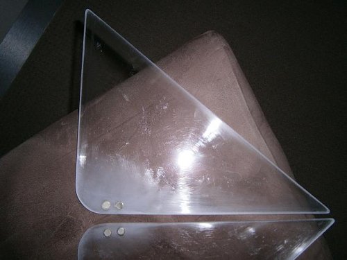

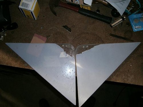

Cut the 'polycarbonate' sheet into two new access flap cards for the side curtains. I don't know what the difference betweeen perspex & polycarbonate is, but I have been assured it is very much stronger and long lasting.
Name:	side curtain access flaps 3.jpg

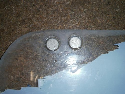

I drilled two holes in each flap, where the corresponding metal piece is on frame, and glued two magnets into the plastic. By pure good fortune, the magnets are almost exactly the same thickness as the plastic sheet. They are just a tiny bit narrower, so the holes I drilled were not all the way through. That way the magnets can't be pulled out of the plastic.
Name:	side curtain access flaps 5.jpg
With these bits finished, and reference photos printed on Saturday, all pieces can now go to the Auto Upholsterer tomorrow afternoon.
I have been advised it will take about 2 days to make the new curtains.

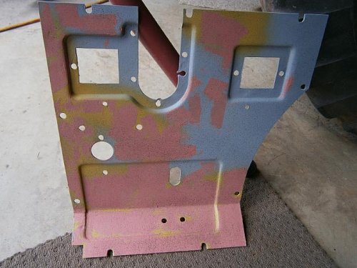

Default Door Side Curtains
All the materials, photos & instructions are now with the upholsterer.
These side curtains may be finished by this weekend!
I have just been reminded that next Monday is a public holiday, which means more time to work on the truck
I may even be able to arrange a visit to a friend who has got a valve grinding tool put aside for me. It looks to be really old and while it is not exactly spartan, could come in very handy in future.

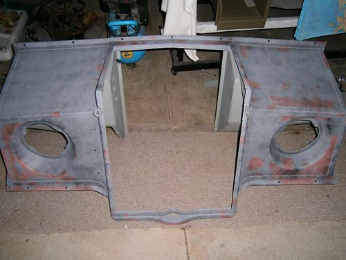

Default Nose Panel Question....
I am looking for some guidance regarding the panel that sits between front panel and radiator. That sort of rectangular shroud thing, you know?
Does this bit sit in front or behind the nose panel?
And, does it just bolt on, or is it supposed to be spot welded to something?
I have two of these which both need some minor remedial work. I want to go onto the nose panel after finishing the engine cover & pedal plate, and will work on the 'shroud' panel at same time, therefor I need to know what I am supposed to do with it.
All information appreciated guys,

Default Todays happenings
Name:	Engine hatch 5.jpg
ID:	48889 Click image for larger version
Name:	Engine hatch painted 1.jpg
ID:	48890 Click image for larger version
Name:	Engine hatch painted 3.jpg
Got the engine cover painted.
Name:	Engine hatch painted 2.jpg
When parts were back inside the workshop & I could take a closer look, I noted that I hadn't entirely obliterated the line where the large round patch was welded in place. It's not well defined any more, but I can't do anything about it now.
Name:	Pedal plate painted 1.jpg
The pedal plate is finished also. New headlight dipper installed. Accelerator pedal to be blasted and installed tomorrow.

Old 06-05-12, 10:54
Default Nose Panel Repairs started
Name:	Nose repair 1.jpg
ID:	48894 Click image for larger version
Name:	Nose repair 2.jpg
ID:	48895 Click image for larger version
Name:	Nose repair 3.jpg
The repairs to nose panel have started, but there was not enough time to complete, so that carries on tomorrow too!
With light fading, I only had enough time to throw on a coat of etch & a single coat of primer. I have since noticed some scratches in the filler that will be re-sanded. It is my aim to do away with need for spray putty, and just apply three coats of primer.
With any luck, and a tail-wind, I should have the whole thing repaired and primed tomorrow.
Name:	Foam & rubber stripping.jpg
The engine cover will have foam strip applied to seal edges and protect against scratching anywhere when it's installed or removed, and a strip of rubber will go between it and cab floor. That's another 'tomorrow' job.

Old 07-05-12, 12:02
Default Snoz panel repairs finished
Name:	Nose damage passenger side 2.jpg
This little gem required a lot of individual stabs with a pick hammer to lower all the high spots.
Name:	nose repairs finished 1.jpg
ID:	48927 Click image for larger version
Name:	Nose repairs finished 2.jpg
ID:	48928 Click image for larger version
Name:	Nose repairs finished 3.jpg
All repairs to nose panel are now completed. There were another 6 repairs done today. As usual, it took longer than expected.
I hate panelbeating!

Default Nose Panel primed & ready for sanding.
Name:	Nose primed 1.jpg
ID:	48931 Click image for larger version
Name:	Nose primed 2.jpg
Primer applied x4 coats.
Name:	Nose primed & guided.jpg
I did get away without need for spray putty, but went mad with spot putty instead It's easier to sand with 400 grit paper.
While the panel was hanging from the hoist, I got stuck into the inside bits and seams. Sanded any areas where sandblasting didn't get all the old paint & muck (Grrrrrrrrrr!).
