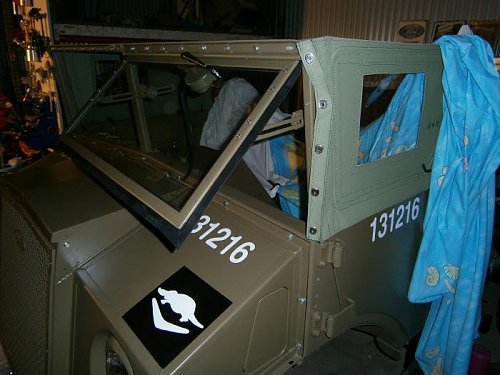

Default Phil - Windscreen frame, hinge movement
Things to check on Windscreen Hinge:
Some of them had a soft gasket between the hinge and the frame that moves the hinge out about 1/16 of and inch.
There is a notch in the hinge fore the wiper shaft if the notch in the inner and outer don't line up this can cause a problem.
Are the screw heads that attach the hinge to the frame sticking up in the hinge when it is closed. Cheers Phil
Yeah, I discovered the bit about lining up the hinge with the wiper opening. That's a bit odd isnt it? Anyhow, that didn't fix the problem.
I just checked the screw heads on upper frame. They don't hit anywhere, so it's not that either.
I'm curious about the 'gasket'. Wouldn't that mean the hinge piece would move backwards & forwards during use? Maybe it's meant to, to overcome the problem I am now having? To be honest, I don't fancy that as a cure. I have several other hinge tracks I can try, and failing that, I can 'persuade' the hinge to see things my way . That's a last resort though.
Bought the rubber for outer edge weather seal which is perfect fit, as well as rubber for the glass recess, that I will need to modify slightly. I'll be doing that once I finish writing this.
If you don't hear from me any more, it means I have probably bled to death shaving a little off the glass seal rubber

I'll be reinstalling the windscreens on my HUP this week so I'll have a chance to see what could be causing the problem. If my memory is correct the windows should swing down so that the outer "T" gasket is nicely seated and the frame is flush with the outside frame.
Did you have the two hinge sides apart at the same time? My thinking is that if the inner or outer parts got exchanged that could be causing a problem as then might not be seating well together.

I suspect that is the problem. Frame and hinge parts are from two different sets. The original hinge for this frame is quite poor, as a previous owner had taken to it with a grinder to grind off the bolt heads attaching it to the window support frame.
I would not be happy to use that damaged piece as it is, and repair might not be a viable option. On Saturday I will try and find a suitable replacement amongst my parts stores. I think there are another 2 or 3 which may be usable. At very least, the current hinge may be good for the driver side frame.

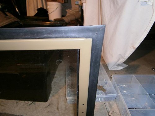

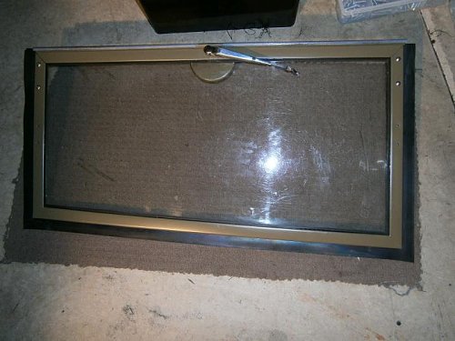

Default First window frame painted, regardless of Melbourne weather.
The rain didn't stop all day, but I really wanted to get the windscreen frame painted, so I can insert the glass during the week. So, I put the cars out for a 'natural' wash, and set-up work under the carport.
Name:	Window frame - passenger painted 1.jpg
ID:	50083 Click image for larger version
Name:	Window frame - passenger painted 2.jpg

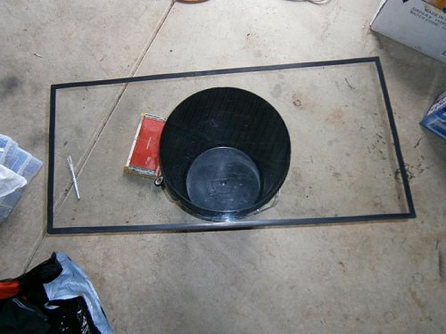

I was worried that the paint may 'blush' in the low temperatures, so each coat of paint was quickly followed with a few minutes of exposure to heat lamp (well it's a floodlight, but it's bloody hot up close).
Name:	Window glass - passenger 1.jpg
ID:	50085 Click image for larger version
Name:	Window glass - passenger 2.jpg

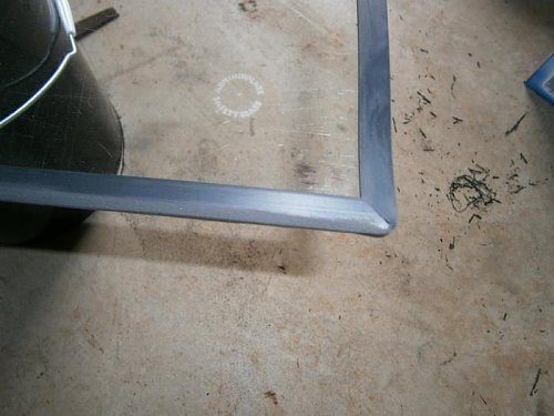

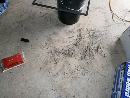

The windscreen rubber took far longer to make than I had planned on. Nothing new there. The rubber seal was slightly too thick for the window channel it will go into, so once attached to the screen, I had to pare it down quite a bit. This involved some hand sanding to taper the side so it would 'seat' in the frame. I followed this up with some additional paring with a hobby knife, where high spots remained.
Name:	Window glass - shavings.jpg
It's obvious from this photo that the trimming of screen rubber was quite labor intensive. Pity I couldn't just hit it with an orbital sander. I used 40grit on a broad file instead. There is still no guarantee that I have got the job done to extent required. If not good enough, it will all have to come off and be started again from scratch, with a fresh piece of rubber. The thing that worries me is the effects that corrosion has had on the width of window channel. Some internal rusting must have occured, and the track is slightly thinner inside diameter in places. This could snag the screen as it's lowered into the main part of the frame.
If I had the luxury of painting yesterday, the screen would be in now.

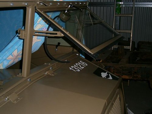

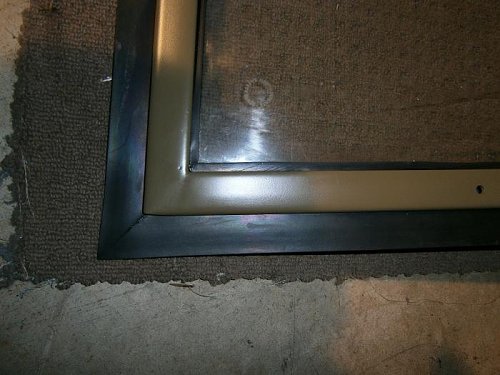

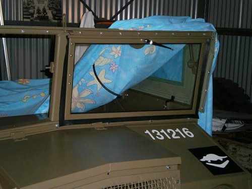

The first of the window frames is now finished. I decided to put the glass in tonight, in case I broke it and needed to rethink the rubber seal technique. Fortunately it didn't break and went in smoothly. Considerably better than I was expecting.
Did have a little help though. I applied new grease to the parts of the rubber that would be required to slide down into the lower part of the screen frame. Without that, the rubber would have been displaced badly while sliding in.
I'll have to find something useful to do tomorrow now
The transfer case has to come out this weekend, and ideally, front end to be removed as well. I have booked a weeks holiday for late July. That is when the chassis will go for blasting.
P.S: I just couldn't get the upper left corner join to go together perfectly. Perhaps the rubber is preventing a proper fit. I might back the bolts off a little and give a bit of encouragement with a rubber mallet. Failing that...............guess thats how its gonna fit!

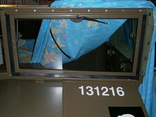

Passenger side windscreen has been installed back on the truck. Well, when I say installed 'back', I mean installed on my truck, not its original truck. That was scrapped some time ago by the owner and same fellow gave me this frame.
It's good to see that FINALLY something fits as it's supposed to, without major surgery to adapt. The only 'jiggery' needed was a minor mashing of the hinge piece, so the window would close well. It worked, and has given no problems since.

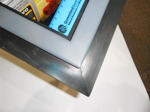

Name:	windscreen finished - passenger 5.jpg
The only concern is the window adjustment slides/rods sit high above the line of the window support panel, and I hope the extra height of the cab roof is sufficient that they dont touch there. I guess Ford knew what they were doing, but time will tell.
My very great thanks to David DeWeese for the set of window adjustment/locking parts!
All those parts were used on this window, so if anyone has another set of 2 slides, hex shaped spacers & the tightening wheels, I would be very interested in buying them so I can do the other side. Even the hex bits and adjustment wheels would be good. I have a couple of ratty slide bits that I may be able to weld up & repair.
