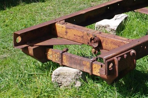

Name:	Chassis bare 1.jpg
ID:	50501 Click image for larger version
Name:	chassis bare 2.jpg

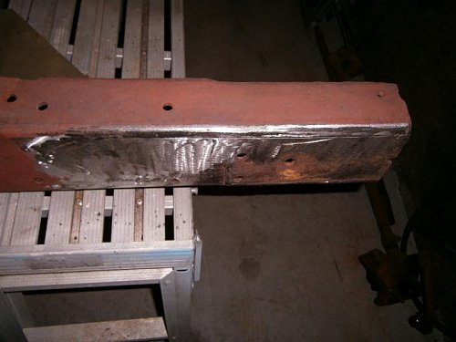

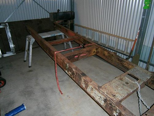

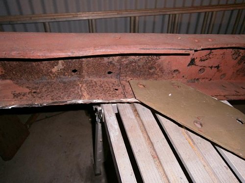

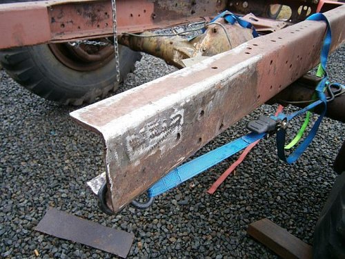

Chassis work continues. Considerably more time spent on this, than I had originally intended, I must admit. I keep finding things to do you see. There is always another rivet, previously bround down, that has to be removed. There is always another place where some kind of bracket/s have been welded (mostly very badly) to secure god knows what. Numerous bits of weld, not desired. Getting all these places back to some semblence of normality is turning into a trilogy in four parts, but i'm nearly done now.

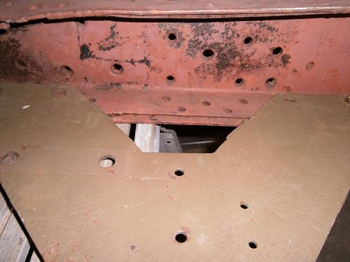

The passenger side rear rail has been returned to its proper profile, but I have not attempted to trim the edges down at this stage, because I am hoping to remove a small length aft of where the new rail and pintle brackets will go. There is a significant crack in this location which will disappear if I cut off the last 10-11 inches of each rail. I wager this crack was why the sides were plated in past.
Name:	chassis crack passenger rear 1.jpg

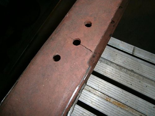

This little crack will need repair regardless. It will not be in the area to be removed. Will leave this job for a professional because they will also need to bring the top part of the rail back to level. It has seen some dreadful treatment in the past? You can see the remains of the vertical plate which has been cut off today, jutting out from the rail.

Name:	chassis bare 5.jpg

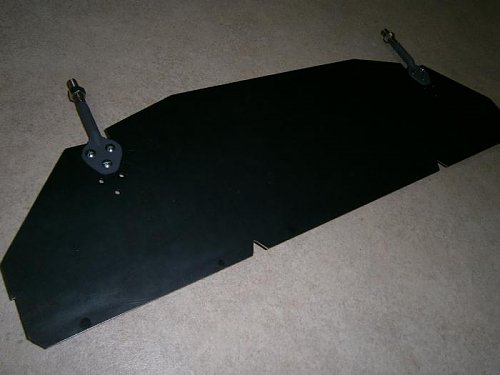

This is where the new cross member will sit in relation to the holes for spring hanger. Cross member will have to be slightly aft of the spring hanger. To put it exactly where it should go, there will be issues with existing holes being a problem. They would have to be filled first. That's a job I don't need! You can see some of the holes in the photo but these aren't a real issue. There are more, and of greater concern, where the big bracket would sit. By dumb luck, a couple of the existing holes are 1/2 a 'hole' away from where the new holes would go. Brilliant
On the other hand, in the position you see above, I can mooch of an existing hole one each side, as a 'starter for 10'! And they are even equal side to side. So are the spring hanger mounting places. I woke up one night with the sudden fear that a bodge may have been done.
Looking at Tony W's photo, my cross member should be about 4cm (just over inch & 1/2) further forward, to look like this one. I can live with the difference, and there will still be sufficient room to cut off the bad part of rear chassis rail, leaving a fairly neat finish. I do note that mine will have a slightly different appearance anyway, because my rails are double thickness.
Will I need to cut the hole through the chassis rails, to match the large opening in side of the pintle brackets? If this was not always done, mine won't be either. If it is..........well........thats a problem for the engineers
At least my chassis is nice and straight. Well it should be too, there's hardly enough metal in the rear section to keep it out of level. The chassis engineers use a system for keeping chassis perfectly level while assembling the bits back together. Some of those parts are now in the boot of my car, to be sandblasted seperately, so I can show the guys how the parts are supposed to go together. Don't really want them to put it all together splendidly and then find a cross member is back to front!!!!
Looks like your engineers will have the interesting job of adding the big holes in the sides as they are always part of a CMP chassis.

There is a significant crack in this location....I wager this crack was why the sides were plated in past.
Yes I'm sure you're right Tony, there had to be a reason for these extensive chassis mods in the past. Perhaps the rearmost part of the chassis was even worse so they decided to shorten it as well.
  #609

As Keith says this hole is present on all CMP chassis. It's not essential but it's quite distinctive cosmetically. My suggestion would be to wait until the pintle hook mounts are bolted on, then simply run an appropriate sized hole saw through the chassis rail. That way it will be sure to line up with the hole in the pintle hook mount.

This little crack will need repair regardless. It has seen some dreadful treatment in the past?
Quite possibly, but I suspect the principal cause of blitz chassis failure is removal of the original body. The loss of rigidity leads to enormous flexion in the rear chassis, which is really quite spindly, esp. the Ford rear chassis. Also the loss of weight over the rear axle means the springs are virtually rigid, so the rear chassis simply twists back and forth over uneven ground, eventually causing fatigue cracks. We rarely see a bent chassis from overloading, but it's common to see fatigue cracks from constant torsion. Of course, with a dodgy crane fitted, the torsion forces can be massive.
Another area subject to repetitive torsion is the front chassis under the steering box. The chassis rail is only single skin at this point, and it has to support the engine mount on one side, and the spring hanger on the other side, plus the back and forth steering wheel force multiplied 20+ times through the steering box. Pics below show a fatigue crack in this area on a F60L chassis I scrapped recently. As you can see it has progressed almost half way through the chassis rail....imagine the consequences of sudden total failure at speed!

I like the way you think things through, Tony.
Another common fatigue spot (at least on Fords) is the top of the dash panel and where it bolts onto the steering shaft bracket, due to flexing of these parts over the years. You sometimes see either cracks stretching from the bolt holes, sometimes even a half-moon shape separates when you undo one of these bolts.

Here's another fatigue crack on the same F60L chassis. This one has cracked through the double skin section amidships. It's located precisely above the dodgy front crane mount which has focussed the bending/twisting forces at that point. I think you can see why I scrapped this chassis!

Thankfully no cracking found in front part of chassis. I'm bloody glad too, after all the horrors you have told me
I had been rethinking about removing the rear little bit of chassis rail. In fact I thought about having that piece cut off but replaced by the engineers. The pintle brackets will obviously be on this area, and I have reservations about loading forces on replaced sections, in eventuality that I do use to tow something. What do you think? I won't attempt repair, but would direct replacement of last foot or so be sufficiently solid to tow anything?
When I removed the very front cross member, I noted that the radiator support plate was welded to the chassis rail on driver side, and both sides of the cross member were welded to rails in two places each side. Is this normal? It was actually quite neat work, and not in fitting with the other very sub-standard work displayed. Of course there may have been more than one 'welder' over the trucks history. The reason I wish to know this is so I know whether to re-weld these areas again (not literally me).
One final point, regarding rear springs. I had previously disasembled both rear spring sets for blasting, but am now thinking about using the springs off my other vehicle. My chassis does not have the spring over-rider holes in the rails since it had been shortened. The springs off other truck DO have the over-rider leaves on spring sets. In light of what you had said, Tony, regarding the lack of weight in rear = very hard springs, is there any point in including these overrider springs on the finished product???? It may be more of a correct look, but is there any purpose to having these retained? I won't be adding anywhere near the weight the vehicle was designed for, even if I go ahead with the 40mm BOFORS idea. Remembering my version will be a much lighter replica.
What do you fellows think? All comments welcomed!

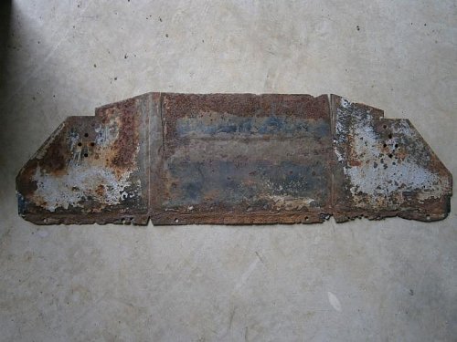

It's "normal" but it's not "original"! Most working blitzes seem to accumulate various chassis welds over the years, but originally everything was only riveted or bolted. As far as I've been able to discover myself, the entire chassis was completely untouched by a welding rod when it left the factory. Even the factory fitted chassis reinforcement plates (see pics) were only riveted.

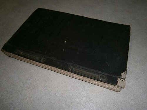

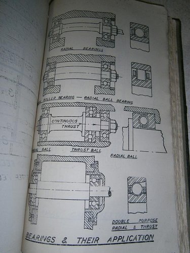

Default An interesting purchase

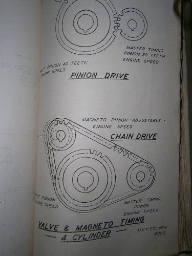

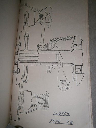

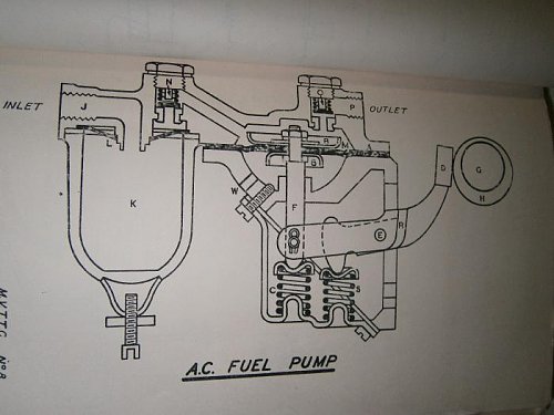

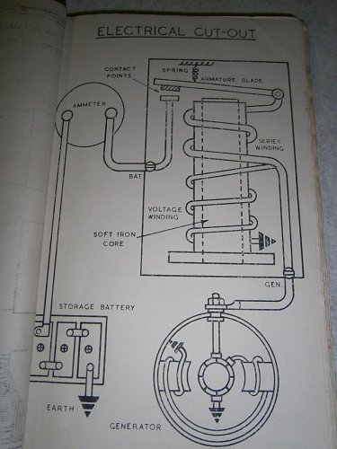

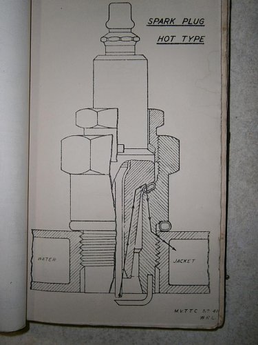

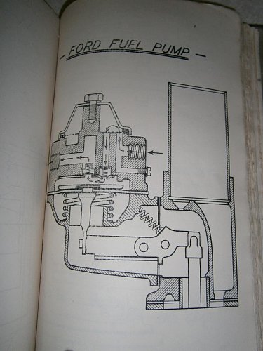

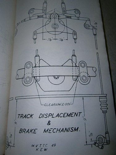

Just received this book I purchased a couple of weeks ago. The auction description did not really pinpoint it's specific use. Since it's arrival, I have discovered it is in fact a manual, textbook if you will, used for training of Australian driver/mechanics, in WWII. Originally from Melbourne, it covers a great range of systems, vehicle brands & types, as well as having lots of learning material in written and diagram form. Very handy for a novice like me, and I would wager some of the students using this would have been little more than mechanical novices too. My Father amongst them. It blows me away to think he may have sat and studied a book just like this one.

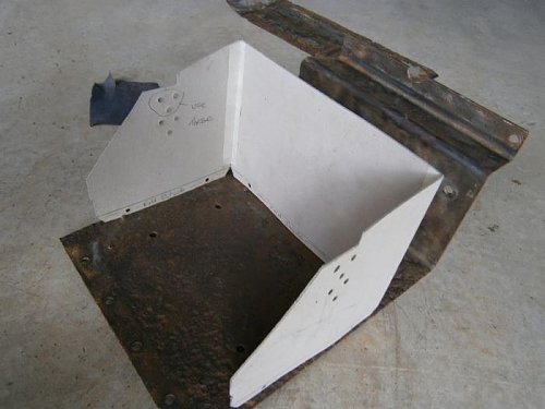

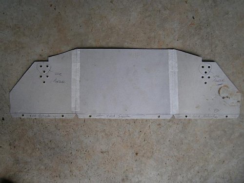

This afternoon I called to see the guys that will be replacing the chassis cross member. Discussed option for having them remove & replace the extreme rear of both chassis rails. The manager doesn't feel there would be any problems doing this, so that will hopefully be the 'end' of that.
If this is done as above, the pintle brackets can be placed back of the cross member bracing plates. That means I won't need the guys to make the holes in rear of bracing plates align with the corresponding holes in bottom of pintle brackets. They are same diameter and exact same spacing to one another. With extra room available, that potential difficulty can be avoided entirely.
One minor hiccup in all this, is that the newly employed fellow that does the sandblasting is off work with an acute illness. He may be back early next week, but this won't be known until next week. I spoke with one of the managers and offered to do the blasting myself if they showed me the basics of their particular blasting setup. This may be a valid option, as I have used a commercial sandblaster in past, but they may still be cautious about my suggestion! At least that would not take another employee away from their work just to attend this relatively low return task. Time will tell.

There seem to be more willing donor vehicles out your way. For me I must rely on the kindness of friends up in Canada to find me bits of CMP which are needed.
Yes, you're definitely CMP deprived in the US Phil! I'm not sure how many were shipped down under but it must have been in the tens of thousands I would guess. Fortunately a good percentage have survived in one form or another, thanks mainly to their durability in various civilian roles over the decades. It's only in quite recent times they've attracted interest amongst MV collectors.
The chassis repairs you describe are good examples to follow I think. As you suggest, there's no need for welding if the components are securely bolted together. After all, the pintle hook itself is entirely bolted on.
I enjoyed the serendipity in your misunderstood channel specs! The resulting "expandable channel" solution was rather clever I thought. I may even pinch the idea for my FGT chassis repair! Alternatively, I may leave a gap between the two pieces so I can run welds along the edges, directly onto the inside face of the chassis rail. I'm also considering replacing the spring hanger rivets with longer ones and running them through the reinforcement piece. Whatever I finish up doing it needs to be strong enough to withstand lateral forces generated by the winch cable. I like your 1/4" channel - very beefy!
Just for fun I've included some pics of a nearby CMP boneyard with some of the "willing donor vehicles" you mention. I daresay this pile would have come in handy for your chassis extension. I'll leave you to identify the eclectic mix of parts!
Tony

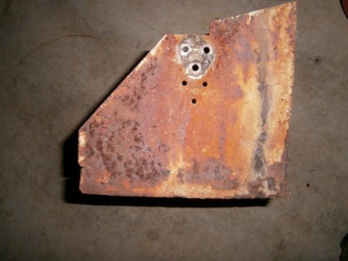

Name:	Battery Box old 1.jpg
ID:	50761 Click image for larger version
Name:	Battery Box old 2.jpg
Started on making a new battery box this weekend. Original frame is in extremely poor condition and cannot be used for anything more than a template.
Name:	Battery Box template 1.jpg
ID:	50763 Click image for larger version
Name:	Battery Box template 2.jpg
Template made and checked for accuracy.

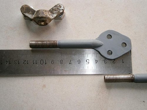

Name:	Battery Hold Down Bolts 1.jpg
The battery hold down bolts are in good condition, and can be reused. I will need to find one more of the brass wing-nuts shown in this photo.

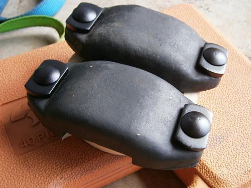

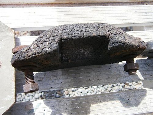

Had a bit of time on my hands Sunday. Power company were working on the network, so no mains power for virtually all day and I had to stay on solar power. The solar is fine for virtually all week (stand alone system) but with no alternative yesterday, I was restricted to nothing more draining than a small angle grinder.

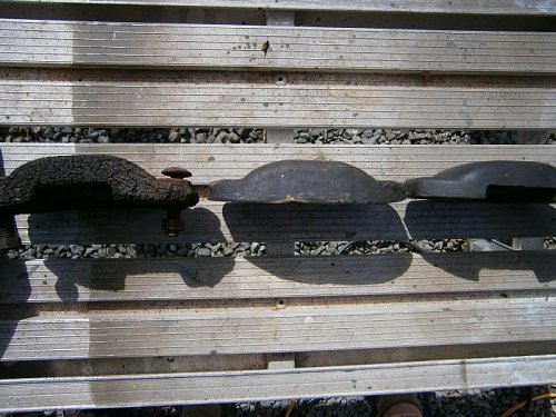

Name:	Front Axle Bump Block Old.jpg
With that in mind, I turned my attention to the front axle bumpers. The originals are not salvagable and must be replaced.
Name:	Front Axle Bump Blocks 1.jpg
Many months ago, I bought two new rubber bumpers, that only needed to have the rebate cut into one side to accomodate the shape of the brackets. Very simple job and very quick to do.
Name:	Front Axle Bump Blocks 2.jpg
The cleaning of the bolts & associated hardware was more time consuming. Normally would use the blasting cabinet to clean something like these, but not able to this time.

Default Trailering chassis for blasting this morning.
Finished all the chassis prep work yesterday and it will be off for sandblasting & repairs today, so long as I can hire a trailer this morning.
Wouldn't think there would be a great demand for car carrier trailer on a Monday. In contradiction to Saturday, when I went looking for quotes and to take measurements to check fit. Not that the length would be a problem, it's that some trailers have ramps that lift up rather than slide under the deck. The lift kind wouldn't be of any use to me.

ID:	50798 Click image for larger version
Name:	Battery box new 1.jpg
Work continues on battery box. Bought the mild steel plate this afternoon and got home with enough time to cut this from the template I have. Was initially going to mark the shape only, and get the steel place in town to do the cutting, but it looked so easy to do, and I couldn't help myself. Hopefully the steel shop can do the folding for me tomorrow.
