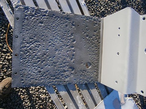

Bloody hell Tony, I haven't even thought to check Macs yet. Cheers for the info. My next purchase from Macs will include one of those I believe. I need to order some supension and brake parts anyway.
Name:	Battery box base 1.jpg
ID:	51014 Click image for larger version
Name:	Battery box base 2.jpg

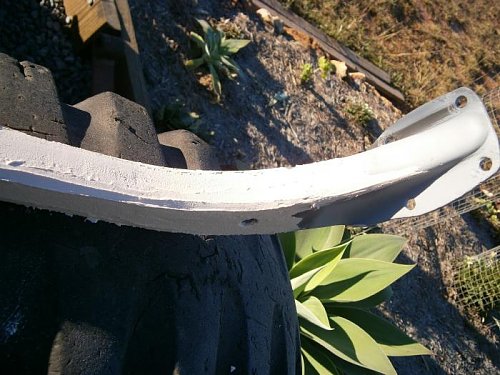

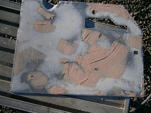

The afternoon has been spent playing panelbeater again. Determined to get all the driver side step/battery box parts looking as good as can be. Unfortunately, that involves a considerable amount of body filler, sanding, body filler, more sanding......
Name:	Battery box base 3.jpg
Guess this is how they faked the moon landing. The eagle has landed!
Name:	Step bracket 1.jpg
ID:	51017 Click image for larger version
Name:	Step bracket 2.jpg
If i'm calculating accurately, there is about 1/5 of all filler applied that actually remains after the sanding & shaping.
I won't get paint on the step/battery holder parts tomorrow. The photos shown above were taken around 3pm, so both those parts with filler are now under primer. The heavy steel battery tray base now has it's second (lighter) coat of filler, but not primed / spray puttied yet. The step has not yet been touched either. It is in good nick but does require a light skim of filler across where the tray bolts to it. With all that in mind, I wouldn't dream of trying to get final coat on tomorrow. Not enough time for the primer, spray putty & blade putty to dry. Paint them too soon and all sorts of nasty problems will eventuate.
I suppose I could paint the battery box itself, but no point soiling a gun, and all that cleanup afterwards, just for one part. I'll do em all next weekend..............as always, weather permitting.

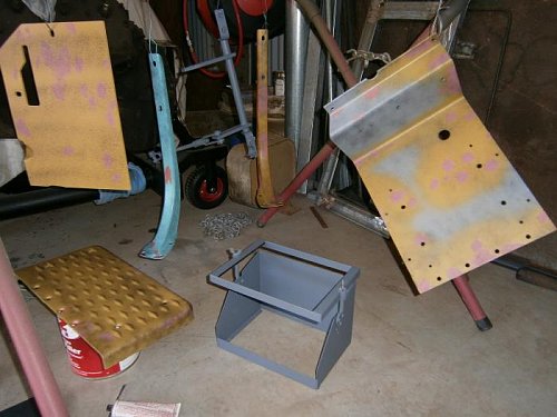

Name:	Driver side parts primed 1.jpg
All the driver side step & battery assembly parts are now repaired and under putty.

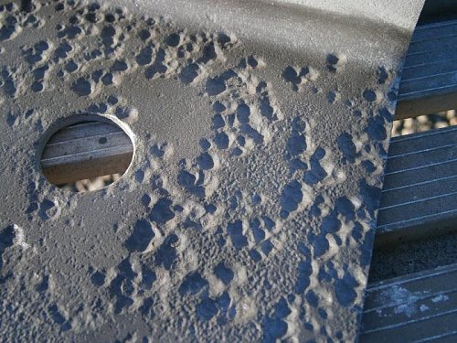

Name:	Driver side step before repair.jpg
The pitting on the step, is clearly visible here. It's fixed now, as is one of the diamond pattern shapes that had a very little hole on one side.

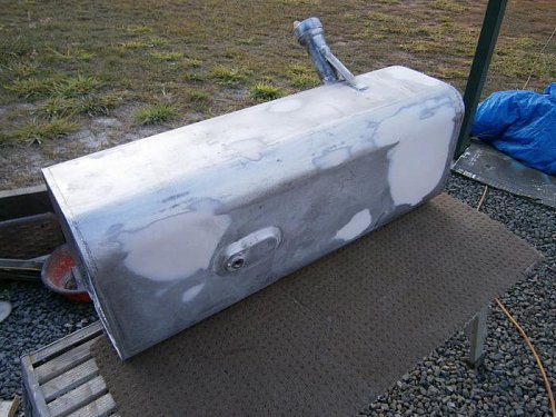

ID:	51082 Click image for larger version
Name:	Passenger tank etch primed 2.jpg

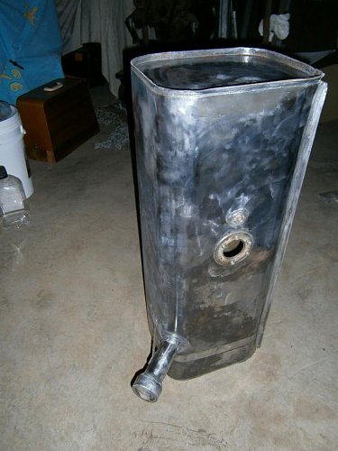

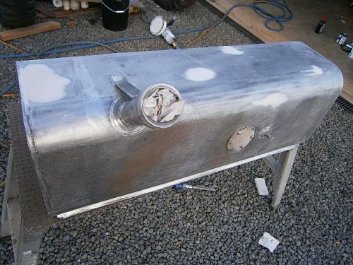

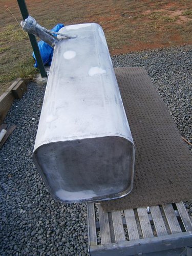

I moved onto one of the fuel tanks, and got it stripped and etched. I can only see three dents that will need repair. Some of the places I originally considered may be dents, have turned out to be spot welds.
Pity I found a hole on the underside of the tank. It's smaller than 1/8in, but it will need to be brazed shut. I'll find someone in town for that. I bet they will be afraid to do it, thinking that it might blow up. Won't they be surprised when I tell them thats why I didn't do it myself. Seriously, the tank hasn't had fuel in it for years. I will flush it out before I take it in too.

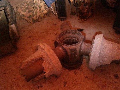

Default Matt - As Promised, Propellor Boss Photos
Matt,
I have finally taken some photos of the part in question. It is currently in an ackward location under some stuff in my other shed, so I wasn't able to get photos from directly above. Hope these two are good enough.
Name:	Propellor Boss 1.jpg
ID:	51136 Click image for larger version
Name:	Propellor Boss 2.jpg
As you can see, two of the propellor blades have been snapped off at the blade root, leaving traces of blade as shown. The third one is completely gone. My guess is that the gap between blade remnants and central hub of the three blades is where the variable pitch mechanism would have been. There is evidence of this on one of the blade sides, but it is not visible in these photos.
As a reference to size, the object on left of photos is a motor mower catcher. The piece is sufficiently heavy that I can only lift it for a second or two. Two person lifting is not much better either. It took me several lift attempts to heave it up to my car boot. Was just as much fun getting it out too!
As indicated, this was given to me some years ago, and advised to be from a Boeing B-17 that crashed. I can virtually guarantee it isn't from a Cessna.
My plan is to incorporate this artifact in a memorial to WWII airmen. Especially those airmen that did not return.

Hi Tony,
Very Interesting item and yes quite a heavy lump, I wonder if it may have originated from the Baker's Creek B17 Crash which i beleive to this day is Australia's Worst air Disaster. Just a thought ? It certainly appears to have Hit with some Force To shatter the Alloy Blades like that?
Cheers Matt Baker

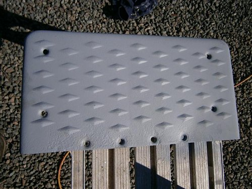

Name:	Driver side step assembly 1.jpg
ID:	51345 Click image for larger version
Name:	Driver side step assembly 2.jpg
ID:	51346 Click image for larger version
Name:	Driver side step assembly 3.jpg

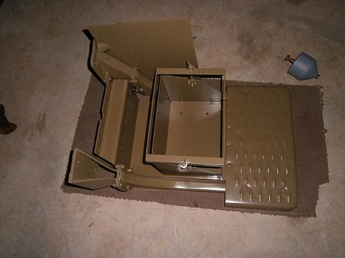

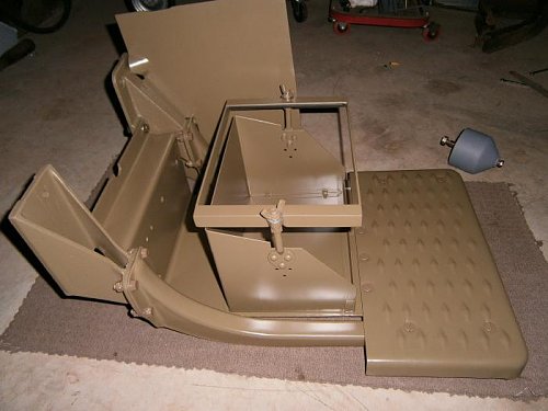

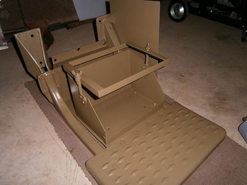

The driver side step/battery asembly is finished. The last bolts went in this evening. I'm relatively happy with the result.
It's certainly better than it was originally!

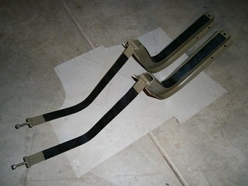

Name:	Fuel tank brackets.jpg
Also got a set of tank brackets ready to go on. One tank is with a panel shop in town & the second one will accompany it tomorrow. It has a very small rust out that needs brazing up.

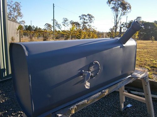

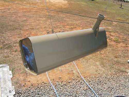

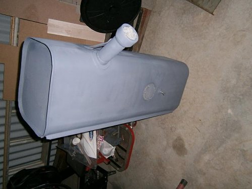

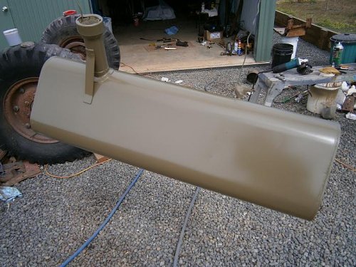

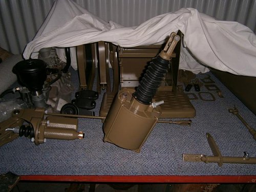

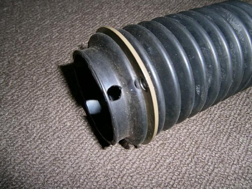

I got a little sidetracked today. Hadn't intended to work on the vacuum booster right now, but did some cleaning work on a couple of the parts, including frame bracket and vacuum intake filter assembly. Breather still had the original filter element inside too. Yuck! I'll make a suitable foam one to replace it.

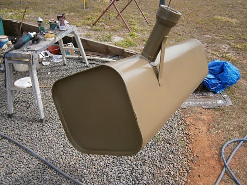

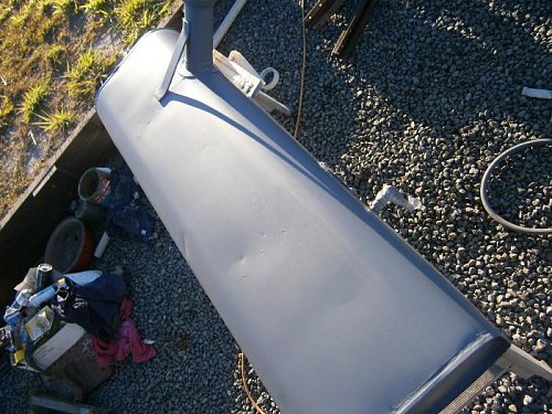

Name:	Passenger tank painted 4.jpg
ID:	51416 Click image for larger version
Name:	Passenger tank painted 2.jpg
ID:	51417 Click image for larger version
Name:	Passenger tank painted 1.jpg

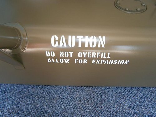

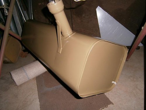

Didn't get those parts painted but did get the first of the fuel tanks finished. Stenciling will get done next weekend, unless I get inspired to do it sooner.

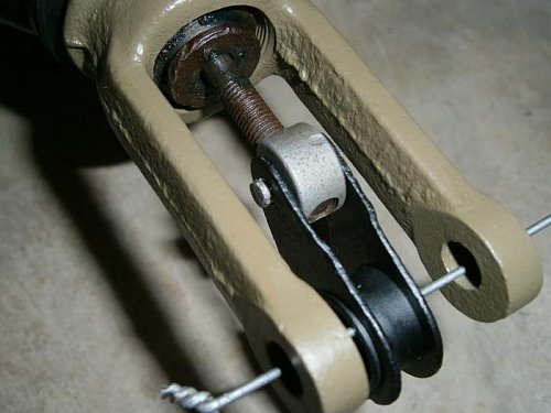

Name:	Brake mechanism painted 1.jpg

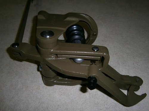

Also painted all the brake mechanism for master & booster. Can't see me waiting to next weekend to put this back together, so I guess it will get done some time through the week, when the television watching is particularly poor. That could be any night!

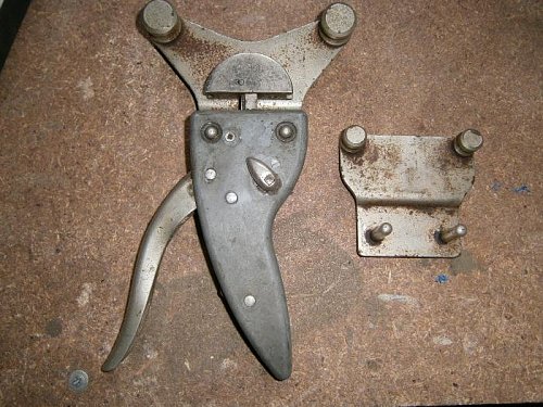

Name:	Pipe bender.jpg
I bought this brake & fuel line bender for $20. Notice it has 2 different sizes to bend with. Never seen one quite like it, and it caught my eye. Made in UK too, none of this 'made in China' muck. I have tried it today, and found it to be wonderfully easy to use, with just a moderate effort required to bend 5/16 steel brake line. I also bought a brake/fuel line flaring tool of advanced years, and once again, made in UK & far superior quality over modern stuff. That cost $6.00. They would come in very handy with making the brake lines for my truck, and that's where the redundancy comes in.

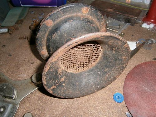

While at the swap, I also found this horn which is fairer match for my truck than the longer bodied version I already had. It may not be exact but it's close enough. It also gives me a little something to tinker with on the weeknights when I couldn't be bothered going down to the workshop.

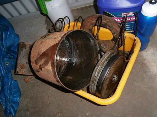

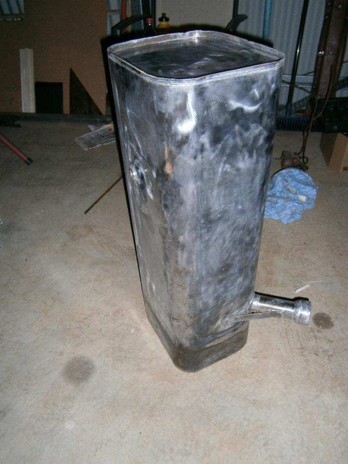

I stripped the drivers side fuel tank today as well. Was in process of running over it with the wire cup when the light started failing, so I will continue next weekend. Don't know if I can get it to paint stage, but should have all repairs done and under primer by stumps Sunday next. There are a fair few dents to receive attention on this tank. I'm not as lucky with this one, compared to the passenger side, which was in pretty good shape.
Managed to finally catch myself with the twisted wire cup I was using to strip the tank. This had been expected for some time, as I fear I had been getting braver (more foolhardy) with it's use, and attempting to hold ever smaller items closer & closer to the cup while in use. I wasn't actually doing the tank when it bit me. It was a far smaller and more fragile part I was doing, when the wire cup caught the part and threw it to one side, thus exposing the finger directly to the spinning wheel. "Oh My Goodness" I exclaimed..............or something of a loosely similar nature. You will be very pleased to know that the small part (vacuum booster breather filter) was NOT at all damaged. The finger.........as the Black Knight would say, was "A mere flesh wound". Silly Bastard!

I would like to offer a comment for people looking at repairing or stripping tanks. Of my 3 Chevy CMPs the 1941 Pat 12 and the 1942 Pat 13 have plain steel tanks with the neck soldered on, but the 1945 HUP tanks both right and left appear to have been lead or tin coated. I mention this so that anyone can check to see if their tank looks like it is coated. Aggressive cleaning with wire brush, scotch pads or sand paper seems to cut through this coating. The HUP tanks have NO evidence anywhere in side or out of any rust. While the 1941 tanks will need to be rebuilt or replicated because of rust holes and the 1942 showed minor rust when I restored the truck, no holes or leaks then or now.
Has anybody else encountered a coated tank?
The only reason I can see for the tanks to have been coated in the first place was to prevent rust, or to seal tanks that had minor leaks at time of manufacture.

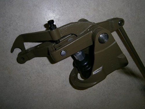

Name:	Brake mechanism finished 1.jpg
ID:	51441 Click image for larger version
Name:	Brake mechanism finished 2.jpg
I knew I would get the brake mechanism finished some time this week, but I didn't think it would be this early. TV particularly bad tonight, so put the parts back together instead.
Master cylinder from Rockauto is now in transit between Sydney & here. Tracking says due for arrival on Wednesday. Lets see how close they are.

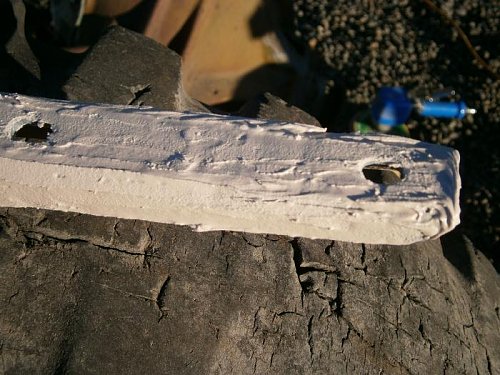

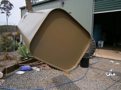

Default Fuel tank repairs
Name:	Driver side tank repaired 1.jpg
ID:	51766 Click image for larger version
Name:	Driver side tank repaired 2.jpg
ID:	51767 Click image for larger version
Name:	Driver side tank repaired 3.jpg
Work continued on the driver side fuel tank last Sunday. As expected, it was not completed before lights out. This is partly due to the unexpected 30 minutes worth of rain at 1500hrs that halted work. When safe to continue, it was already cooling down significantly and my final act was to apply a coat of etch, before shutting down for the week.
Name:	Driver side tank repaired 4.jpg
I will be taking the etch coat off tomorrow. It 'blushed' from the low temp and moisture formed on the surface. That means it will also have allowed moisture through to the metal.
Name:	Tank stencils.jpg
Passenger side tank now finished, including cap with the new seal I made. I bought the tank stencils when I got the bridge loading plate a while ago. They may not be CMP genuine, but I like em!
When I can afford it, I will still run a sealing system through both tanks. I have received product information brochures for two systems of tank cleaning sets, POR15 & KBS Coatings. Both can be used on tanks after they are painted, provided some common-sense measures are taken. Not decided on which to buy, but the KBS Coatings set is substantially cheaper and almost identical in components!

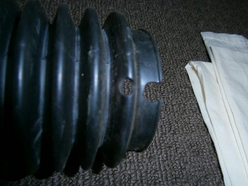

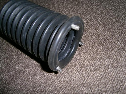

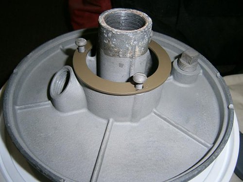

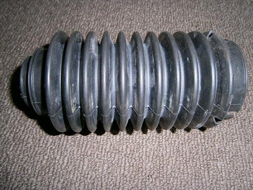

Default Vacuum Booster Replacement Boot
Some time ago, I recall one of our members mentioned that modern CV joint boots could be made into an acceptable relacement for the now extinct equivelent on the vacuum booster. Unfortunately I don't recall where I saw that written or who I have to thank for that idea. Whoever you are, you are a lateral thinking genious! 'God Bless Ya' to your Mother. With the idea in mind, I bought one of those 'generic' boots that taper at both ends. The ones where you cut off the excess until the ends match the size for your job.
Name:	Booster cross section - page from manual.jpg
Here's how the original looks. I have never seen a usable original boot, and all the ones I have now resemble the texture and pliability of cheese, hence the need to substitute!
Name:	Booster boot 1.jpg
This is the bare front plate of the booster. The new boot will be attached to the three screw holes along the ring which is about 1&1/2" from the centre tube. It willl need to seal tightly around that rim, or it will not work effectively.
Name:	Booster boot 2.jpg
This is showing the metal plate that bolts the boot on. I painted mine green when I was doing other stuff. It won't be seen at all, so you can paint it orange if you want, no-one will know
Name:	Booster boot 3.jpg
Here is the CV boot once I had cut off all excess rings from the ends. It will be a perfect fit for my needs. I got it from 'SupaCheap', but I would wager all auto parts stores will have them. Sorry, I didn't keep the plastic bag it was in, and can't quote the exact part. Don't get too interested in the holes you can see, just yet. They look to be in very odd places, until you get another two steps along.
Name:	Booster boot 4.jpg
As I said, the holes look to be in strange places, but heres why. The holes furtherest from the end will be where the attaching screws go through. The holes at the end will allow access to the screw for tightening. I did consider NOT punching the access holes, but if you don't, the rubber sits abnormally high when fully assembled and I didn't like the look of it.
You shouldn't punch the holes just yet. The next posting will explain why.
Cont'd...
  #680
Old 01-09-12, 14:02
Default Vacuum Booster Replacement Boot - Part 2 of 2
Name:	Booster boot 5.jpg
Slip the securing ring onto the rubber boot. If you have chosen wisely it will be a nice snug fit, even at the end where it is not flared. If it doesn't look like this, either adjust the part i'm about to say next, or.............buy another one!
Name:	Booster boot 6.jpg
Move the metal ring onto the boot, one place along.
Name:	Booster boot 7.jpg
Here's the interesting bit. Fold the 'un-concertina' end part back over the metal ring. Get it to sit neatly. Make sure you are happy with where it sits as well as what it looks like, and make sure it sits evenly under the end. I mean the bit that will be between the metal ring & the booster end. It must sit flat and evenly, or it will leak. From what I have read in the manual, booster will still work, but not as effectively, and dust will potentially get into the space where the booster plunger shaft passes along. That would be bad. This is the step where I marked where I wanted to punch the holes. You can fold back a little of the rubber to find where the holes are in the metal ring. I used an awl to create a slight puncture at the correct location of all three holes, then removed the ring and punched to desired size with a leather punch. I think I used 1/4". Don't remember for sure, so check your sizing please.
Name:	Booster boot 8.jpg
This shows how it will look with the screws in place. If you wish to do as I did, and remove rubber from around the screw head, punch these locations in a similar way to the screw holes. I did them while the screws were in place and I folded enough rubber back over to allow access for the punch.
Name:	Booster boot 9.jpg
And this is what it should look like when finished. I intend to paint the metal ring & screws black, so they don't highlight that I stuffed up one of the 'cut-outs', around the screw head you see in this photo.
How's that for a nice little wrinkle? Cheap and very functional. Quite easy really! Pity it can't be permanently attached to the booster front plate just yet. The other end of the boot will have to be formed around the top end before this can lower end can become permanent! That's another story, for another day.

  #681
Old 01-09-12, 16:46
Default Brake Booster Boot
Hi Tony
Great how to substitute for a hard part to find. The booster boots are almost always shot.
Another suitable replacement that I have used following a similar process is off-road shock absorber boots. Which are easy to find seem to last well. The OD of the bellows on the ones I found allowed the retaining ring to slipped over and the mounting holes punched.
Here are a couple of photos.
You will note that the boot has more rings than the original
Below are pictures of the shock boot off.
WEB Shock Boot used as brake booster bellows.JPG   WEB Shock Boot used as brake booster bellows v2.JPG   WEB Shock Boot used as brake booster bellowsw.JPG
  #682
Old 01-09-12, 17:30
Default Booster boots
Hey Phil!
Mine has too many rings as well, but i'm OK with that. Especially if it gets me out of the proverbial!
Good fun too
I have several brake boosters, and it has taken all of em to donate something that the other ones had which was stuffed. The best one was found by a friend of mine & cost me $20. While it was 'sound', it had suffered from poor storage which had caused some corrosion in the valve shaft. Another one I cut a section out of both ends of the shaft to see/understand what was happening inside. This provided far more details than reading the manual!!!
I see your booster has the breather attached to the unit. Mine has the breather remote on chassis. Did you just put yours onto the booster body for testing purposes???
  #683
Old 02-09-12, 12:31
Default Very productive day.
Name:	Driver side tank painted 3.jpg
ID:	51845 Click image for larger version
Name:	Driver side tank painted 2.jpg
The second fuel tank is now painted. I'll put the stencils on some time during the week, as always, weather permitting. I nearly put off todays painting due to high wind speed.

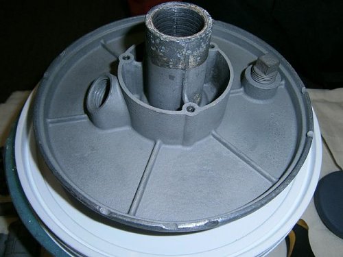

Name:	Vac Booster during 1.jpg
Remember I was intending to send the vac booster shaft & valve assembly for restoration down south? I made a thorough check of that part today and found the valves were in PERFECT condition. No perishing to the rubber seals and no corrosion to the inside of the tube or valve shaft. All it needed was a little cleaning! I did instal a new set of seals on the plunger itself. Had them soaking in oil O/N.
Name:	Vac Booster finished 1.jpg
After I painted the front cover and linkage fork, I reassembled the entire unit and connected it to the workshop vacuum (appropriate!). It works excellently and smoothly. I found when I held the fork end up and actioned the valves as if braking, it could lift its own weight and another 2-3kg besides (added some other parts and tried again). If fact, when trying to forcefully restrain the plunger from moving, I found I could NOT stop the action! That'll do me
Name:	Finished parts 1.jpg
Booster now added to the 'clean' pile of parts.
  #684
Old 02-09-12, 12:42
Default Vac booster - fiddly bits
Name:	Vac Booster valve mechanism 1.jpg
There are actually two more things needed to finish the vacuum booster. I broke the retaining clip that locks the valve action mechanism, and will have to make a new one.
Name:	Vac Booster adjustment end.jpg
Also, there should be a tiny little rubber boot here, to stop dirt getting into the valve shaft. I have NEVER seen one of these, even a rotten one. I have seen some attempts to make do with a crude canvas replacement, but i'm no fan of that, so i'll head off to the local toy shop during the week and see what thay have for R/C vehicles that can be used here.

Just completed a 'birthday' order for MacsAuto parts, including the battery hold down thingy. Mostly brake stuff. Those bits will be going onto the chassis ASAP, that is once I get it back and paint it.
I love the current exchange rate!
It is looking quite possible that I may do the blasting myself, in the engineering co. booth. I can do that on a Saturday when they don't normally use the blasting booth.
Won't be this weekend. It's the Gympie swap meet. That must come first!!!!
