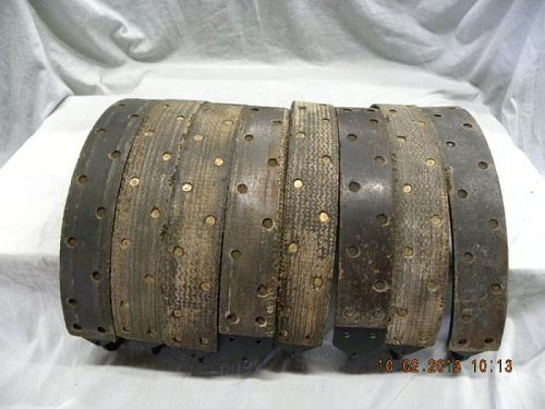

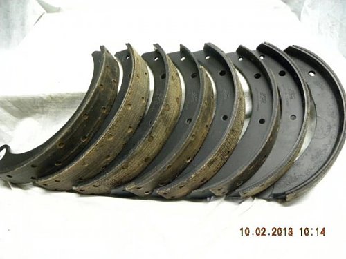

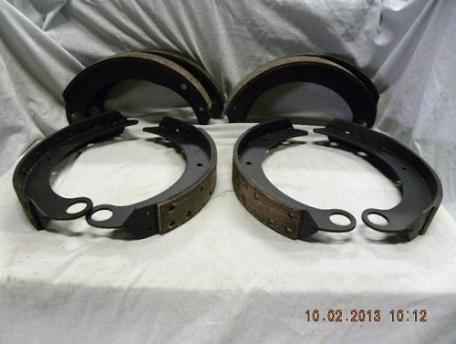

CMP brake shoes. I'm looking (and bidding, take note) at an auction on ebay for a quantity of Ford CMP brake shoes. The listing states "WW2 Military Ford Blitz Brake Shoes - full set", but to me they all look to be the same size and width. That said, I have not yet taken the front wheel hubs off, and to date, NEVER seen a Ford front brake shoe. I was expecting there to be a visible size difference in width at least.
Name:	CMP Brake shoes.jpg
ID:	54884 Click image for larger version
ID:	54885 Click image for larger version
The auction interests me because I know for a fact that there are at least two brake shoes missing from my front brakes. Wheel cylinders were taken off at some point. Not by me! Presumably due to pads sticking to the hub and making pushing the vehicle around very difficult. With cylinders off, the shoes fall together.....no more pad to hub problems.
If the front and rear brake pads are identical (that's my question, by the way), I can use pads from my spare rear axle instead of hunting for front ones.
Still wouldn't mind the ebay ones. Would be handy to get a set relined as spares for the future.

Answer to your question is on page U-9 in MB-F1.
It all depends on what axles you have.
Robert Pearce.
  #942
Old 16-02-13, 02:15
Default Shoes
Tony, by the look of the shoes in your pics they are all the width for front brake drums as fitted to axles with the 4 7/8" steering ends which were used on 15cwt and early CMP front axles. They won't fit the rear at all. Vehicles with 6" steering ends had the wider drums.
If you look at your brake drums, if the front are as wide as the rear then these will be of no use to you at all.

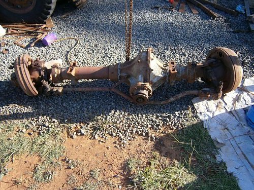

My front brake hubs are most definately narrower than the rear, which poses more questions than answers. My chassis was 'reduced' to 115", so it must have been longer, correct? If it WAS a longer chassis, and assuming the writing under the hood lid which was "60L/1942", is original (and I believe it was, based on script and condition of writing) then my front axle should not be the F15/F15A/F30 type?!? It is though. Can you confirm I am right or wrong from the following two photographs, please.
Name:	Front axle assembly 1.jpg
ID:	54904 Click image for larger version
Name:	Steering joint 1.jpg
Jacques, thanks for the offer, but I have a second set of 3 1/2" on my spare rear axle assembly. I'm confident the front ones will be 2", though not fully understanding WHY they are. Some axle swap in the past, most likely.

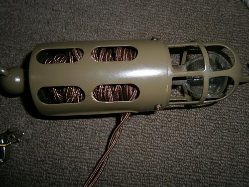

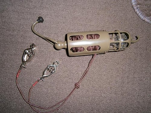

Bought the remainder of bolts needed to finish assembly and installation of pintle. Some parts yet to be painted. Thats tomorrow job #1.
Bumper brackets are also to be painted, thats tomorrow job #2.
Name:	inspection lamp assembled 2.jpg
ID:	54906 Click image for larger version
Name:	inspection lamp assembled 1.jpg
The new wiring for inspection light arrived wednesday, and I finished reassembly last night. I managed to knock a few bits of paint off, while man-handling to 'encourage' two parts to come together, so it will need another lick of paint tomorrow as well.......job #3!

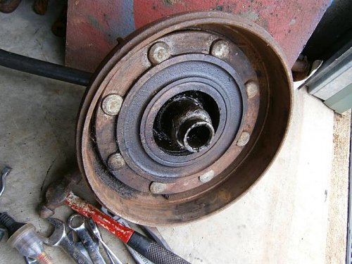

Took driver side hub off. Easy enough! Took out the brake shoes. Easy enough! Notice my brake shoes don't have the lining along the entire length of the shoe? Why is that?!?! The ebay ones are getting more and more attractive.
I REALLY wasn't expecting the the major problem that I came across next.

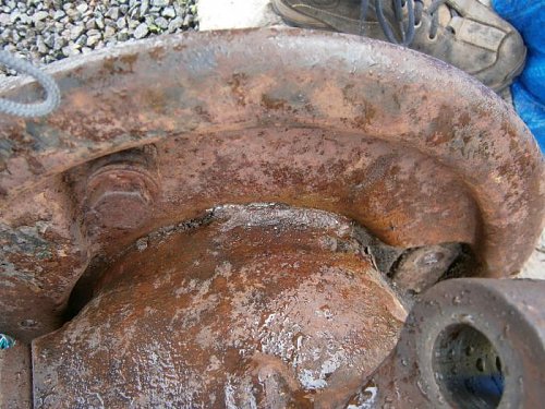

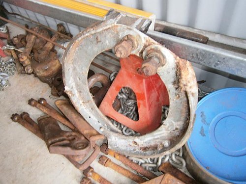

Some berk has welded the brake backing plate to the steering body, in two places! Great welding. They really should be congratulated for that. Pity they chose to showcase their abilities on MY TRUCK! This discovery puts a HUGE barrier to the way I intended to work on these parts. I really can't sandblast backing plate safely while it is still attached to the other part. And if I don't get it off, painting the two parts together will be a nightmare too. To remove the 2x welds, I will need to buy a special air tool that can take burr bits, and spend christ knows how long removing the weld. The good news is that wheel bearing and cup look to be OK, and may not require replacing. Guess i'll sleep on the weld issue.

Default Brake lining size difference
Tony:
Tony,
On almost all drum brakes with the wheel cylinder at the top the leading (front) shoe always has a larger lining on it. The trailing (rear) shoe always has a smaller lining on it. The front shoe provides most of the braking force when going forward. The drag between the drum and linings tends to apply more force to the front shoe and less to the rear shoe when going forward.
In reverse, less speed is achieved which means less braking force is required so the rear shoe has a smaller lining. If the linings were the same area as the front ones you would get "reverse whiplash" when you touched the brakes driving in reverse.
F15-A 1942 Battery Staff
Jacques Reed

Default Ford CMP truck brake linings-asbestos
As per attached photos the name "Raybestos" on the inside of the linings says it all. It can also be seen faintly in the genuine Ford lining
I decided to remove the linings as per a previous post before I moved them on.
A 34 C degree day is not the best time to be wearing a spray painting mask while doing this but if I stick them back in storage they will remain there for another few years until I get a roundtuit.
Interestingly the used linings which appear grey in colour are the ones shown here so they don't have to be green to contain asbestos.
Jacques Reed
  #956
Old 18-02-13, 05:39
Don't they look enormous by themselves.
A friend of mine who passed away some months ago, had a great stack of these in a heap under his house. All unused, and perfect in every way, with exception of being asbestos.
Raybestos are the brand of my wheel cylinders. As with most things, cheaper to buy from other side of the planet, as opposed to local suppliers.
I was fortunate enough to get a piece of NOS door-check strap, to replace my hard old originals.

Default Welded backing plates
You may find that berk was a Ford Canada factory welder, or an army one. I'm not sure whether others have found this but a lot of the 4 7/8" front ends I have seen had the backing plates welded just like this. Fortunately my FGT plates have not been welded. Perhaps there is some information in a service bulletin somewhere.
  #958
Old 18-02-13, 10:51
Default Welded brake backing plate
Why would they do that?? How does it benefit? I don't get it!
The bolts were there, so it's not that they couldn't use them or stripped any threads. I did a quick look, but I didn't see the same weld on the other side. I will go through the service bulletins book to see what I can find out.
The mud flap frames are now with the upholsterers, and I may have them back by the weekend. I will need them back fast......so they can sit on my shelf for months . I won't have a use for them until the cab is on the truck and guards are attached. Bearing in mind the engine, gearbox and transfer case will be finished before this happens, it may be some time yet.

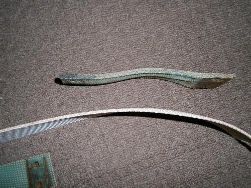

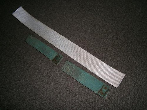

Last thing I did yesterday was to cut some lengths of metal bar, to be bent into new spring set brackets/clamps. They went to the engineers this afternoon. Apparently their metal folder can't handle the shape they will need to be bent to (54mm base, with 75mm height to each side) because the two folds are so close together. They will have to use oxy-acetyline torch to heat and bend by hand. Just like the old days, except no forge involved.
Name:	Door check strap material 1.jpg
ID:	54985 Click image for larger version
Name:	Door check strap material 2.jpg
This is the piece of check-strap material I was given today. It's wider than the original, and very slightly thiner profile, but I don't care. Exact match for original material has eluded me entirely so far. The thicker strap may actually allow me to add a third hole to the securing points on door & cab frame. If I do that, I will have to make fresh securing plates.
