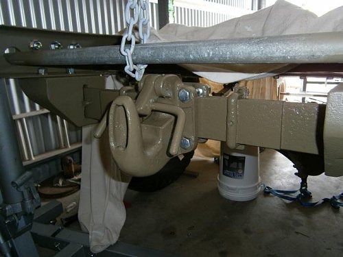

Here's the old girl (future project) 1943 Cab 13. The front spring bracket is different then yours. It has the extra hook on the bottom. Has anybody have any ideas why?
That is a very late production modification, I've only seen a couple like that here in Australia. I would imagine it would have something to do with anchoring a vehicle either for shipping or winching.
Does yours also have a different to standard gearbox cross member? One of those I saw with that type of spring hangar also had a F15 type cross member rather than the one where the gearbox bolts into it.

Thanks for the info. When I get home tonight I'll check and see if I have any photos. If not when the snow melts a little I'll get in and crawl under her.
Keith, I'm certain it's for winching, I distinctly recall seeing a diagram when we were kids, showing the use of scotches on a Cab 13 FAT. A chain (or cable) is attached to the scotch plate under the rear wheel and hooked onto the spring hanger, anchoring the vehicle for winching forwards. A similar arrangement was shown for winching rearwards, with the scotch plate under the front wheel, but I can't remember where the other end of the cable was hooked onto.
I always thought it was rather clever - the scotch plate has a "spade" underneath, which is forced into the ground as the vehicle is driven over it until the chain is taut.
As you say Keith it must have been a very late mod, because they're extremely rare to find. Here's one on a wrecked chassis I came across a while back.

...are illustration of how the scotches where tied to the truck in a fashion that allowed the wheels to be dragged over than held in place by the chain... it also shows where they were tied bu that may have been only for CGT...
I must admit I have never seen that extra hook on the front spring hanger.
The hooks are for winching. Page 31in driver's handbook for chevrolet 1945 describes the scotching methods. My father in law said they worked well until the winching became dificult and if you didn't stop in time you snaped the U bolts on the scotched axle.
Perhaps that's why they introduced the hooked spring hanger. All the force is taken by the chain, there's no force whatsoever on the axle.

First I don't think the hook incorporated into the spring shackle was intended for use with the winch or winch scotches it is to lightly built. The U attachments for the scotches are much much heavier 3/4 to 1" diameter and they need to be.
I've attached the scotches drawing from the hand book as well as some pictures of the scotches on my truck. The pictures with the cables were taken when I was getting the correct length. Since then I've had heavy cable with loops made. Strangely because of the placement of the frame hooks the cable chain combo need to be different lengths depending on you are put them under front or rear wheels.
I've used the winch and scotches a lot for pulling very large trees up hill. The winch unit is amazingly power full and deserves respect. When you put the scotches down on the ground and hook them to the frame hooks and move the truck wheels up on them and then start pulling, because of the scotch angles they dig right into the ground until flush.

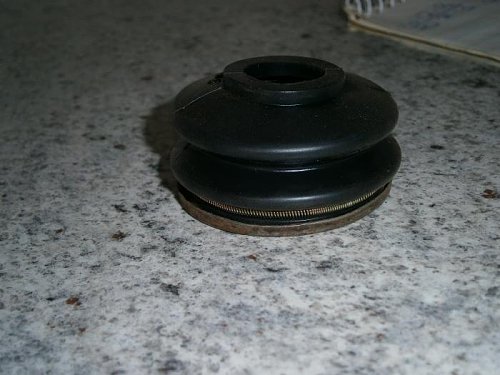

These are the replacement tie rod boots I was talking about.

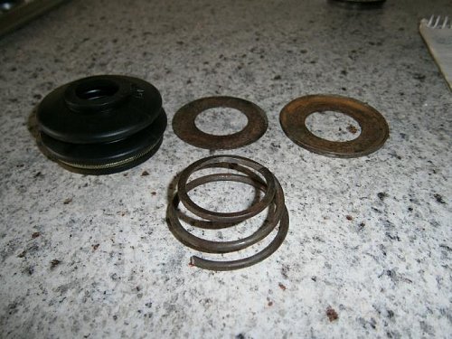

They are diffferent profile to original, but are a very good fit. The upper hole is quite snug through the tie rod bolt end, but will make for a good tight fit and sits really well. Using the original spring keeps the boot pressed to both surfaces. Just need to remove the short right-angled end piece (about 8mm long) on bottom end of the spring. I had already removed those before I took these photos, sorry. The two metal discs are from the original boot. One goes inside bottom of new boot, below the spring.
The boots courtesy of ebay at cost of $5.95 pair, from this seller in AUS: http://stores.ebay.com.au/suzukisupe...id=p4340.l2563
Part identification No: TE 8
Yes, this is similar to the FAT diagram I recall, although not quite as detailed. Note low position of front cable attachment point - well below the chassis rail, in the vicinity of the spring hanger. This is necessary to avoid fouling the step brackets, petrol tank and brackets (esp. longer FAT petrol tank), and battery box on RHS. This can be demonstrated by running a string line from under the rear wheel to ANY point on the chassis rail itself where a hook might be mounted. It may just be possible on the LHS of 60S and 60L CMPs, but definitely not possible on the RHS. I'm left to conclude that winching forward with scotches was not possible before the hooked spring hanger mod. Any thoughts....?
As Phil says the hook is not large in cross-section, being merely an extension of the ribbed reinforcement part of the spring hanger, which is barely 3/8" thick. However it's of considerable depth along the line of force, and a thick stiffener pad has been added in the casting. In order to fail it would have to shear through a large area of metal, something along the lines shown in pic 5 perhaps.
There would of course be a component of sideways force, since the scotch plates are outboard of the spring hangers, and this would be greatest with the FAT, due to the greater angle resulting from SWB. All in all though I reckon it would be plenty strong enough for a CMP winch, which are only rated at 7000 lbs. However I guess we'll never know, unless perhaps Ian will be kind enough to test his to destruction for us!

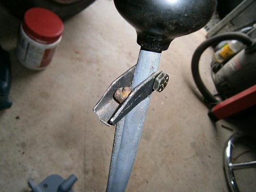

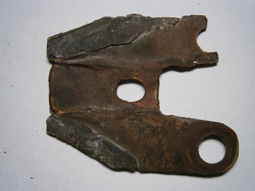

And that job was to make a new reverse select latch for the gear shift. I have three gearboxes, and none have a latch that's in one piece. One was, until a friend 'helped' me unload it when I got it home, and allowed the thing to fall onto the latch, squashing and breaking it!

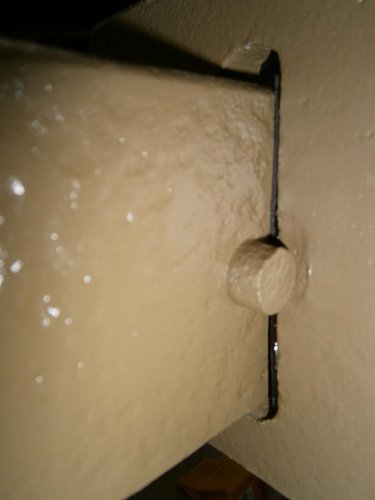

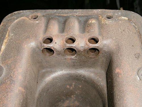

The final job for the day was to disassemble & clean the trans shift tower. This was frozen when I got it, and I discovered today that it was dues to an accumulation of dirt and other muck in the selector travel tubes. That's all gone now.

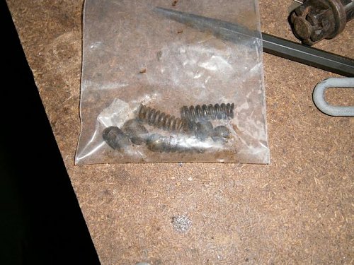

When I got the selectors out, I found one of the three plunger ball springs was corroded and broke in two upon removal. Checking through Macs catalog for replacements.

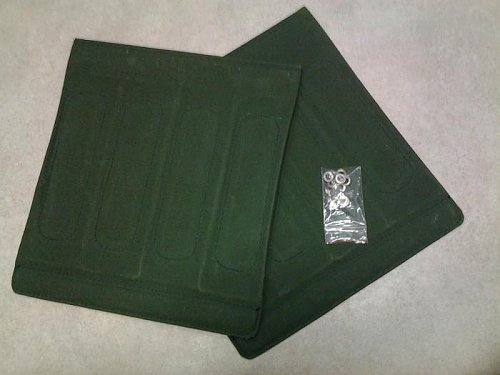

Called into the upholstery shop this afternoon. The new mud flaps are finished and they look really good. Only one of the two guys was there at work, the other fellow was kept away by flooding, on the other side of town. The chap that I spoke to said I could take the flaps with me, but he couldn't take the money at the time, because he wasn't the one who does the costing. I chose to leave em there until they are paid for. That will be after the water goes down again, which might be Friday. I'll post a couple of pics when I pick them up.
Now I need to make a second, shorter, pair for the front. I had originally thought front ones were the length that I made the current ones, but that does not seem to be the case.

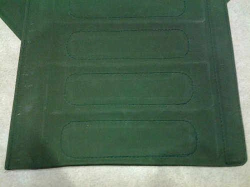

These are the fresh mud flaps. I still need to put the eyelets into bolt holes, but that can wait till I get around to it.
It's about time for me to start assembling some of the new bits that will be needed for the engine rebuild (not my job ). There are many Ford flathead water pumps for sale, but most are single pulley. I don't suppose it is a simple task to remove single and substitute double pulley on the same water pump, is it?
A google search has not been helpful in identifying any businesses nearby (~200km will do) that can do chemical stripping of engine block and heads. Not greatly concerned about this just now. The first thing that needs to occur is the successful removal of engine parts, while keeping each one labelled as to point of origin and orientation. I would be fairly safe in saying I will need at least 2 new cylinder sleeves. Two of the originals have a fair bit of pitting, and i'm not keen on oversizing to extent that would be required.
