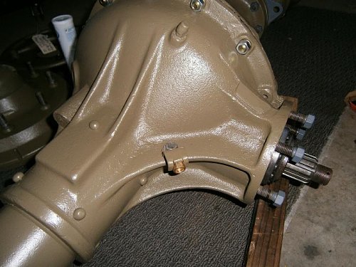

Working alone, figuring out how to lift and position awkward and heavy parts, here is the rigging for the front hub.
Shown here is the entire hub end hanging from engine hoist bar of chain fall.

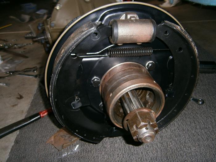

Default Hub Nut securing systems
Phil,
Your photos almost sent me scurrying off to the workshop with a flashlight, because I couldn't remember seeing large castle nuts, and certainly didn't take any locking plates off. Then I checked through all the billions of photos I have taken, and saw the castle nut type is what I have.
I do like your method of installing the steering ends.

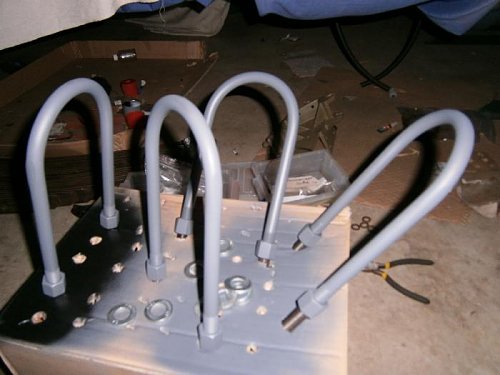

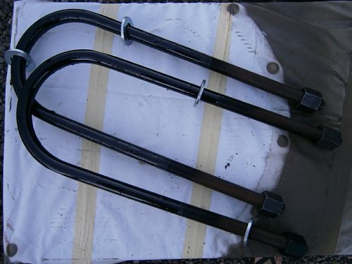

Name:	New U Bolts 1.jpg
ID:	57519 Click image for larger version
Name:	New U Bolts 2.jpg
I can do the same, because I bought new U bolts for the rear axle this afternoon. What has that got to do with easily installing the steering ends? Simple. Until I can permanantly attach the rear axle to springs, I won't trust the chassis not to fall, so my engine crane is attached to the pintle spring with a chain, just in case something slips. Once I get the U bolts painted and installed, then I can remove the engine crane, freeing it up to help reassemble front axle bits!

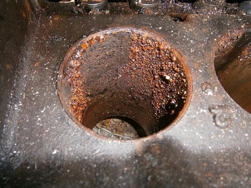

This afternoon I completed a 4 hour round trip to retrieve a large square plastic container, which I intend to use for stripping rust and other contaminants off ferous metal parts, in conjunction with caustic soda. The plastic 'cube' container is one of those which are often seen on heavy haulage vehicles. It sits in a metal cage framework designed to allow stackability and a degree of strength. I believe the approximate volume, when full, would be somewhere in the vicinity of 1000L........ish. While I certainly won't be filling the entire container, I want to have sufficient volume to immerse something the size of a gearbox case.
Some time ago, I was very impressed with what I could achieve when using a bath of caustic soda and electrolosis (or is it electrolysis?). I want to incorporate an electric charge in the use of the newly acquired tank, but have "LMF" when it comes to having a battery charger running when I am not able to closely monitor it myself. In fact, as we run almost solely off a stand-alone solar electric system, I wouldn't be comfortable with that scenario at all.
So here's my query; I have been giving thought to a somewhat unusual idea. We run the house on a solar collection system, so why not power the cleaning tank with a similar principal? Now, I don't know very much about solar panels, so I can't even be sure if the amperage would be sufficient. A supply of 2.5 to 3 amps should do, at least that was the current I used when playing with the battery charger all those months ago. Any higher amperage and the charger would cycle off & on, falsely detecting a high current return to the unit.
Does anyone have sufficient knowledge to offer some guidance as to whether this idea has legs or should be forgotten about?

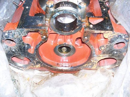

Old 31-05-13, 09:59
Default Engine Parts
My NOS valves arrived today.
Name:	NOS Set x16 Valves 1.jpg
ID:	57589 Click image for larger version
Name:	NOS Set x16 Valves 2.jpg
So did the new main bearings.
Name:	NOS Main Bearing Set 002thou undersize crank.jpg
Here are the recently arrived con rod bearings, STD size.
Name:	NOS Con-Rod Bearing Set STD size.jpg

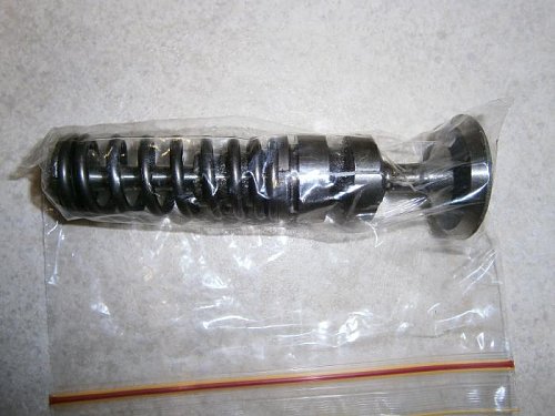

Couldn't resist making the first new full valve set. Only another 15 to go.
Name:	First new valvetrain.jpg
Normally I would do this inside in the evening, but if I start removing all the protective mucus from the valves on the loungeroom floor, I won't be very popular. My wife can't stand the smell of turpentine, nor does she like the cosmoline smell. Guess i'm waiting until tomorrow then.

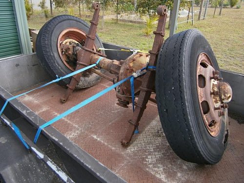

Default Spare Front Axle

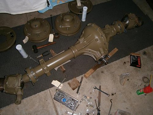

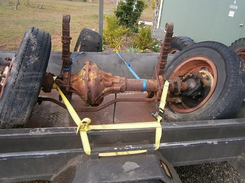

Yesterday I took some tools (no one you'd know ) and bought a spare front axle, as a 'just in case' for the future. A reasonable buy at $100.
Name:	Spare Front End 300513 1.jpg
ID:	57594 Click image for larger version
Name:	Spare Front End 300513 2.jpg
It was virtually unmolested, but has had replacement brake hoses at some time.
Unfortunately it doesn't have the lifting flanges that I wanted, so I continue the search for those.
Incidentally, One of the hubs was stuck fast to the brake shoes, and had to be removed for a cleanup before I could roll it to it's resting place. When I removed the hub cap I found that this axle has the same system of locking hub nuts as Phil showed in his earlier photos. That being; Twin hub nuts with a double layer of lock ring between, and a keyed washer installed before the nuts. There is also holes through the thread for a cotter pin and castle nut, so I suppose it could use that method as well.

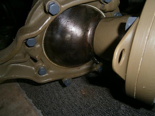

Default Front axle reassembly

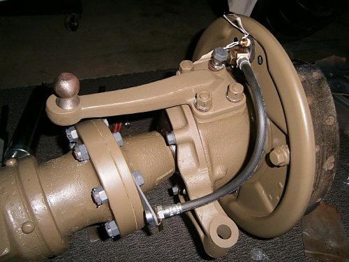

Front axle reassembly has started today. Wish it would do so without my involvement! I had hoped to have the whole lot back together, but what a hope I had. Not even close.
Name:	Front axle & steering reassembly 1.jpg
In this photo, you should be able to see the new felt seal in the steering joint. They've been soaking in oil for a couple of weeks now, and are a snug fit. No grease should be sneaking past this stuff! Turning the steering ends needs a little more effort since these were installed.
Name:	Passenger steering knuckle 1.jpg
The fresh brake junction block arrived last Thursday, with some other small brake bits & new intake valve seals. It came from MacsAuto. Now I need to start thinking about where I put the new brake lines I made some months ago! They're in the workshop somewhere.
Name:	Front axle brake junction block & bracket.jpg
I only had enough time to fit one of the brake backing plates. A test fit of the brake hose shows it will fit just fine. I was worried that the length I asked for was incorrect, but looks to be Ok. The primed bolt standing wonky of the steering arm is just sitting there. I had previously forgotten to strip and clean this bolt, so it's drying insitu.
Name:	Driver side front brake set 1.jpg
ID:	57872 Click image for larger version
Name:	Front steering reassembled 1.jpg
I had originally bought 2 tubes of grease. One for each side. Once again, what an under estimation. I sunk a whole tube full in each CV joint space, and i'm still not happy that there is enough. Fortunately I got cautious while in town Saturday, and bought an additional 2 tubes. Should have purchased a new grease gun, because the bloody thing wont pump properly as of about 1700hrs. I called stumps about this time, and downed tools. Try again next weekend!

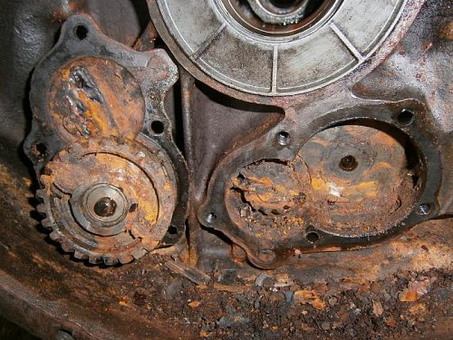

Default Engine strip down

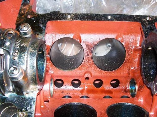

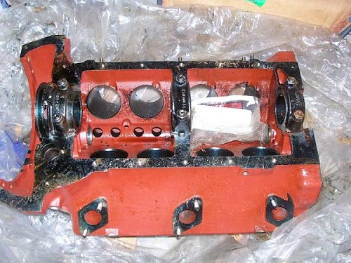

More work done on the engine strip down.
Name:	Bare engine bottom end 1.jpg

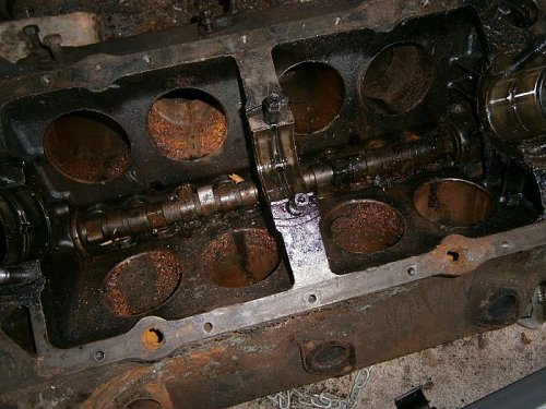

Pistons are out.They couldn't be removed without damaging several. Then found that they are unusable anyway, from sitting in cylinders that are severely rusted below the piston tops. Worse still in lower bore. Piston rods will not be reused, due to the force I had to subject them to while removing. No big deal there. I have a brand new set of 8BA rods that arrived on Friday (I saw this issue coming). New pistons & rings were planned originally so no great loss there. Resleeving is no longer desired, it's mandatory. I won't be overboring these walls. Besides, thinner walls means higher running temperatures, so thats not a good idea.
Name:	Cylinder wall 1.jpg

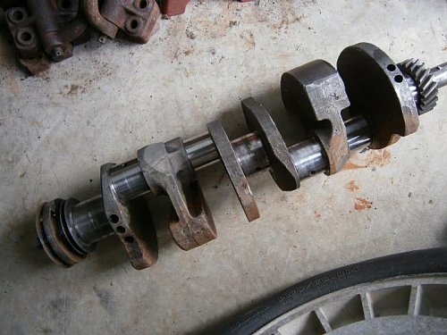

Crankshaft looks good. The mains aren't worn at all. Some wear at piston rod points and these will be ground down to 1.990", to accomodate the new con rods and bearings.

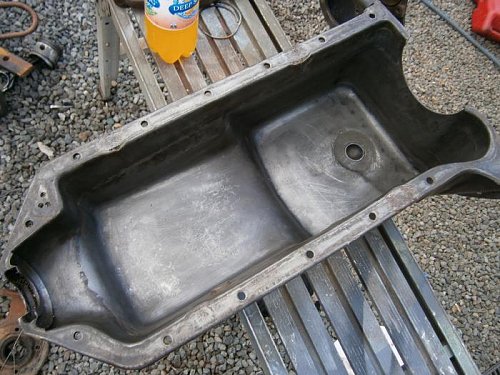

Cleaning of the sump is a most disgusting job. In the progress of which, I found 2x rust holes on one side, a small external crack (easily fixed) and a mysterious cluster of three small holes towards the front of the pan gasket surface. These have been deliberately drilled but seem to have no beneficial purpose! I'll get a friend to braze the rust-outs and I will weld the holes and the crack, myself.
Name:	Oil pan cleaned 3.jpg
This little nugget was unexpected. Finding something like this is very disappointing. On this engine, i'm now used to it! When I bought it, it was supposed to have been a 'good' engine to rebuild! Hmmmm. Well, it's mine now, so I will persist. If I discard this one, it'll just go into the scrap, and that would be a shame. After removing all the crud, the idler gear and cam gear are both rooted, but both are available.
Name:	Oil pump idler and cam gears 1.jpg
Can't wait to get the block crack cleaned & crack tested. It better bloody well pass! With all the new parts in it, this should be just about factory frest.
  #1106
Old 24-06-13, 14:42
Default Flathead V8 interchange questions
Can anyone help me out with answers to the following questions, please?
The questions relate to interchangability of early VS 8BA parts in general.
1) Are 8BA and earlier 24 bolt heads interchangable in relation to functional use?
2) Are 8BA and earlier front-mount water pumps interchangable between the two blocks?
3) Are oil pans different between 8BA and 99A or 59A?
4) What are the reasons why an 8BA block would not fit in a CMP? More to the point, an 8BA block fitted with all possible external parts of correct engine type!
I have come across someone selling a French made Flathead V8 block which may be better proposition to having work done on my old one. These blocks have some of the characteristics of 8BA, some of the features of earlier 24 bolt blocks, and some features which are unique to the French made ones, such as thicker main bearing caps and added strength and thickness of block webbing.
Any assistance with the above points, or other info on the French block suitability, will be very much appreciated!

Default Flathead V8 Interchange Questions
Hi Tony,
It looks like a new phase in your restoration is beginning. Very interesting. Good luck with it all.
There is a lot of stuff on the web about all this but you could start with
http://www.btc-bci.com/~billben/flathead.htm
and in particular
http://www.flatheadv8.org/bellhousing.pdf
also AJV8's catalogue gives a good comparison of part no's between the early and later flatheads.
Regards, Terry

  #1109
Old 25-06-13, 01:20
Tony, go to Vanpelt sales. There is a lot of info on their site.
Yes you can use an 8BA block crank and rods, and dress it with the earlier bits.
Yes water pumps bolt on.
You could go on the Ford Barn forum as well. Good info on distributors, carbs etc, along with the mechanicals.

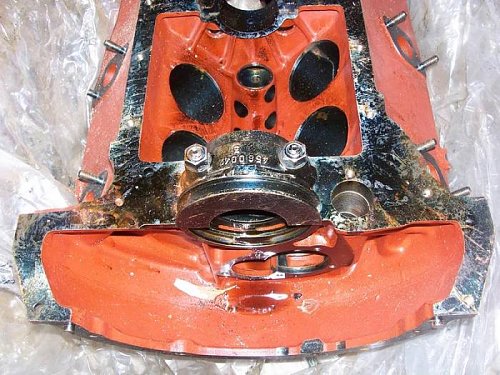

Old 25-06-13, 11:08
Default Thanks for the replies
Hi Guys, and thanks for the responses.
David, I did manage to get a couple of bags of washing soda, a couple of weeks ago. Well, to be entirely honest, my wife actually looked and bought it for me, from the local IGA supermarket. From memory, I believe it is Lectric brand. There's a little coincidence. It'll have a 'lectric' current through it some time soon, I hope.
Terry, the new phase you speak of will certainly be interesting, that's for sure. At least for me, as I stumble my way through all the pitfalls and rewards of engine rebuilding. One of the percularities (or however its spelt!) of the French blocks is that it doesnt have the seperate, bolt-on, bell housing. It retains the housing attached to the block, like the earlier engines. I believe the oil pan will require minor modification to clear the extra meaty main bearing caps & studs. It's a real hybrid of improvements on earlier blocks while retaining some of the earlier characteristics and ability to accept external add-ons. Every source I have been looking at holds these in high esteem. All going well, I will be able to evaluate this for myself, as I hope to get to inspect the block in person in next couple of weeks.
Lynn, I have looked at Vanpelt since your post, and am happy that this will suit my needs very well. At a whopping $3500, this block will eliminate a lot of the uncertainty associated with having work done on my old lump. The price is actually no dearer than the initial cost of these blocks if purchased in USA. Then the shipping costs would make the deal almost ridiculous, so the same price at my own doorstep is quite good. Price also includes a set of pistons & piston pins, so that is a little bonus the seller is providing without cost. I'm planning to take a number of the external parts with me when I go to look in person, and check the ability to attach them. Will also take the 'mike' and measure clearances for parts not yet purchased.
All in all, it's going to be a fun project. Even if I don't have any money left in the kitty for other immediate buys. Kitty will be a little constipated for a while.

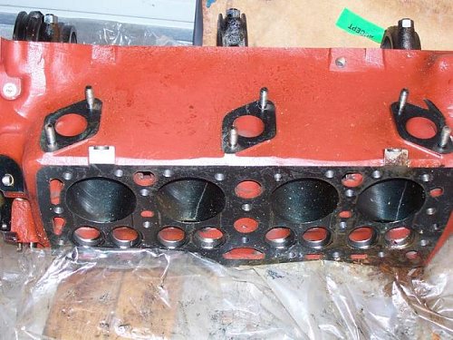

Here's a number of pics of the item in question.
