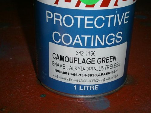

Default Ename 342, Camoflage Green, will do just fine!

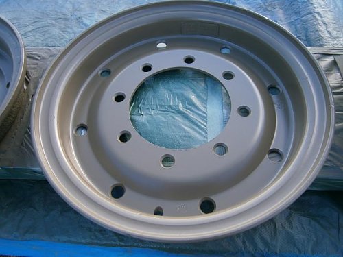

Firstly, the paint I was calling '324' is actually 342. So what, right?
Well, I'll need to know this because I will be ordering lots more of the same!
As with the previous Protec paint I tried, this one too is very easy to spray, but when they say "light" first coat, you better listen. I deliberately tried an area too wet first coat & had to pick it up off the floor, well nearly.
The finish 'off the gun' is first rate when instructions are followed. Giving good flow and high coverage. I gave 3 coats in total. It is possible to get too much orange peel, but subsequent coat/s can fix this if noticed early enough. The level of gloss is just perfect for what I am wanting, WITHOUT ADDING FLATTENING BASE! I did include hardener, and noted that paint was tack free in 10-20 minutes. It was able to take a hard press from my hand after 90 minutes without marking.
ID:	43010 Click image for larger version
ID:	43011 Click image for larger version
Despite covering really well, the enamel paint did not fill imperfections, but that also meant that wheel markings are still easily readable.
I did the painting out in the open, and today was windy, but for some unknown reason there is less dust in these wheels than I expected. I have had much more s%&t in paint when spraying in a booth! Fact that it's 'lustreless' helps hide it too. Use of a tack rag didn't hurt either.

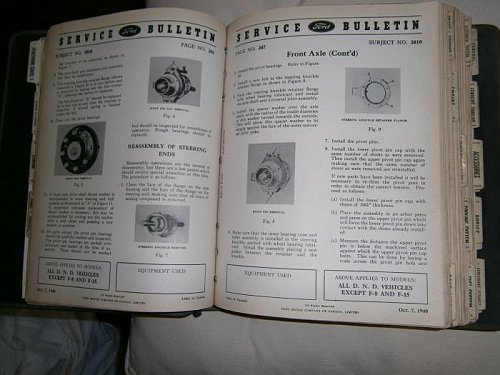

I bought this "Service Bulletins, Mechanical" manual on ebay recently. Covers 1939-1949 & lots of DND stuff inside. Nice embossed cover with metal edging for protection.

Auction listing stated expected "serious bidding on this item". This should have actually been the case too, but NOBODY BID but me.

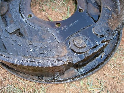

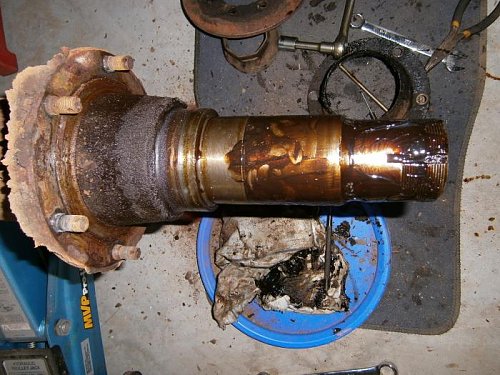

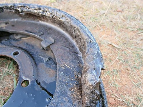

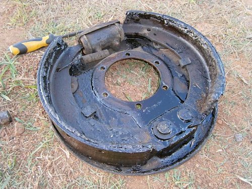

In stark contrast to yesterday, I managed to get a little done by nightfall.

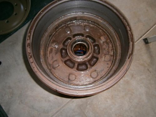

What I had initially believed to be an internal 'bearing' part stopping me from getting the hub off, actually turned out to be extreme gunk of 70 year old grease, dirt & ....well...god knows what. So caked was the brake shoes that it's hard to see how thick they are without all the 'lava' attached. Disgusting stuff. Thank Jehova for parts washers, where the bits will be resting until I can scrape the krudd off (K. Rudd, get it?).
Forgot to take a photo of the outer bearing components, which are in quite good condition. Bearings will both be OK to re-use, though lock nuts show evidence of treatment from someone who I wager didn't have the correct size tool to undo them & used a flat instrument against the nut to bash loose. Fortunately, I DO have the right tool, so no further damage today!
Spindle is smooth, and no defects found. I will know more once I wipe the excess grease off properly. Axle shaft OK also.
In this photo, the brake drum has already been treated to an intial clean. It took around 45min of cleaning to get to this stage. In places, gunk was 1/2in thick!
I thought wheels were heavy, but a greasy brake drum is even bloody worse. I'm feeling it in the back already. Even when I finish this side, there's still the other side to do.

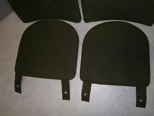

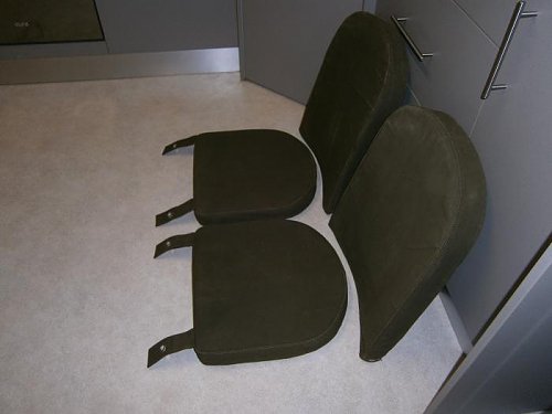

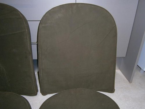

The major coup of the day was this set of seat upholstery, which I have now started to clean up. Seat bases will be sent to blaster on Mon or Tues & I should have them back by the weeekend. I have put the nose panel in for blasting last week & this is now ready for pickup. Nose will definately require some metal work, including plating of 2x holes, one each side where I suspect non original turn signal lights were wired or bolted.
I also bought some seat springs & rings, repairable left side guard, another cab step with brackets & was given a good speedo cable.
