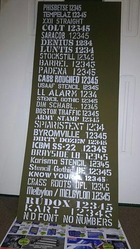

David, your stencil material arrived yesterday, and I will do a test cutting with it as soon as my new pinch rollers arrive. They are expected around this time next week. Certainly an interesting material. Very keen to cut holes in it!
ID:	77444 Click image for larger version

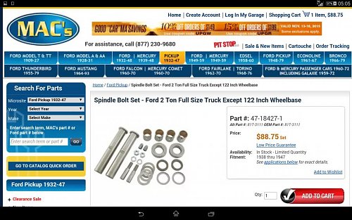

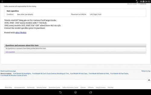

After looking into a number of options, my king pin kit (81T-3111) has been ordered. I broke my own rule, it's NOS. I did ask a lot of questions about condition before buying, so fingers crossed. Total cost = $95 including the postage. The muck you see on the pins is preservative, not rust.
Hopefully I won't have any problems with the kit, but even if I don't like the condition of bearing/s or felt seal/s, it is cheaper for me to purchase a pair of them new afterwards, as opposed to buying entirely new set from somewhere like Macs! Theirs are ~$90 + postage of $45. Ouch! All prices are in USD. New thrust bearings are $4.95ea. New felt seals are $0.95c each.

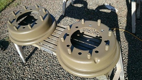

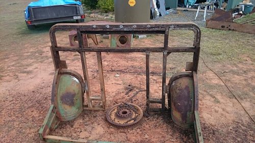

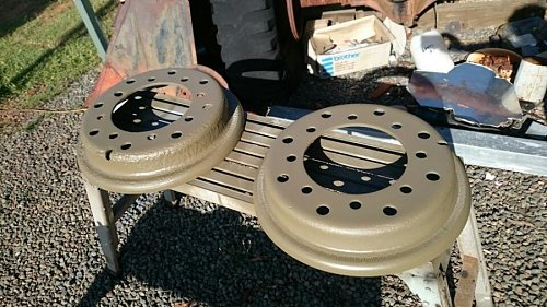

Default Finally started painting the wheels.....yay
The inside areas of my wheels are finally painted. Was in town this morning, and when I got home in early afternoon there was still enough time to splash some colour around.
ID:	77481 Click image for larger version
Normally the paint would be touch dry within a couple of hours, BUT this time I had decided to try the pre-packed pressure cans. Nah, it's not something I would go looking for again, unless there was a reason only a spray can would do the job. I can't imagine what that would be! Apart from having a sore 'trigger finger', my main issue is simply no hardener in the spray cans. I don't know what this will mean in the long run, but there is a chance the edges of the rims may react to the paint I apply to the outer surfaces. Sometimes enamel which has dried only a short time, can 'fry' when a fresh coat of paint (it's the solvent actually) hits it. Doesn't matter that it's the same paint, and this can occur without warning. Trial and error, im afraid. Hopefully nothing happens. I will sure be putting the coats on lightly as I can. I think if I put a light first coat (quite a good idea with enamel anyway!) and let it dry a bit, everything SHOULD be fine.

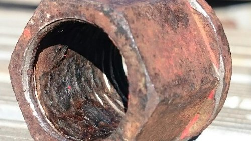

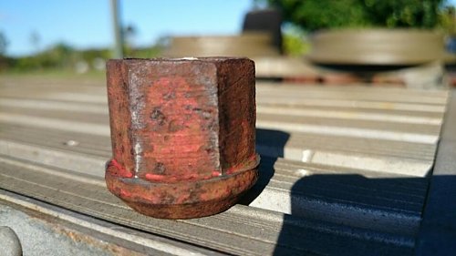

The rim nuts don't look too bad once cleaned of crap, do they? Hah, it's a trap! Read on...
I realised today I hadn't sent all the rim securing nuts to the sandblaster, so they needed my attention. I started cleaning them up while the wheel paint was sort of drying. I'll blast them myself, in my cabinet, but it's not a job I look forward to. Will be rather uncomfortably warm this weekend, so sticking my arms into elbow length rubber gloves is NOT attractive. I don't know how veterinarians do it! At least my arms only get stuck into a blast cabinet. There's no poo involved in that. .
This is the innards of the same nut. Not so great looking now, is it? Absolutely rotten to the point of having virtually no thread visible....at all. Imagine having 8 like this one holding the two halves of a fully inflated rim together. There WOULD be poo involved in that! I think I have a couple of spare nuts around somewhere. Probably somewhere 'safe', I expect.
Last bit of progress. I literally stumbled across the C & B cats-eyes I bought several years ago, so put them onto the gun shield before I lost them again. The 'safe' location had struck again. Searched all over the place when I wanted them, couldn't be found. Gave up, then kicked my toe on em. If you doubt things are currently that disorgainsed, ask Lionel, he paid me a visit today, while in the area. Always good to catch up with MLU bretheren.

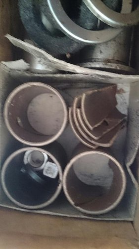

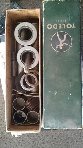

Default CMP king pin kit
It's heart warming to see that my luck continues to hold true.
ID:	77638 Click image for larger version
My NOS king pin replacement set arrived yesterday. Take a close look. Notice anything unusual? That's right, one of the bronze bushings is a 'some assembly required' item. Broken into 4 pieces, to be exact. Neither the USPS box, nor the Toledo Steel box that contains the kit, had been damaged in any way. I am therefore suspecting the damage didn't occur in transit. Seller has indicated they will rectify the situation, in some way. Don't know if I will be having to search for replacement bushings yet, but with my luck of late, that could very well be the outcome!
I tell ya, it could be raining gravy and I'd be the one caught holding a fork!

That's right, one of the bronze bushings is a 'some assembly required' item. Broken into 4 pieces, to be exact. . Don't know if I will be having to search for replacement bushings yet, but with my luck of late, that could very well be the outcome!
Hi Tony,
You might be able to get a replacement bronze bushing from a local bearing supplier or at least one that is close in size and can be machined and/or reamed to the size you require. The bearings places I have visited, often have a range of standard sized bronze bushings in stock or can get them in.
It all depends if Ford used off the shelf bushings or made up their own sizes just to be difficult.
Anyway it may be worth a try if you get no joy from the supplier.
PS: When I read your trials with parts and service suppliers it at least makes me feel I am no longer alone!

On a happier note, the seller of my king pin kit has indicated he will send me another bushing, so unless it gets lost in the mail I have a good outcome. As it turns out, the seller is a pair of Gentlemen who deal privately in vintage vehicle spares. The fellow I have been corresponding with is the younger of the Father and Son in Law team, and is a very decent guy to deal through. Quite apologetic and honest! Their motivation is the preservation of vintage vehicle, so I admire them for that. Kinda restores you faith in humanity.......some of humanity, anyway!

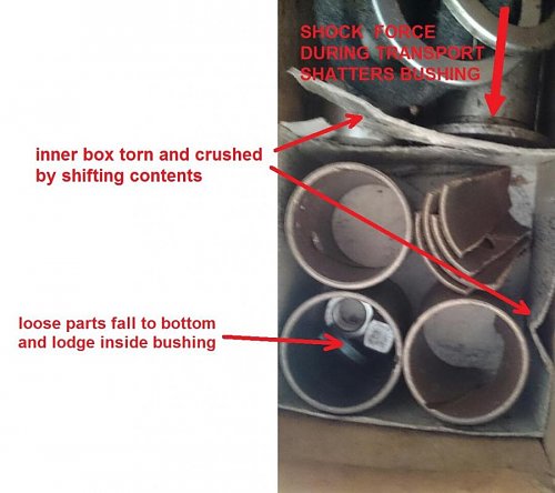

I disagree Tony. The outer box is fine but the inner box containing the bushes has clearly been damaged by shifting contents, some of which have lodged inside a bushing, and the heavy king pin has jarred into the side of another bushing, causing it to shatter. If the kit was transported upright with the bushes on the bottom, this would occur at the very first bump in the road! To my mind the seller is responsible due to incorrect packaging. I'm pretty sure Mr. Toledo designed the SQUARE inner box to fit SQUARELY inside the SQUARE SECTION outer box, so the bushings would be END ON to the heavy king pins. Plus of course he probably used a heavy cardboard divider as well. You may want to suggest this to seller.

The king pin bushes . I've seen some that are steel backed with a thin bronze lining rather than all bronze. I had some new king pin bushes made for my Dodge ute and the guy used brass which was too soft for the application . Some of these machinist guys are hopeless .
When I had 1/2 ton Dodges I went to a machining business and got some of the spring shackles bushed as they were terribly worn to a oval shape. They managed to stuff up the job and the bushes they fitted were out of alignment and it cost a small fortune at the time . That's why these days I do these repairs myself, buy a lathe ... its cheaper in the long run Mike

I put the lock washers and nuts into the smaller box, and some of the damage to smaller box would be my fault. I accidentally tore away a portion trying to get better access, to take photos. In taking a closer look at the packing of contents within the original packaging, looks like you are probably spot on about the king pins jarring on the bushings. Don't imagine Toledo Steel ever meant their goods to be thrown around in the manner of modern global shipping.
Seller said everything was OK when he posted it, and he does present as trustworthy. Bearing in mind what you have pointed out, sounds like just pure bad luck.

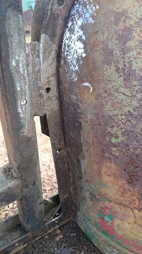

I was dismantling a surplus Ford cab yesterday, and found something curious. I'm far from experienced with these vehicles overall, but I have pulled apart 4 or 5 cabs at least. When removing the frame that holds the two window apertures, I found that there is a shaped solid steel block that slides up into each side of the window panel frame, and allows additional strength to the three attachment bolts that hold the panel to cab frame. I had my hands full yesterday, but will photograph the part/s I'm talking and post them if anyone is interested.
You will note I mention three bolts holding window frame to cab. Normally one of these bolts has shared duty of being one of the door hinge bolt locations, but not in this case. This cab is the one that takes the canvas covered doors, and there are NO hinges at all. The window frame isn't even one of the parts I was wanting to use. My motivation yesterday was to get the lower rear cab panel off for thorough inspection followed by sandblasting. Unfortunately (and I seem to be including that word in many posts!), that rear panel is in worse shape than I thought. I knew the steel sheeting was badly dented and has perforation corrosion in a number of places behind the lower angle iron section. I knew I wanted whomever gets the job of replacing the sheeting to avoid disturbing the door latching brackets. What I certainly did NOT know, is that the bottom piece of angle is so badly corroded that it has disappeared entirely in one area. Also, two of the diagonal bracing straps are rotten at bottom where they join the angle iron. Repairing the angle iron frame will be a big job. I do have a spare bit for that, but don't have any spares of the diagonal bracing straps. I feel another four-part trilogy coming on!
The main cab frame section seems to look OK, although I have no doubt all of the >65 bolts holding floor to frame will be reluctant to come away without some form or physical protest. This protest usually takes the form of bolt snapping, and for whatever reason, those bolts are commonly the ones that are very hardest to get to, for removing the caged nut!
With Bryce currently home, I'm only putting in token effort on truck, and that is timed for when Bryce is in town at the gym or catching up with old friends. All other times, spending time with him is most important thing. Bryce has said he will be happy to help me get the crank shaft into the flathead engine while he is here, and that will get done when he has free time.
One of the indoor jobs I have been working on, is to compile a list of stencil fonts and print them as a visual reference for selection in the future. I wanted something more than just a boring piece of board or card with some vinyl stuck to it....
ID:	78189 Click image for larger version
so I bought a thin sheet of perspex and stuck as many as would fit. Stencil fonts were stuck onto one side, and the rear side sprayed in my truck green. If you REALLY wanted to be tricky, the stencils could have been cut in mirror image and applied to the side that would get sprayed later, giving a very nice effect. I didn't dare try that, because I wasn't sure how the paint would stick, and didntr wish to see the paint react with the vinyl material. Krylon is one of the better spray packs to use, because it actually melts into the perspex (or other plastic/s) and fuses together. I don't have any Krylon yet. Another good effect would have been to apply stencils, spray entire steet (same side), then VERY CAREFULLY remove all the vinyl lettering etc.. This gives freedom to then spray further color onto the perspex, and when viewed from the other side, it looks absolutely faultless. Once again, that wasn't something I wanted to do at this time, but have made many high quality signs for business and advertising, when I played around with vinyl signage in early 1990s. Go a step further, using a translucent set of spray colors, and you have yourself a simle to make light-box sign.
ID:	78191 Click image for larger version
In future there will be more perspex sheets, to demonstrate some of the different effects that can be had. The RAEME logo and Winston Churchill portrait were cut from gloss white vinyl, and then the applicable white was applied onto flat black vinyl. The RAEME example shows white background retained, and logo becomes inverse. This is what you would want to do, if using the vinyl as a stencil mask. Obviously the background color would be applied (and let dry for 24hrs, or more) to the vehicle surface prior. Mr Churchills' portrait shares same Weeding of the white vinyl, but in this case the portrait lost it's impact entirely if the white 'positive' areas of vinyl would have been used instead. I printed two scenarios for Mr C. One as white image, with the only detail being the smaller areas of white only, and the second scenario as shown. When cut and displayed in the positive, where the subject would have been white on background of whatever..., my Wife didn't recognise who the subject was! When done the second way, he was immediately known. Funny how color can determine how we see something. E.g: Dazzle camo of ships. The second photo above, isn't very clear in subject, but if you look closely, you can see a small Invasion Star on left, without background color, and the other piece is one of my 9th Division identification signs. This one DOES have the flat black background. In this form, its a bit of micky mouse. I would expect all restorers would prefer to spray the black square onto the vehicle surface, then apply a stencil weeded vinyl mask over that, for spraying of the second color through. The stencil would then be removed entirely, leaving only two painted colors on the vehicle. No plastic retained at all!

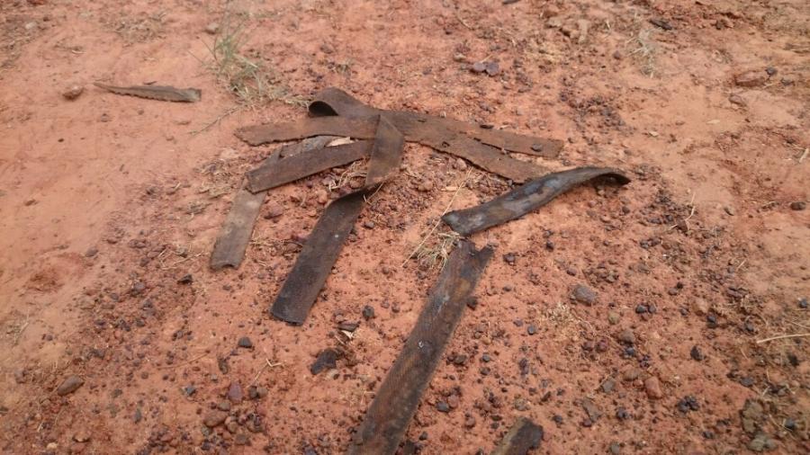

Default Ford canvas frame door cab now apart.
The canvas door cab is disassembled. In the spirit of previous work of similar nature, it was painful. Mostly physically. I lost count of the exact number of caged nuts I bashed away (took all of them off), but it is more than ten...in total. Right about now I'm REALLY wishing I had kept note of where I purchased the replacement countersunk flat head bolts I bought for the cab of green truck. I'm confident I would have mentioned that in a post a long time ago, in a galaxy.....
ID:	78266 Click image for larger version
ID:	78267 Click image for larger version
May be some perforation to wheel arches, but am not sure until blasted. The rest of the frame is OK. Lower rear panel is very badly corroded in the angle piece and panel sheeting.
Also the cross bracings are affected, with two needing either repair or replacement.
