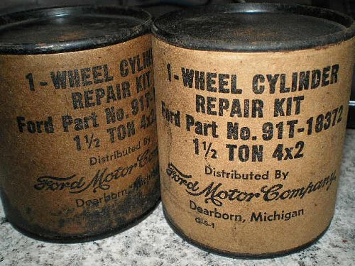

On a more curious tangent......can anyone advise if these wheel cylinder kits are suitable for Ford Blitz? It seems the only way to examine contents is to break the lid or side of tube. The cans are almost too neat to ruin. I'm inclined to just keep them for their novelty value!

Hi Tony - I would leave the containers intact as in that state they are quite collectable. Go for a bigger shed although no matter what size you get they always seem to fill up very quickly. You did well on the manual.

I agree with Bob 100% ..Bigger shed and leave the canned parts intact..worth much more and the rubber seals in the can have deteriorated over time so would be useless anyway ..leave the cans intact..

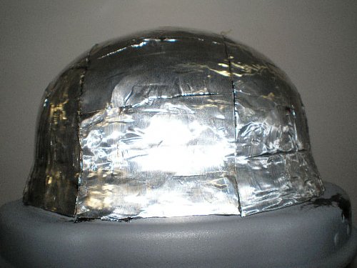

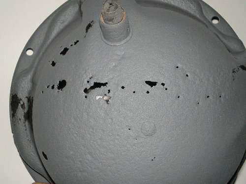

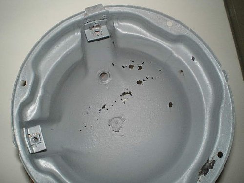

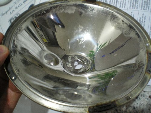

Default Sandblasting Parts
Took some small parts to sandblaster yesterday. They came back a bit lighter!
Headlight bowls were the worst. I was aware of two small rust spot holes, but wasn't entirely ready for what I saw when blasting was complete.
They quite resembled a sieve. Fortunately, I had planned for this and had a plan to remedy.
Examples of the extent of rust damage.
ID:	38328 Click image for larger version

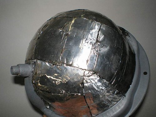

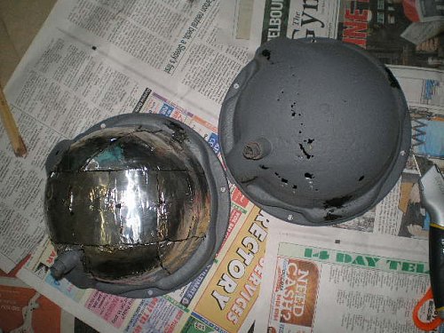

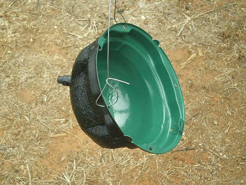

Using a tar based tape, the rear of bowls were treated with a layer over majority of the portion which will be largely unseen under the nose panel. While this is NOT my prefered method, I did not want to throw them away, even though I may have access to buy replacements. The tape will be sprayed with a 'stone guard' compound that should make the tape invisible. I will have to buy special spray gun for this step. Alternatively, a brush-on underbody compound would achieve the same result with less expense.
ID:	38330 Click image for larger version
You may notice areas of black already visible around edges. This is a bitumin based blade putty that actually dries to be tack free. I will be using this on areas I cannot apply the tape (eg: areas where I do not want to add extra thickness, so that installation will not be affected. It can also be used on inside of bowls because it can be painted without problems.
This is a quick before / after view.
Will be purchasing the material for final step today and pictures of finished product will be posted when I can.
Tony

Further progress with headlights. The ones I had bought Saturday provided useable reflectors, glass and several other small bits. The bowls - totally rotten and useless. Did get a good paint color sample from inside one though.

I tried to bring up the reflector surface without damage, but was unavoidable as disintegrating original sealer had landed on the surface and marked it badly. Quotes have already started coming in from suitable plating places in Brisbane. Can anyone confirm that these were originally plated in silver, as stated by one quote?

yes years ogo when I had some headlight relectors plated the electroplater recommended/used silver, he said chrome was to dark

Repro reflectors are available at Mac Auto in Niagara Falls New York.... with twin sockets for parking lights.
..... shipping might be a bitch.... heck you can even get them with halogen bulbs.... 6 or 12 v.
