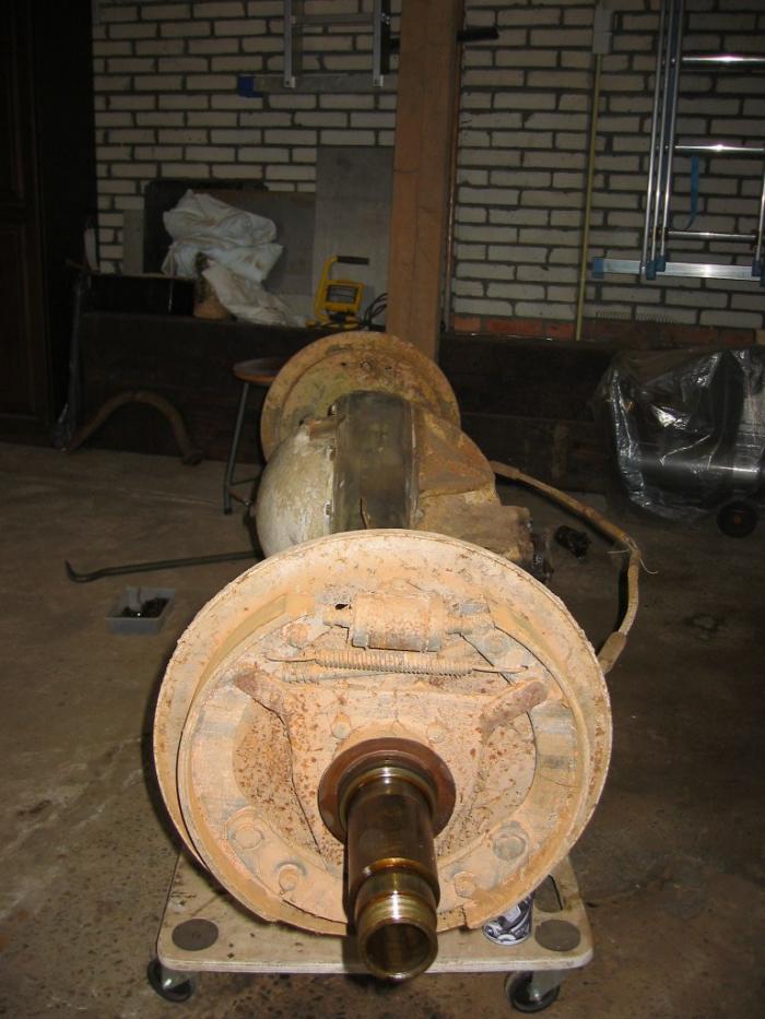

the next thing , the hubs came of and the brakeshoes to.
they where in quite a good state, only the shoes have to be replaced.
the hubs are not bad . the bearings were like new, only the seals nead replacing.

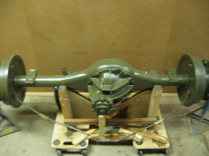

on the inside of the frame I welded small bolds for bolting on the fuel and brake lines, I put the frame a side to start on the rear axle. first I cleaned the dirt of it and then took it apart step by step.

keith nice to hear from you and nel and I see you in arnhem I can't wait to go. here are some more pictures on the rear axle. the brake shoes need replacing and the oil seals, but the bearings are like new. the differential was dirty with slutch so I cleaned it out and checked the bearings and checked everything. then painted everything green. so time for a
cheers jaap
achteras 05.jpg   achteras 06.jpg   achteras 06a.jpg   achteras 07.jpg   achteras 08.jpg
Old 30-06-09, 21:58
jaap de wit's Avatar
Join Date: Jun 2009
Posts: 163
Default more rear axle..
when the brake plates were bolded on the new shoes could be placed, it look much beter now and work beter to (then the old ones).
it was only a time eating job to get the handbrake cabel and lever in place.
sometimes you need 3 hand to work with, but it is done.
I sandblasted the rear hubs and cleaned everything and put them together. hen hey where ready to put on the axle and a just the brake shoes now I can see it beter. when the rear axle is ready the rear springs can be done.
achteras 10.jpg   achteras 09.jpg   achteras 11.jpg   achteras 12.jpg   achteras 13.jpg

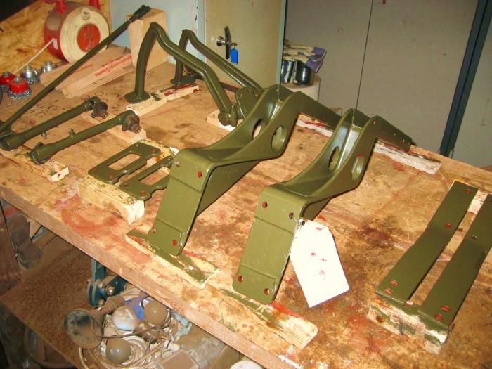

Now the rear axle is ready, the rear springs are next on the workbends.
I took them apart and cleaned all the rust of and primed them. I also did all the braces and bolts to bolt the springs and the axle together.
I tested the front and rear shocks if they work properly and then gave them the same workover as every thing else. so now I am a little bit closer to putting together the axles and frame but first some
veren achter.jpg   vr , ar veren.jpg   schokdempers.jpg   veerbeugels achteras.jpg

here some more pictures
