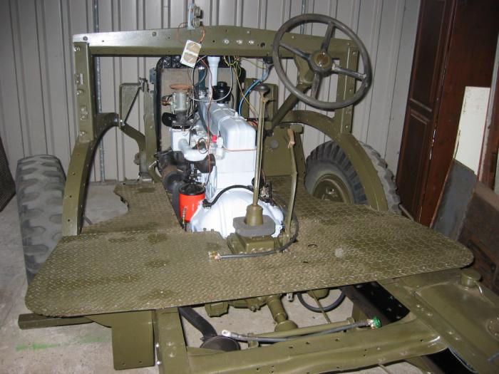

Default on my way to testdrive..
before I can make the testdrive there have lots of thinks to be done like...
the floor plates. I made the woodplanks of hardwood and drilled the holes in.
these are nessesary otherwhy's the floor is to low and hits the gearbox.
now it is time to place the floor and they are heavy, before you bolt them on you need to suffle them a littlebit so they are in place and then bolt them on.
next I will putt a seat and batterybox in place, but this next time....
cheers jaap

Nice job..... did you cut/make a new floor or was that the original..?
I plan to do the same as you on the seats..... I may use a 5/8 piece of wood instead of the 2 inch spacer to give me more head room for the beer belly.
Carefull you install a temporary brace between the steering wheel frame and the radiator support.... other wise the top hose is the ONLY support for the radiator.....if you cross a ditch the frame will twist and the rad support may hit the fan...... ask me why I know....
Good luck on the test run and take more photos.

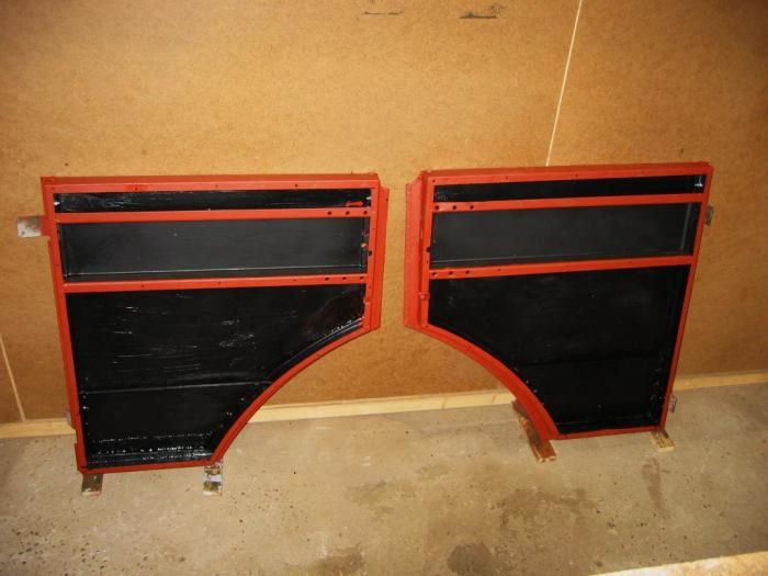

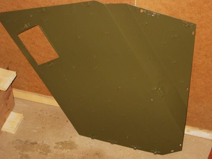

Default restoring the doors..
I used the original floorplates bob, they are stil very good.
and alex I don't now way the seat was shortend I am nearly 2 mtr tall and I fit in it so ? I putt the seat in and the battery box so I can make the test drive when the weather is good some day. for now I can show you how I did the doors last winter. the doors were rusted all over and on the bottom there where some small holes. so after sandblasting the doors I cut out the bottom part and welded a new part in, I also cut the inside bottom bracked out and shortend it 2 inch at the bottom so when there is water in the door by any change it can drip out of the door and not pillup and rust the door away.
I painted the inside with textiel paint and the rest with iron primer and when this was dry the green was putt on.
cheers jaap

so when I have to change the filter I take the back cover away and I can change the filter.
I can take some more pictures if that neaded just let me know.
hope this helped bob.
cheers jaap

Have you considered locating the filter in the original location..... horizontal... inside the frame under the passenger side.....?
Removing that engine cover can be a bitch even if only done twice a year..
Bob C.

hello bob yes I did considered to put the filter there, but I didn't see anything on that place that there was a filter before. and when you change the filter the oil leaks everywhere, so the place it's in now saves me a lot of cleaning.
now it is time to start on the making of a new dashbord because of the few things that were missing this was one of them.
I started with meassering the engine covers for the size and then bent a sheet of iron in to shape.
I instolt the covers themperary to fit the dash and then draw the squear holl on it for the gauge cluster to fit in. I welded some bolts to attache the gauge cluster to.
cheers jaap
