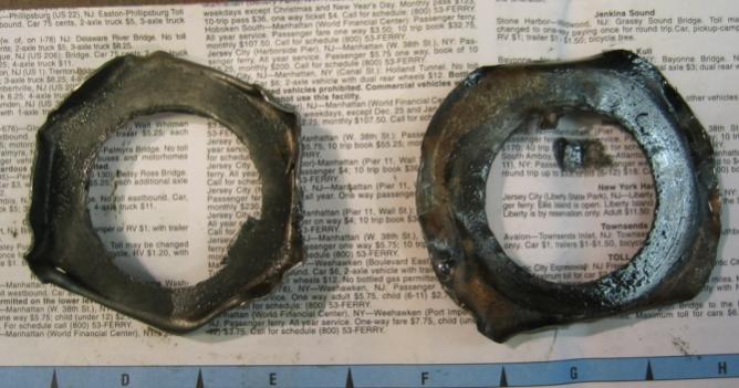

Default Up Date
Hi All
Thanks to all who have responded so far, I was wondering if Dirk might have them, but the problem was trying to address is finding a modern application for these that might be more readily available to all of us. These are an expendable item which (I have learned should be replaced every time the axle nuts are removed)
I'm working on a longer better write up of this experience which I'll try to post soon.
From the picture below you will see the right and left keepers both of them sheared off. Yes I made these up out of sheet metal. I spent yesterday trying to make replacements out of 13 gauge steel using the lathe and plasma cutter. So far I have not been able to produce a replacement that I will trust.
Total cost so far for all new seals bearings and races/cups is $325 US all the Timken part numbers are still good.
I've been searching the web for a dimensional listing which would be a match and while I can find the rear ones I have not found a source for the front. The problem being the diameter of the threads and the key way or tooth size.
In checking out the sources people have e-mailed me I am discovering some interesting things such as one major US sellers of old Ford parts uses the same catalog as one of the Canadian sellers with different headers and footers on the catalog page.
My next step is to check my other trucks to see if I need to be replacing the keepers on them as well and to confirm what sizes my trucks have. Once I've done that I maybe contacting Dirk and asking him to post me a bunch.
Please keep pondering on this while your at it check your own trucks, also think about the logic of why both would fail and why the left side nuts backed themselves off.

Hi Phil, as for the left side nuts coming loose on the wheel bearing the forward rotation of the wheel will tend to loosen the nuts. On the right hand side the rotation would tighten the nuts. That was the reasoning behind the left hand thread wheel nuts on the left side of CMP vehicles.
As for the tang shearing off the washer I have had the same problems when tightening the outside nut. Over tightening the outside nut tends to turn the inside nut slightly and shears off the tang.
I have no idea on where to source the washer. Any medium duty trucks that I have worked on have a flat on the spindle for the washer and not a tang. I will keep a look out on some of the industrial stuff at work for a washer.
Paul

The washer shown must have been off heaps of times as you only fold the tab over onto one flat each time, if you adjust the brg properly it will take years until it has to be redone, use loctite wickin 290 after final adjustment or threadlock when happy with result.

It is likely the inner tab was broken on assembly.The finish/ manufacturing style of the nut is a major factor
Some times the washer will turn with the nut rather than staying still with the inner race. This is enough to sheer the tab.
I would carefully lube the nut face of the washer, and leave the beaing face dry. The other thing to do is mark the washer where you can see it, to see that it hasn't moved after tightening.
A failing bearing could possibly turn the washer, tearing the tab off (if the inner race turns on the stub axle)The inner race, the lock washer, and the lock nuts, all turn as one.
I have seen similar set ups on other vehicles, where over time the preload of the bearings relax.the nut relaxes on the thread,(The bearing inner race wears the side of the lock washer away) and lets the lock washer become loose. The washer then flogs out the tab.
I hope this helps.

Im not familiar with this set up. I was speaking generally. Normally, if there is a double nut, the first nut is not done up tight, because after the lock tab goes on, and the second nut is fitted and tightened, the preload will be too tight.The reason for this is that the nut moves from one side of the thread to the other, due to the thrust from the lock nut. This increases the preload on the bearings. To arrive at the correct preload, we have to back of the first nut, knowing that the lock nut, when tight, will make the preload right.
This is when it is easy to damage the lock tab.

I actually don't remember if I installed one of the new ones or one of the ones I machined up? Or which truck as both of the Pat 13s have had the left front drum off since then. Will look in my special parts box and see if I used one or two. Strange I take pictures of so much but I don't have a final assembly photo.
Do know that I've added checking all four retainers on all three trucks as part of the spring servicing.
Which ever keeper used, sure that it has tab bent down to lock the nuts.
