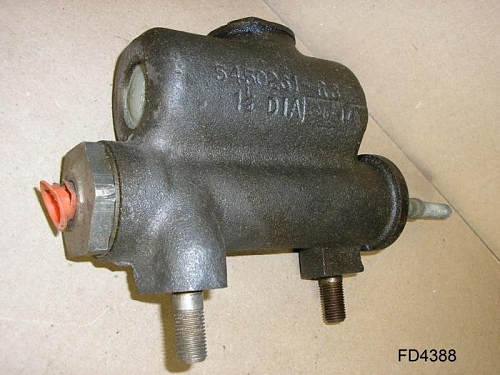

Tha listing is for a "NOS" Delco master cylinder. The photos show it to have part number 5450261 cast into the body, the parts book for the C15A shows the master cylinder as 5450260. It is clearly marked in the casting as 1-1/4" diameter and has bottom mount studs.

1946 Chevy 1 Ton truck NOS DELCO master cylinder
Seller: calponres
This item has ended with Buy it Now. US $99.00
1946 Chevy 1 T truck NOS DELCO master cylinder, 1 1/4" bore.

I bought it for the C8. Mine had some deep rust pits and the machinists wanted more than that to fix it. I had considered filling the pits with JB weld and honing it but now that can wait for the next truck.
