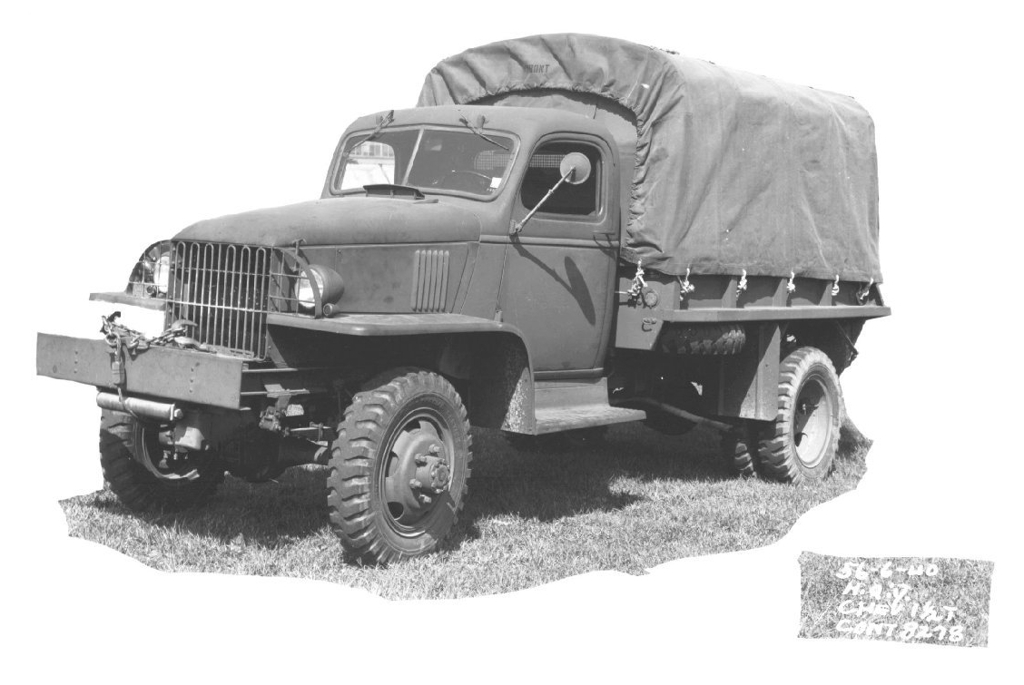

Can anyone confirm if the early 235 as used in the US G506 1,5ton trucks used the same bearings as the CMP 216?

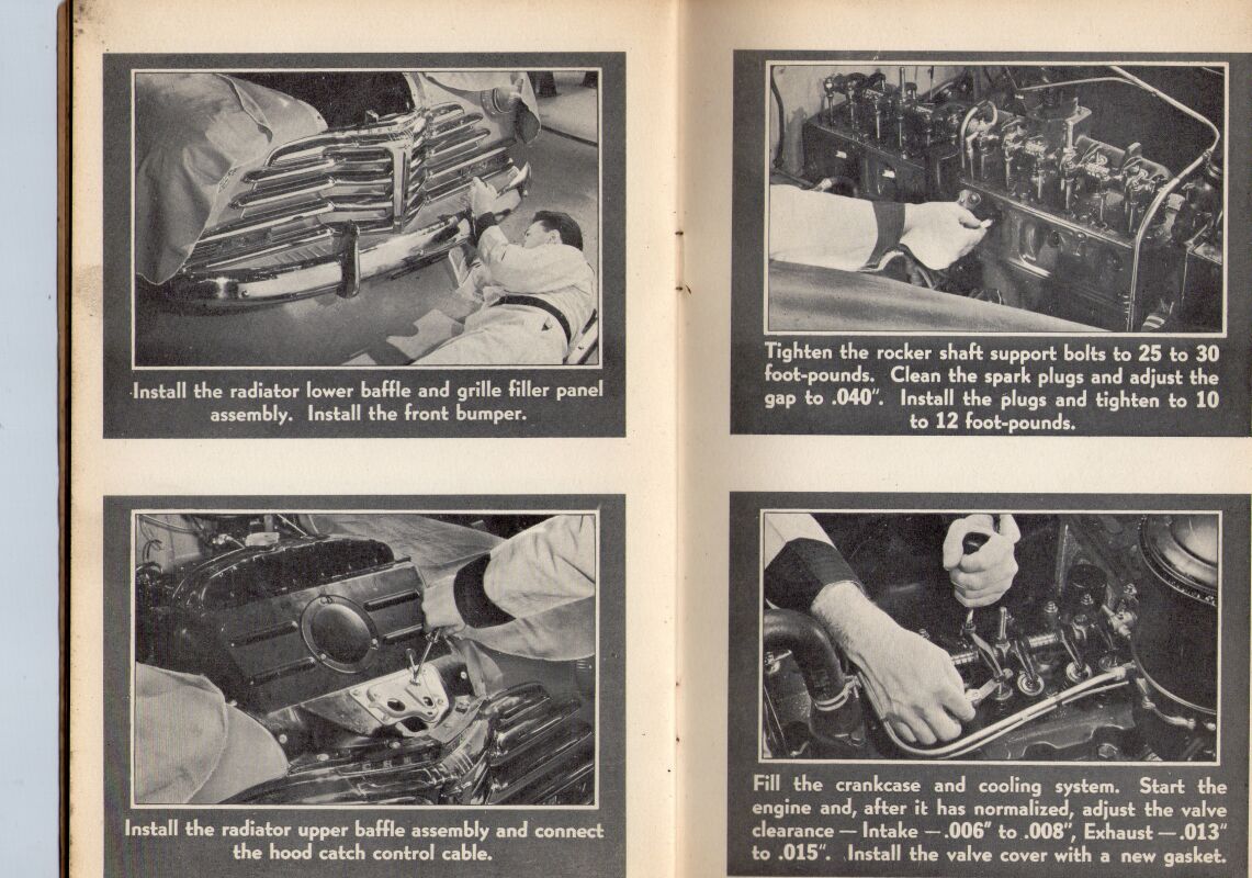

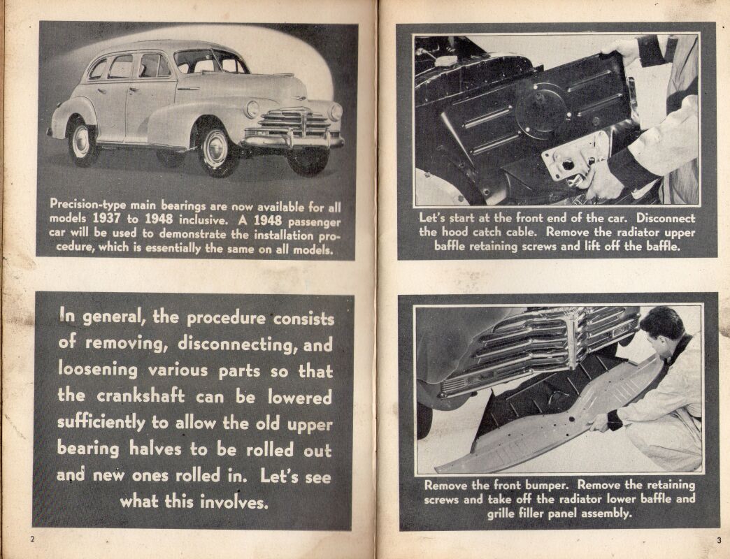

I have a little book published by GM , it describes how to install post war precision main shells in a early 1937 -47 Chev 216
The book consists of slide film pics ( eg from a lecture ) and a step by step procedure with the engine in situ in the car, a 1947 Chev sedan
I will scan the book and upload if anybody is interested

The first pages .
Old 28-10-17, 12:03
Posts: 6,017
Default ....................................
Old 28-10-17, 12:16
Posts: 6,017
