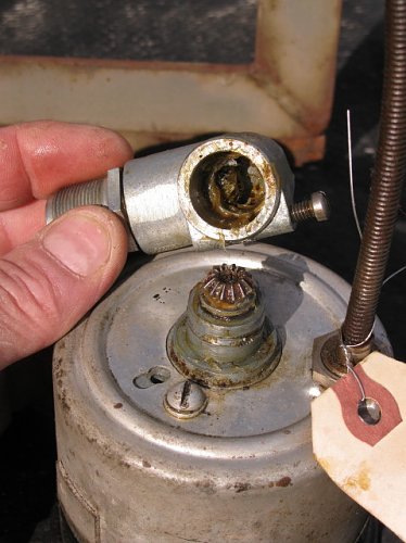

Marc...I am connecting the speedo cable in our carrier to the speedometer. The outer cable housing is intact as well as the speedo cable. However, where the cable fits into the speedometer, I don't understand how it turns to activate the speedometer. It would appear that the complete coupling needs to turn since it has a spindle gear on top of it that is connected via a small shaft and coupling that fits over the speedo cable. I'm trying to get the instrument panel in, complete with working speedo and lights, for Father's Day on Sunday. Please advise when you have a moment. Thanks

I got a phone call this week that the gears and adapters are ready. I plan on collecting them coming week. The machine shop told me that the second production run, if ever needed, will be costing more as it was more work than anticipated. But they stuck to their quote even do they lost money on this batch!
On your speedometer there is a little conical gear. You need an adapter that has a matching gear inside and slides over the speedometer. This adapter has a 90 degrees angle and the oposite side has threading for your cable nut.

I bought one of these adapters from Brian Ashbury, it is his picture, but discovered that my speedo already had one. There for it is surplus to me. If you need it you can have it at cost.

Thank you for the information and your kind offer. We were able to purchase a new speedometer and it came with the proper adapter plus the little pinion gear. I also have the same adapter and gear on the original speedo. (that was vandalized) Ross Williams gave me a call to explain that the pinion gear should freely spin and that its shaft connects to the end of the speedo cable. Outer coupling then threads onto the speedo cable cover. Both of my pinion gears are seized into the so I couldn't figure out how they worked. Now it is clear and I will free up the shafts and I should be all set.
One last question, how much of the opposite end of the speedo cable should protrude from the speedo cable cover coupling for it to fit properly into the brass receiver, just to the rear of the transmission? Regards, Richard.

I was a little bit in a hurry when I posted my reply yesterday. I did not notice that the previous two posts were from different Richards.
To be honest I have no idea how much it should protrude because I have not yet got a cable. But if you measure how deep the hole in the shaft of the gear is than that should give you a maximum size. Careful though! The little lug or notch on the inner cable end should not be hanging on the end of the slit in the gear shaft. But I would think the hole will be less deep than the slit is long compared with the inner cable end and the location of the lug/notch. You can easily check this by sliding the gear without the brass adapter on your inner cable. The lug/notch should not be coming to the end of the slit.

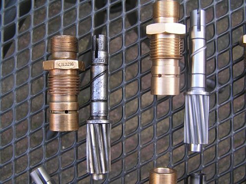

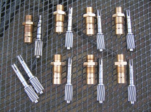

Picked up the parts today. I think these look very nice!
I will get a price on shipping and let every buyer know how much they owe me.

Your speedo drive parts have been reproduced and I would like to thank you very much for lending me these rare items. Do you need your parts in a hurry or will we meet at Beltring?

i am seriously impressed with the quality of the finished items Marc ! are you allowed to say who purchased them from you ? would be interested to know who we have helped out i need to triple check my dates for beltring but i really want to go...... would have to get the train down though..... will check with work and see if there are any slots of leave left.

So was I! They were made by a company that was founded in 1904. They are specialized in reproducing almost everything you can imagine that has to do with gears etc.

Hi, Those of you looking to re-commission your speedo's, bear in mind that connecting the drive wire to your speedo and expecting a NOS speedo or one that has stood for a number of years to start working correctly is an oversight.
Before you connect it up I would advise you first stip it down and check the mechanism is free to move or you could be disappointed with the out come, Brian Asbury advised me of this for the two NOS ones he sold me.
