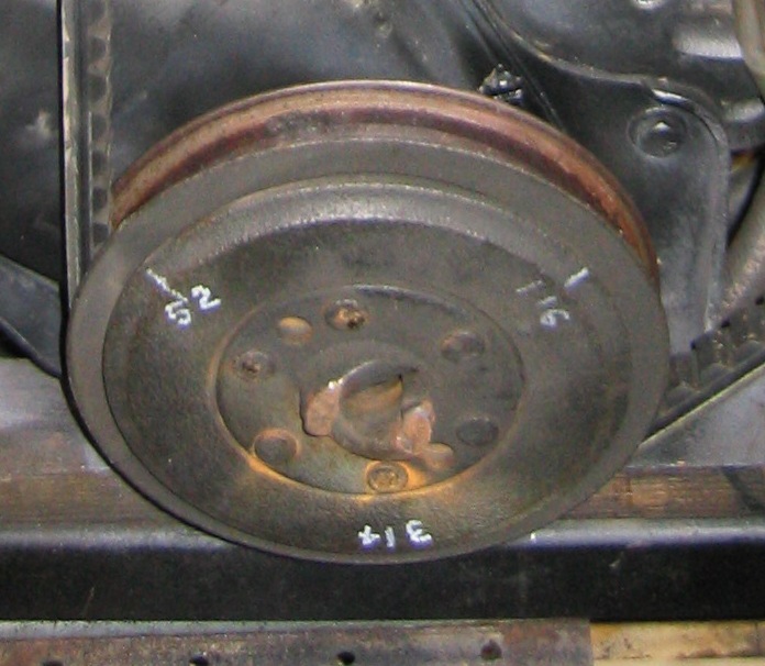

Default Relocation of Timing mark
Hi Bob
I've done just what you are talking about of moving the timing mark to somewhere you can actually see it. The little inspection hatch on the top of the bell housing. I just line the timing mark up carefully through the normal timing window behind the starter. Then with a lettering punch I make a corresponding "O" on the back of the clutch housing in line with a fine wire strung between the two bolts. See the picture.
Not really shown in this picture but something I've started doing as I resemble engine and clutch units is I paint two inches to on the advanced side of the timing marks both new on clutch and on the normal flywheel position. This really helps when the timing is way off to find the timing mark.
I have copies of this photo with my manual on the computer in the shop to remind me on which side of the bolt to wind the wire.

Hi Bob I've done just what you are talking about of moving the timing mark to somewhere you can actually see it. The little inspection hatch on the top of the bell housing. I just line the timing mark up carefully through the normal timing window behind the starter. Then with a lettering punch I make a corresponding "O" on the back of the clutch housing in line with a fine wire strung between the two bolts. See the picture...Cheers Phil

Old 05-01-11, 04:59
Posts: 5,267
Default Why the H*** did I not think of that....
Phil you are a genius......
....I actually set my flywheel on the pointer .....then crawl underneath to spray paint the flywheel black then draw a yellow line on it for TDC.....
....... now I will not have to crawl underneath anymore..... which is a good thing as I get older.....
I still can't believe it.....even smart ass GM engineers never thought of that....
Thanks a million......
...... as Rob said we will adopt you if need be.......

Default Glad you like that little trick
Hi Guys
Wish I could say I thought of that little trick the first time I timed my HUP back in 1978. No such luck. I'll have to find the periscope timing light made up out of plumbing parts on 90EL, Y joint and a mirror sort of worked. Or the next version mirror taped to timing light. But it wasn't until I had the third or forth stovebolt engine on the test stand that I started to really get smart.
But there is a further generation of thinking ahead, which I have done only on one engine, putting a TDC on the clutch housing and on the front pulley for each of the cylinders, this makes adjusting valves easier the one on the pulley lets you turn over the engine with the crank to the TDC for each cylinder to adjust the valve of course you still have to look at the valves to determine the valve closed position but if you remember the pairings you 1/6, 3/4, 5/2 it gets the job done quicker.
Copy of Cropped Timing Marks on pulley.jpg   Copy of Beauty Engine Swap 7-16-08  # 017.jpg

Old 07-01-11, 03:34
Posts: 5,267
Default You guys....
Resourcefulness and not knowing it can't be done are basic skills for working on a CMP.....
Phil
You could write a book on "how to...for CMPs" .... and maybe you should....
That modification to the crankshaft pulley is genius and surely related to the old index wheels we used on V* for setting valve cycles accurately..... using a boxful of various offset keys...once marked every 120 degrees you are set for life....
I still think that using the inspection hatch on the bell housing for timing is worth it's weight in gold.....

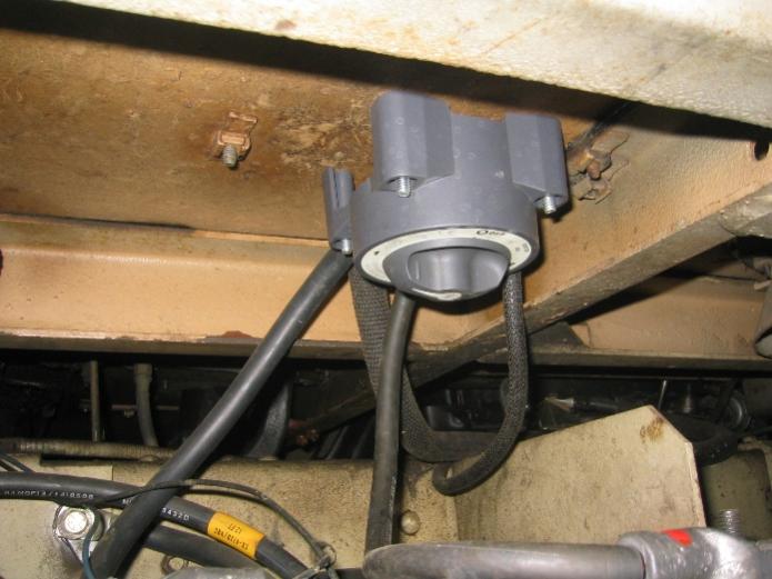

Old 30-01-11, 22:51
Default Battery Switch
Hi Guys
My solution to a battery switch when I put the 261 in BEAUTY the C60S was a marine battery selector switch rated at 500 Amps continuous, 1000 Amps for 100 seconds. In my case I found a dual battery selector with a both off position. It allows me to run the truck on 6 volts and charge the 6 volt battery off the generated. If by chance I should have a problem starting then I flip the switch to the 12 volt battery (for the radios) hit the start which really spins over on the 12 volts.
Location on the Pattern 13 is on the underside of the cab floor under the drives side. If you go with a 6-12 volt battery approach try to find of a selector switch which does not have a both position for obvious reasons. If you are going with the auxiliary 12 volt then run the power supply to instruments etc to the 6 volt side of the switch and only connect the starter to the output of the switch.
