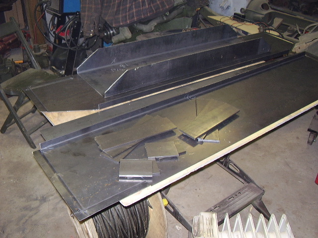

I have been "scratch-building" a tailgate. I fitted it this morning before carrying on with welding the hinge pieces then the bottom and side reinforcement portions. Ran out of mixed gas for the mig and since it is a holiday the "air" store is closed...should be able to finish it off tomorrow and then start "throwing" paint at it.
cheers
Mike Timoshyk

Posts: 2,323
There were plans for the rifle butt holder in Convoy Magazine, volume 7-1. I don't know if anyone has them available or if that issue is still available from Marc Montgomery. The Convoy plans show a butt socket that is deeper at one end than the other, surviving samples I've seen were the same depth at both ends. I can't tell if this was a change during production for simplicity or a replacement that wasn't built to "official" plan.
CAUTION: I've noticed that the Convoy Magazine drawings have dimension problems. Specifically, the insde dimensions plus the wall thickness stated do not match the outside dimensions given. I don't have data on which dimension is the problem.
Last edited by Grant Bowker; 06-03-09 at 17:45. Reason: Feb 17 - Edited for clarity and added information. Mar 6 - Dimension caution added.

Tell us about the tail gate...... did you copy from an old one...??
What gauge..? did you have the sub assemblies bent in a fabrication shop?
How expansive was the fabricating shop.....? I am trying to seduce a local shop here to do some small 12 and 14 gauge pieces for me..... set up is about 3 times the price of the steel. did you use mild steel of pickled satin coat......
How bad is your driver's door or is it missing altogether..?
Keep trucking......
Boob

I made a tail gate for a 2C4 box .I didn't keep the measurements but I could get them . I had a shop break the iron I needed and cut the rest in my shop with a plasma cutter .You have to almost be there when they do the breaking as some times they can get a little sloppy I would do enough in one chunk for all the peices of the same size and cut what I needed at home .George
George is hooked on OD
5 window DT969
8 ton Fruehauf trailer

Hi Bob and George,
I used 11 guage for the bent/broke pieces. I had a shop do the frame pieces and as George, I had them do just a couple of pieces and I cut them to size myself with a cutting wheel. Cost me $180.00 including material. Ouch...but...when ya gotta have it .... I copied a tailgate I located here in the city. It was attached to a 44 chev. I did make one mistake in the measurements...the tail gate is now 1"" thick as opposed to 3/4". "I should have measured twice and wrote once". I am not pissed about it, in fact one would not even notice it. The hinges I made from 1 1/2 cold rolled steel rod that was bored with a 5/8 hole which were welded to 1/4 flat bar. this was much easier than heating and bending them to form the loop. The skin is 14 guage. So far it has been very easy. I should be finished this afternoon and ready for paint.
cheers

Default more tail....
Here are a couple more pics of the "gate...
cheers
