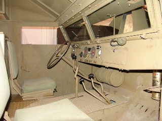

Here is the specially converted top of this Halftrack

Have to post em seperately they are too big, here is another. This one is of Col Wotherspoon(Left and the SAR Balttle Adjutant i believe), this is apparently a shot looking in to the ACV from the drivers door, might be tough finding a duplicate phone but hey we will have to find one.
Rob

Default The SAR Halftrack
Hi Guys,
Reg Hodgson and I stopped by the Armouries to check on the restoration of their Half-track. We had a great visit with Sgt. Rob McCue. It's nice to see a part of Canadian history being restore, by this dedicated individual and his team.
Al
