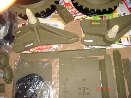

Default More pictures of renewing parts
Hello,everybody,herea are some more pictures of my restored parts
(this time, upper armour of engine cover,frame for it,brake plate,other view of rear axle.)
I hope they will be of some interest for all of you
Have a great day
Patrick Willem from Tilff Belgium
Old 12-07-08, 09:08
ron ron is offline
Posts: 1,294
Default Restoration
Hello Patrick,
Thank you for sharing your progress with us here, its all looking good, keep up the good work,and please keep posting the pics of your progress,
Regards, Ron
Ron Winfer
Old 12-07-08, 15:04
Stuart Kirkham's Avatar
Join Date: Mar 2007
Posts: 268
G'day Patrick
Fantastic quality of workmanship. Just for interest sake, what are you referencing (workshop manuals, photos..) to obtain correct paint codes and authenticity etc?
