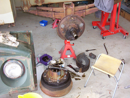

Thank you for your comments and I read the previous thread with interest. These seals are important as my brake shoes and drums were saturated in oil and grease rendering them useless. Images attached before and after plus refurbishing and stainless lining of the slave cylinders.
