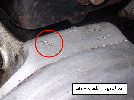

But the motorcycles for the last WD/CO contract (C/S3357) also had a gearbox with an inspector’s stamp. These late war Albion gearboxes have all been checked by inspector number 419.

... and this is the late war Albion gearbox. These motorcycles had two different inspector's markings: one on the engine and one on the gearbox!
