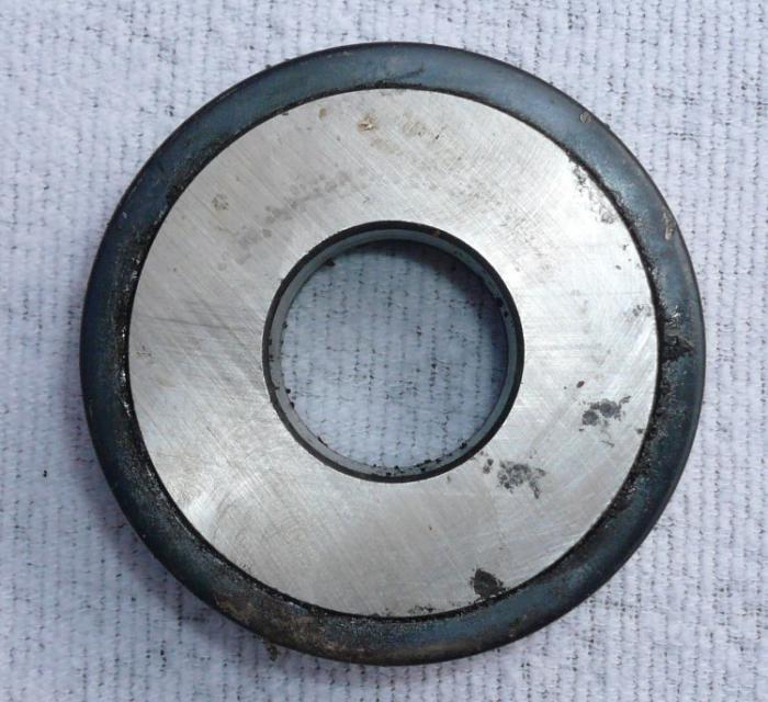

Please identify this bearing for me:
Marked "Ahlberg 928".
Measurements:
OD: 2.246"/ 57,05 mm
ID: 0.86"/ 21,76 mm
Thanks,

"Ahlberg 928".
Is this one of those elusive CMP king pin bearings?
Thanks,
Old 30-03-09, 01:41
I have just measured the Aetna 1570 bearings as having OD 2.212", ID .0875". The set of Aetnas we used in Bob Carriere's front axle were a snug fit both into the housing and to the axle pivot pins. In appearance the Ahlberg 928 bearings are very similar to the New Departure 928 bearings.
Thanks Grant,
That is what I thought, also because of the similiarities in part no.
I will remeasure the bearing to make sure about itīs sizes.
