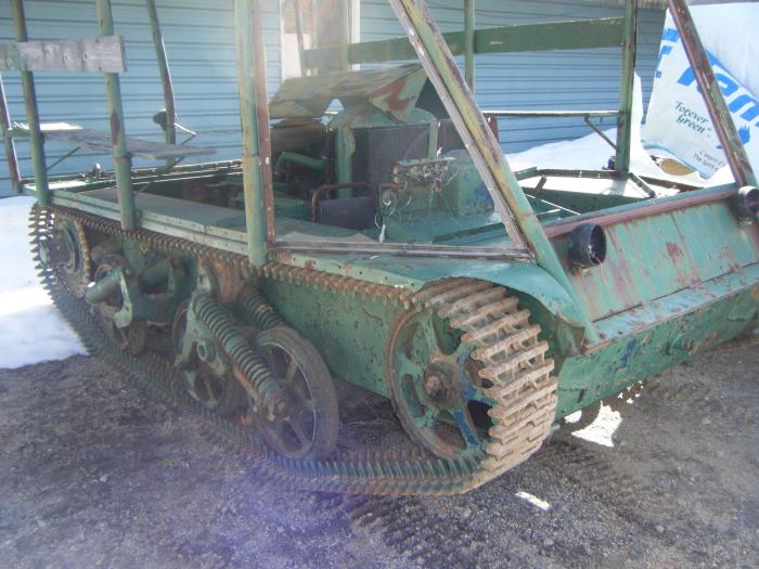

Brought 2 wrecks home today. I will use the armor off one to help complete my MK2. It appears to have hull # 777 and has some features I'm not sure about, a folding piece of armor, a screen on the engine cover, an idler latch of some sort, rubber pads on the side armor, and a piece of tin fastened to the right rear fender. Anyone know what version of carrier this was?
Will post some pictures of the second wreck hull #8293c later. Phil

It is an early standard mk1. You likely won't find the serial numbers in the usual place on the front armor because it would have been on a large data plate bolted over the front right fender. It also would have had the older style air cleaner mounted under the engine cover instead of on the rear armor.
The tin piece on the rear right is to hold the ration box. The ratchet type idler adjusters were a feature of the early carrier. Also notable are the rubber firing rests, which were later replaced by wood when rubber became more dear.

Serial number "777" on the list i have corresponds to a carrier used by the 8th Recce Battalion "CT 42895" Early Mk1 made by Ford Canada contract CDLV73 quantity 783 units. this carrier fitted with F.M 41 F.D. Track type ? if i read the lists correctly
shame there is no track left on it to see if it is the same carrier.

phill the running gear from this would do your mk1 tub number is located on the rearmost gunners side angle bar the one that holds the rear armour in place normally between the first two rivets that hold the angle bar onto the track guard.
