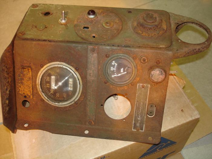

With Phillip asking questions about his Scout carrier instrument panel, i thought I'd put up a few variations, with the idea of helping others, as much as getting some answers, for my self.
First up, a std universal MkI*
