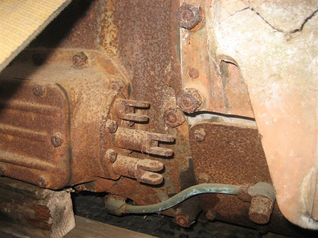

Hi Guys
A friend of mine has found this Gearbox but we are unsure what its out of. Can anybody tell me what its from ??
My guess is that is british and early 40s
Kind regards and many thanks
Matt

It's a Meadows gearbox with Wilson epicyclic steering units as fitted to Covenanter and Crusader.
A few Covenanter bridgelayers reached Australia, so that might be the answer to how it got there. There is one at the Lancers Museum at Parramatta.

Matt McMahon
Location: Oberon NSW
Posts: 180
Thankyou Gentlemen
I was thinking along those lines but wasent sure. Its a pitty that the one at Parrammatta has spent the last 50 years outside as it was very complete.
I would like to give it a new home !
Many thanks
Matt
