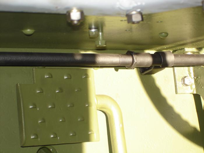

The third image attributed to the British universal carrier is the same (update: not the same, 'similar' only) clutch and brake pedal as found on the early production MK-I* universal carrier. Locally some refer to it as the 'cheese grater' style.

Michael R, here I have an early set of british universal carrier pedals.
The clutch pedal has a pattern not seen very often now and is marked TL2733 and dated 1940. When you say early MkI* cheese grater, Do you mean Canadian, built for British contract? (where Britian supplied various special parts ie electrics etc) and maybe pedal assemblies?

The early MK-I* has a similar pattern, different part number.
Drawing design in FUC-03, and a Canadian contract example on an early MK-I* less than serial number 2083.

I got on my very late british carrier combination of pics 2 and 3. Clutch pedal is as on pic 2, brake as on pic 3.
Hope you will find it interesting.
