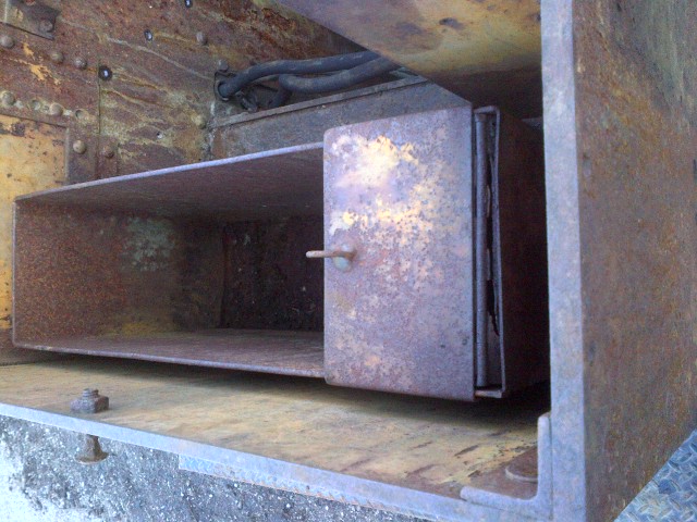

Hello Guys;
My Son and I have started to scrape off some rust and get into the initial clean up process. I want to say thanks to those that gave me the Heads Up where to find the Identification Numbers.
The Numbers stamped into the metal in front of the Driver (For lack of the proper descriptor) were as follows from Left to Right-
CT 115075 S O (or 0) 1942 9503 (Then a 2 and 1 laying over horizontally to the right)
Thats is all I could see after some minir scuffing with a 3M Pad. I will bring some white-out to try and make them more legible.
On the angle iron behind the Gunner's Head was stamped CP 1636.

OK may be silly question, but if I throw out some photos, can anyone tell me or confirm which version this is?
I'm prepared to wear the Duncecap or buy the Beer, I'm leaning towards MK I because of the rear steps have the rubber, not the welded in checker plate etc. However, without the boxes, lights bells and whistles I'm not sure.
I scrounged up some parts etc., including the piece that had the numbers, I just want to make sure they are in line with the Carrier I brought home and not the 'Hull' that had been converted into a trailer.
Thanks for your time and patience.
Jim

Hi James
Is there a chance the WD No. is 113075? I can't make out the 5 very clearly so was wondering if it was a 5 or 3. CT113075 would make it contract CDLV213.
Also the 2 lying to the right is an inspection mark and the 1 is likely to be the tail of the arrow which usually goes with the 2.
Not sure what the S or 0/O is unless the S is a 5 for month of manufacture which usually precedes the date.
Anyway congrats on another carrier saved and great project.
Nigel

Congrats James and Welcome
The numbers you posted need to be re - examined. I will post a copy of my list of UC ID numbers when I get home. You can compare your numbers and it will give you a feel for where yours lies.
The number behind the Gunner/commander is the upper hull number,
it should read: CB XXXX (Canadian Built). "CB 1636" is WAY too low a number, could it be a 7?
I believe the 9503 would be the Serial Number. There should also be a number stamped on the outside rear angle iron of the upper armour. (where it joins the rear fender) This is your Lower Hull number. In a perfect world all 3 numbers would be the same but they will be close. The Serial Number is the upper Hull # + 1000 +/- small amount
In my Case For example
Upper hull number = CB 8075
Lower hull Number = 8105
Serial Number = 9075
Build Date = June 1942
If you have the original motor The serial number there will be of help in
Dating your Carrier.
To Bring out the numbers rub with 0000 steel wool. and spray with WD40. This will polish/lighten the high spots and the WD40 will darken the rust/dust in the numbers and darken them. It will also evaporate incase you want to try again.
