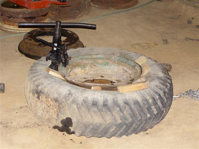

Scott that is simillar to the bead breaker I use, the thread isn't long enough for blitz rims so I have to use blocks for a second push. Vicki bought mine through the local John Deer dealer and it cost over $400 over six years ago. It is also great to use on tractors as I can break the bead with the wheel still on the tractor, saves a lot of heavy lifting.

Nope. Just pulled the 2 half's apart like in the picture, put the wood block on one side, pulled the tube and liner out of the middle, moved the block to the other side and pull the tube and liner all the way out.
Reversing it I put the tube and liner in with the valve stem side first, clamped the valve stem loosely to the outside of its hole, pushed the tube and liner in half way round then remove the block and place it on the other side and finish feeding the tube and liner in the rest of the way.
i put some air in it at this point and move it around to settle it in place then take the block out and lay it all on its side. poke in from the middle with an old broom stick all the way round using the crowbar to lift the sides apart to save my digits. let all the air out and then make sure the half's coming together with a solid "ring" sound, metal to metal no pinched rubber .
Tighten up the red bolts to torque, blow the dirt off and touch up the red paint.
Never break the bead.
