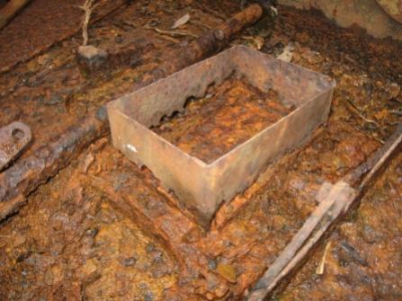

Hi all,
I am after the dimensions for the Vickers MG toolkit bracket that goes on the floor betwenn the seats in the front of a Australian LP2.
I have the rusted remains to go by; however, I do not know how high the skirt should go up around the leather toolkit.
The base is 8"by 4 1/4".
Dimensions and any good pics also appreciated.

I just measured mine and it is 2 3/4" inches from the top of the base to the top edge. This is the outside measurement as there is a lip on the bottom edge of each side that is folded to the inside. Apologies for no photo.

Thanks Peter and Colin for the speedy reply, I can now use what I have and your measurements to make up a bracket assembly for my project.
Hopefully others can utilise this info if they require a bracket.
