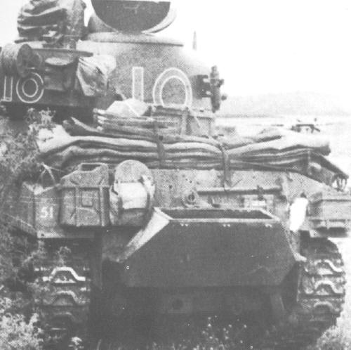

Post Re: Sherman Firefly Deep Wading Gear
Alex;
Picture 1: Sherman Firefly 13th/18th Hussars prior to loading for D-Day
Mark

Guys, here's what I can tell about deep wading kits without having my references at hand.
The British deep wading trunks differed from the US-built ones. These had the scoops on top, whereas the British ones were just plain rectangular open ended ducts. Also, as the different types of Shermans had different engine cooling arrangements, the deep wading kits varied from type to type.
Mark's picture 1 and 2 show the British kit for an M4A4 (Sherman V) with multibank engine. The M4A4 has a liquid-cooled engine which draws in cooling air in through the turret hatch, so only one duct is needed at the rear for the expelled cooling air and exhaust gasses.
Picture 3 shows the US kit for a radial-engined Stuart (M3A1?), whereas picture 4 shows the setup for a radial-engined Sherman (M4 or M4A1). Radial-engined tanks had a separate air intake on the rear hull deck to allow large quantities of air to be drawn into the engine compartment. Like Mark pointed out, the front duct is fitted over this air intake.

Originally Posted by Alex van de Wetering "p.s. The pictures that Mark posted show "Carole", the firefly I want to construct"
Alex;
The two pictures I posted of a Firefly (1 & 2), are of a Firefly of "C" Sqn, 13th/18th Royal Hussars, which you say carried the name 'Carole'. By 1944, after the Regiment was equipped with Shermans, they started using the common system of naming their tanks after the Squadron letter, except on their light tanks. Also, they carried large identification numbers, ussaully on the turrets and for "C" Sqn, the numbers used were 66-80 inclusive.
RHQ and "C" Sqn were the "Wading" components of the Regiment on D-Day, landing at H Hour + 45. On 6 June 1944, the Regiment had on strength only 4x 17pdr Firefly, all of which were in "C" Sqn (1 per Troop/each Troop: 3x 75mm, 1x 17pdr).
In regards to "Wading Gear", all photo references I've seen indicate that the 13th/18th Hussars only used the larger rear duct (dispels exhaust gases), the plain rectangular open ended type, on their "Wading" element Shermans. In no pictures, is there any sign of them using the other (air intake) duct.
Have found one picture of the bottom coupling for the rear duct on a Firefly, after the top portion was removed after landing, its not very clear, but hopefully it helps.
If you want, send me your e-mail address and I'll send you a series of photos I have of the "Wading" elements (RHQ & "C" Sqn) of the 13th/18th Royal Hussars on 6 June.
