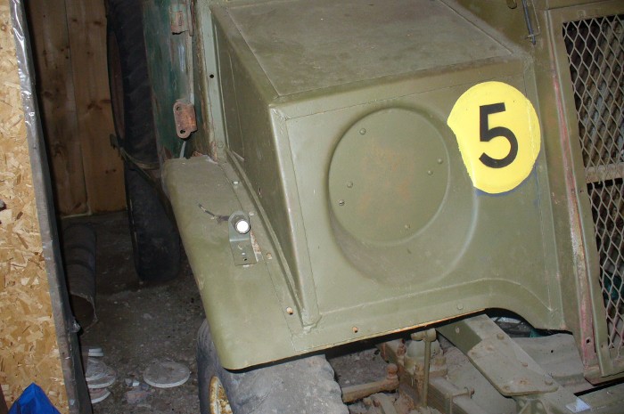

Old 04-09-23, 18:36
Posts: 14,974
Photo of an original bridge plate with dimensions (courtesy of grant Bowker) plus one shown in situ (courtesy of Bruce Parker)
