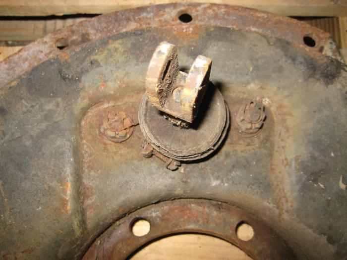

I know this has been posted before but if some one could post a picture of the Mk1 Carrier brake assembly with the Drum off.
i took my brakes apart 2 months ago and need to reconfirm the Assembly.
Jeff

My old thread has some decent pictures of the assemblies. Hopefully it helps you out
http://www.mapleleafup.net/forums/sh...ighlight=Brake

Thanks gang I used Common sense to Put the brakes together today and Judging from the Photos and links .I was dead Wrong. i had them Turned around backwards
Tanks I will reasemble tommorow

Brake assembly showing retracting springs on the shoes, hooked in so the body of the spring is between the web of the shoe and the brake carrier plate. Ref. E-4 of UC-F1.
The half round slots at one end of the shoes mounted on the adjuster plungers.
