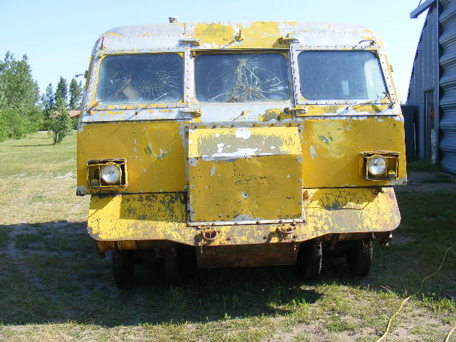

Last year Sean (Snowtractor on this board) offered me the the chance to acquire the mkll Penguin he had recovered from BC a number of years ago. Realizing he had too many projects lined up, along with a young family, he wanted to see something done with it. I also have a fairly long line-up of vehicles, and initially turned him down. But after mulling it over a few weeks I decided I had to have it. Sean only asked for right of first refusal if one day I decided it had to go.
These were converted from mk1 armoured Snowmobiles, although there is very little left armoured on it. After ex Eskimo, it was decided that while the mk1 was about as good an all terrain snowmobile as could be hoped for, it lacked in the creature comfort of a cab. So the snowmobiles ended up being modified either at the end of the war, or just afterwards, by the removal of the armour and the installation of an airplane type aluminum cab. They were renamed the Penguin Mk2. A number of photos on the internet show these as mk3s, including one at the Cdn War Museum, and a photo of one at the Bombardier museum. The true mk3s that I have seen photos of were quite a bit different. I'll post some photos from various DND pubs later today with DND photos of the mk2.
Below are some photos of it as it arrived:

When Sean delivered it last week, he had hoped the mother racoon had come back the night before for her litter. Turns out she had not, but rather she had come back for a trip to Shilo. After being constantly bugged for visits for the next couple of days, including by my ferocious dog, they apparently decided it was time to move on. I spotted a young ball of raccoon run over on the highway nearby, so it looks like they headed west.
Anyway, with the racoons gone, I decided to try and recover any markings that I could find. The vehicle had been painted yellow overall, but the Khaki paint could still be seen in areas where the paint had peeled, as well as the lower suspension. This was an ambulance, so had numerous red crosses on all four sides.
I spotted some brushed on paint towards the rear of the left side, and sanding brought up the DND number: 95-391. There were few enough of these vehicles made that eventually I hope to spot a photo of it in service.
On the front, the remnants of the command shield could be seen. Some careful sanding on the little bit of remaining shield came up with green, so this vehicle had likely belonged to Western Command at some point.
On the other side, I found the unit marking of "18 Coy" over a square of blue over yellow, diagonally divided.
Here are some shots of the finds:

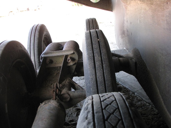

Joe , next time you have your camera out, can a few pics be taken of the running gear ? Would be interesting to see the walking beam shaft size as it is not supported on the outside like the later muskeg.

Here are a couple of pictures of the walking beam shaft, and the tensioner shaft. The walking beam shaft has a round tubing top gusset, and 2 angled side gussets bracing it to the chassis. Not sure if the tensioner runs all the way across, or is 2 stub shafts.
MK3 Brace.jpg MK3 Shaft 1.jpg MK3 Shaft 2.jpg MK3 tensioner.jpg MK3 tensioner 2.jpg

Excellent pics Joe, not to sure how that tensioner works, recognize the spring in a can and tire setup. Mr Bombardier definitely deviated on his later designs(muskeg), from this setup.
