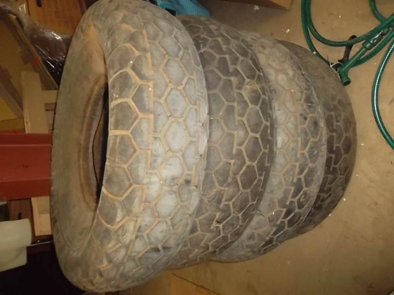

Some knackered 9.00x13 sand tyres on Gumtree at the moment.
http://www.gumtree.com.au/s-ad/toowo...es-/1115463264
