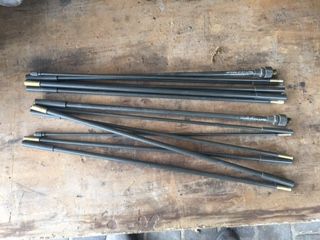

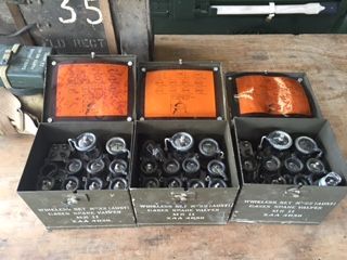

Just got onto this Radio gear through word of mouth in my home town. I am not a radio person but felt that this is to good to let go to the tip so I am now the new owner.
I will upload a series of photos.
