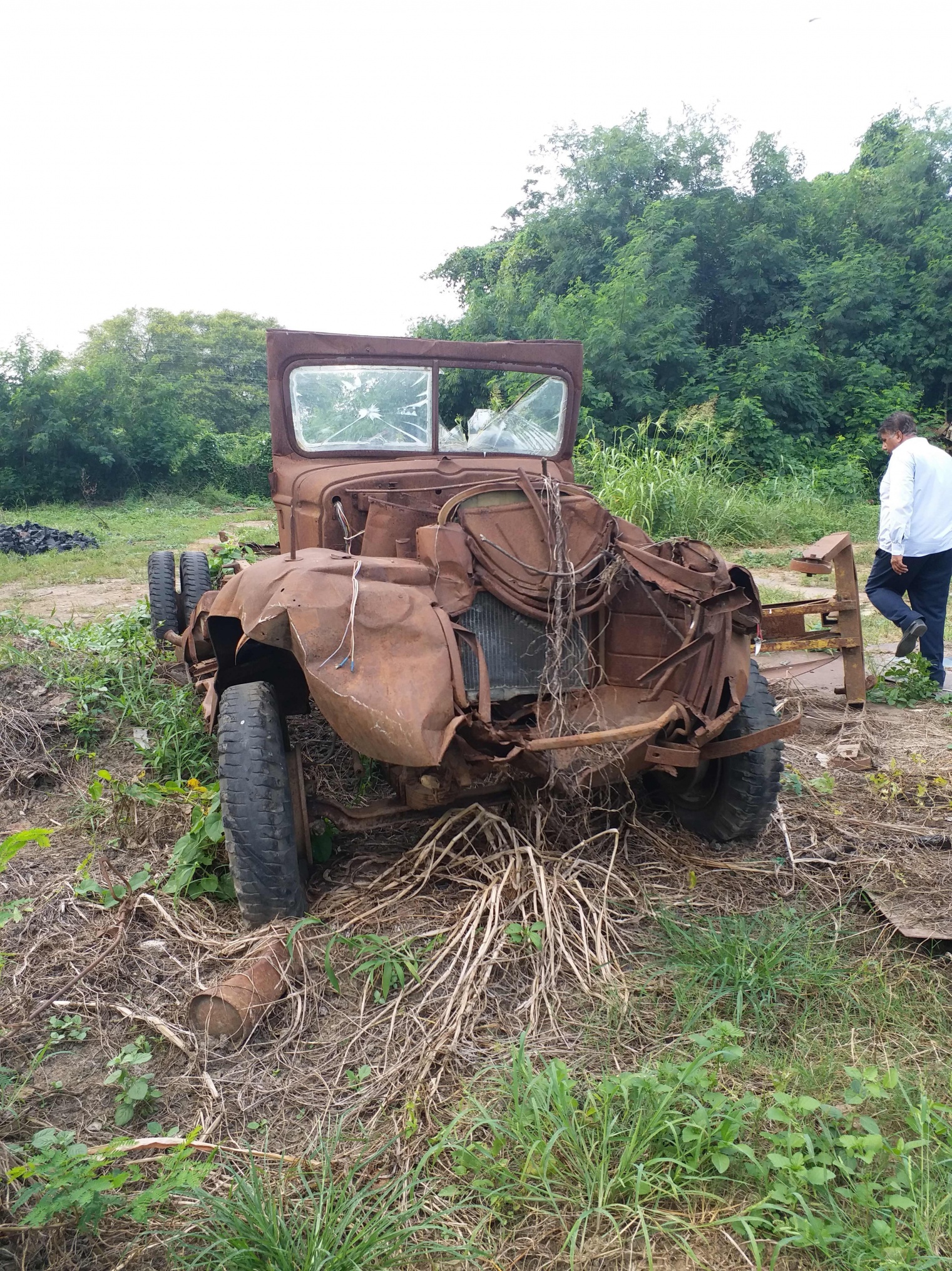

My friend has sent me this truck pics. This Truck was lying in the Army Depot of India somewhere in Rajasthan. I am interested in this but seems truck is in very bad shape can someone identify its year and ton capacity.whether its 1.5 ton or 2 ton.And any more info on this Thank you

It could easily be a 2 ton model... Is the factory tag still present on the cab? I would definitely try to save it from the scrap yard... You can also find casting #'s or part numbers on the front and rear axles that would help you identify the truck...
Old 29-03-20, 00:11
looks like a 3 ton LWB judging by the reinforced chassis rails
Old 29-03-20, 00:16
Posts: 5,268
Default I would wager $5.00 on being at least a 1942....
....but same sheet metal model was built until 1946.......
It appears to be a longer wheel base than 133 in. ????
Also all the Canadian LRDG model were without windshield post or roof pillar and described in the manual as a flat cowl and not curved like the windshield model.
A picture of the data plate or at least measurements of the wheel base would be more accurate.
Examining the centre of the front wheel shows a flat cover over the wheel bearings....... the Timken bearing axles of the LRDG all seem to have the rounded bearing cap cover similar to what is fond on HD Maple Leaf trucks or the C15.
