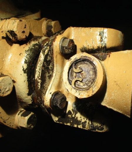

Well fixing the brake adjuster lead to discovering a problem I didn't know the truck had.
While I was degreasing the back of the brake plates decided to degrease the rear axle and the drive shaft. As the dirt came off I noticed something that didn’t look right. The paint on the two of the universal cups was worn away in a nice circular pattern. Grabbed the drive shaft and something moved. Look at the video to see what and how it was moving
https://youtu.be/Yg9xQSyTcNs
After removing the drive shaft to the bench and removing the spring keepers was able to press the two rear caps on drive shaft side out by hand. The caps and bearings look good. It is that the caps no longer seem to fit as press fit anymore. I have a brand new Spicer Universal on the shelf that I will check to see if it's caps are a press fit.
So now to the question how do you tighten up the fit of the caps?

Default I suspect the Loctite 660 is the answer
Hi Jordan
I suspect (or hope) the Loctite 660 will solve the problem. Has anybody in our merry little band used it before, if so with what results?
Now I will be checking the other two trucks for brake adjustment tension springs and now checking each drive shaft.
I don't know if the looseness is a new development, because I have always grab and shaken drive shafts to feel for loosesness when doing a grease job. I always grease the trucks in the spring regardless of how little mileage. Of course the drive line has to have no tension/wind up, or you can't feel play. Often I just put the trucks up on four jack stands to do the spring check up and greasing.
Old 07-09-19, 04:36
My worry would be that the cups rotating in the flanges caused enough wear that even new ones would wobble. In a perfect world the spinning occurs with the needle bearings and not between the cups and the flange.
You have to wonder why this happened in the first place. The least resistance would be the greased needle bearings so why the play outside in the cups?
Old 07-09-19, 08:05
Bruce you might find that war time production was not as perfect as it should have been? Anyhow loctite should solve it,(that's what they made it for) and to free it in the future, heat does it. Short of replacing the flange or yoke, there aren't many other options.

Default Loctite or punch dimples.....
I use loctite on all drivesshaft bolts/nuts after finding loose fasterners near the rear of the tranny on the short shaft......
Not sure Loctite is a long term solution for a free fitting U-joint cup.....some mechanics would just dimple the inside of the cup hole for a short term tight fit
but lets face it 75 years and rushed wartime QC may be just catching up.
I would have a NEW yoke installed/welded in place for total piece of mind ......and inspect all other yokes...... no joke!!!!
Amazing what preventive maintenance can save in time later down the road.
I was surprised one year when I found that 3 of the 16 U bolts nuts, different corners, needed to be tightened ..........
Phil.... if you need parts let me know.
Old 09-09-19, 22:15
With the age of the truck the U/j's may well have been changed a number of times in the last 75 years, and each time the interference fit would get less. You cannot reclaim the holes. As already mentioned, you could get a driveline specialist to change the yokes. I would not use Loctite. What would be interesting would be to see what condition the journals on the spider are like.
regards, Richard
