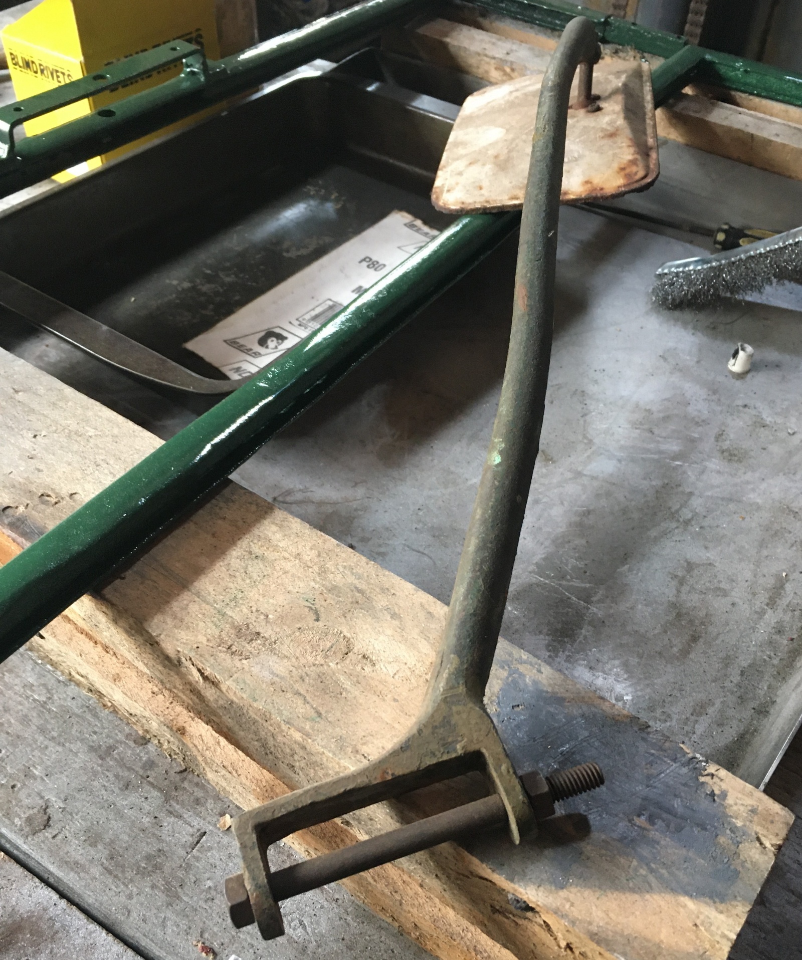

Default Forged arm
Is this the arm?
Old 28-11-20, 03:17
Posts: 6,045
Default Thanks
Thanks but no . The arm I am after is different
