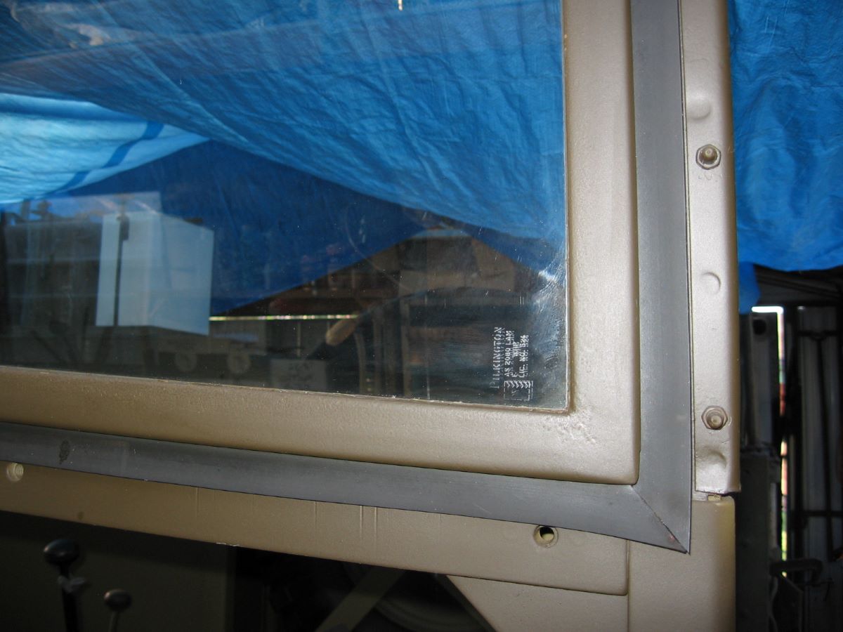

The list shows four strips with parts beginning with*56049-- which I take as the side flaps on the windshield frame. It also shows part no. *C29 81192 B Windshield to Frame- 2 required, which I believe are the two strips above the windshield. I am guessing it is a flat strip with a round tubular end that squishes shut against the windshield frame when closed. They would be the ones with the holes in them to allow the screws to attach the hinge to the cabin windshield frame. I have found remnants of rubber there but never an intact piece.
I have obtained in Australia "T" shaped rubber section from Clark Rubber that has adequately done the job for the flaps around the edge of the frames as shown in the photos.
Hope this is of interest.
