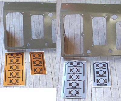

Hi All
Switch Plate Comparisons
Following on from Jordan’s thread regarding his switch plates I would like to conduct a survey on this subject to try and establish which plates went where and when and why. Probably like most CMP variables, e.g. Ford instruments, there may not have been any rhyme or reason other than what was available at the time, but the subject is of interest to me. The following, excluding the font style, are four obvious differences in the two plates.
Brass Plate – 4 mounting holes
Silver Plate – 6 mounting holes
Brass Plate – centre hole – SIDE LAMPS
Silver Plate – centre hole – TAIL & SIDE
Brass Plate – 4th hole – HEAD LAMPS
Silver Plate – 4th hole – TAIL SIDE & HEAD
Brass Plate – vertical edge line unbroken
Silver Plate – vertical edge line broken
I would appreciate if switch plate owners could examine their plates and then address the following;
Are they the original plates? Beware here with the silver plates. They may not be the originals but retro-fitted in the place of brass plates. Close examination needs to be made of the centre mounting holes in the dash to establish whether they were later drilled to accommodate the silver plate.
Chevrolet, Ford or other
When and where manufactured
Vehicle model – e.g. C15, F60S etc. or any other vehicle that contains these styles of switch plates
Cab style – 11, 12 or 13
Brass or silver
Disregard the small hole in the “HEAD LAMPS” position of the brass plate depicted as that’s a retro for some reason.
I would also like to obtain a small readable plate that has the AUTOPULSE provision or be informed of any other plate variation.
Talking of variations, I just read Bruce Parker’s post along with the image of his ’44 Chevrolet plates and noticed that the STOP LAMP ISOLATION location on the large plate accommodates a double pole switch with the OFF position on the left, whereas all the ones I have seen utilise a single pole switch with the OFF position at lower centre. Similarly the IGNITION switch on the smaller plate is a double pole whereas others I have seen are single pole.
I would like samples of both these plates to replicate.

Chev 11 and 12 cabs have plates round each switch, they are oblong with the hole in the middle for the switch. The lettering is a natural nickel colure as has a thin border round the edge of the plate. The background is japanned black. The plate is held in place by the switch
Fords have individual oblong plates set above and below the switch and I think from memory they are an alloy of some kind. Here the plates are held in place I think with very small hammer nails (flute nails) that make removing them in one piece tricky.
Pete

Thanks all for your input to date. Just to focus the research, I am mainly interested in the Cab 13 plates as they are the ones I have replicated.

Hello all - am resurrecting this subject due to my lastest restoration job. When I started this thread I only posted images of the plates. Here I am posting images of the corresponding dashes. The question that hasn't as yet been answered is which plate came first, brass or silver. Logically the brass stamped ones came first and then to cut costs the silver screen print type was introduced. However when the silver plate came in the dash was redesigned to allow for six holes in the silver plate as opposed to four for the large brass plate. The question should also be asked, why do you need six bolts to hold a light plate.
As previously stated this is in response to my latest restoration where a brass, four hole, large plate is fixed to a six hole silver plate dash. Was the silver plate replaced at some time or was the brass plate original fitted due to the supply of the correct plates at the time of manufacture?
Come on you experts, put on your thinking caps.

Could it be that as they introduced a lightweight replacement plate, it was felt that it lacked strength when secured by only 4 points?
