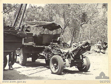

Default Re: 25-pdr Short Mk I (Aust) or "Baby 25-pdr"
The "Baby 25-pdr" was intended for jungle combat and was used in Southeast Asia and the Pacific, during World War II. The gun could be towed by a light vehicle or broken down into sections, capable of pack transport.
From AWM:
ID Number: 083750
Summary: TRINITY BEACH, QLD. 1944-11-27. 2/5 FIELD REGIMENT TROOPS TOW A SHORT 25 POUNDER GUN HOWITZER WITH A NO. 3 GUN TRACTOR TO A DUKW AMPHIBIOUS VEHICLE FITTED WITH AN 'A' FRAME. THE UNIT IS ENGAGED IN EXERCISES WITH 1 COMBINED OPERATIONS SECTION.

This particular gun is mounted on a Carriage, Mk1 whereas the gun pictured by Hanno at the top of this thread is actually on a Carriage, Mk2. The Mk2 featured the fold down legs inboard of the wheels to restrict bounce on firing the lightweight gun at higher angles of barrel evevation, with limited effect.
Do you mean the Carriage 25 Pdr Light Mark 1 (Aust) as opposed to the Carriage 25 pdr Mark 1? (The bog standard 25pdr carriage). If so are you saying that there was a Carriage 25 Pdr Light Mark 2 (Aust) ?
